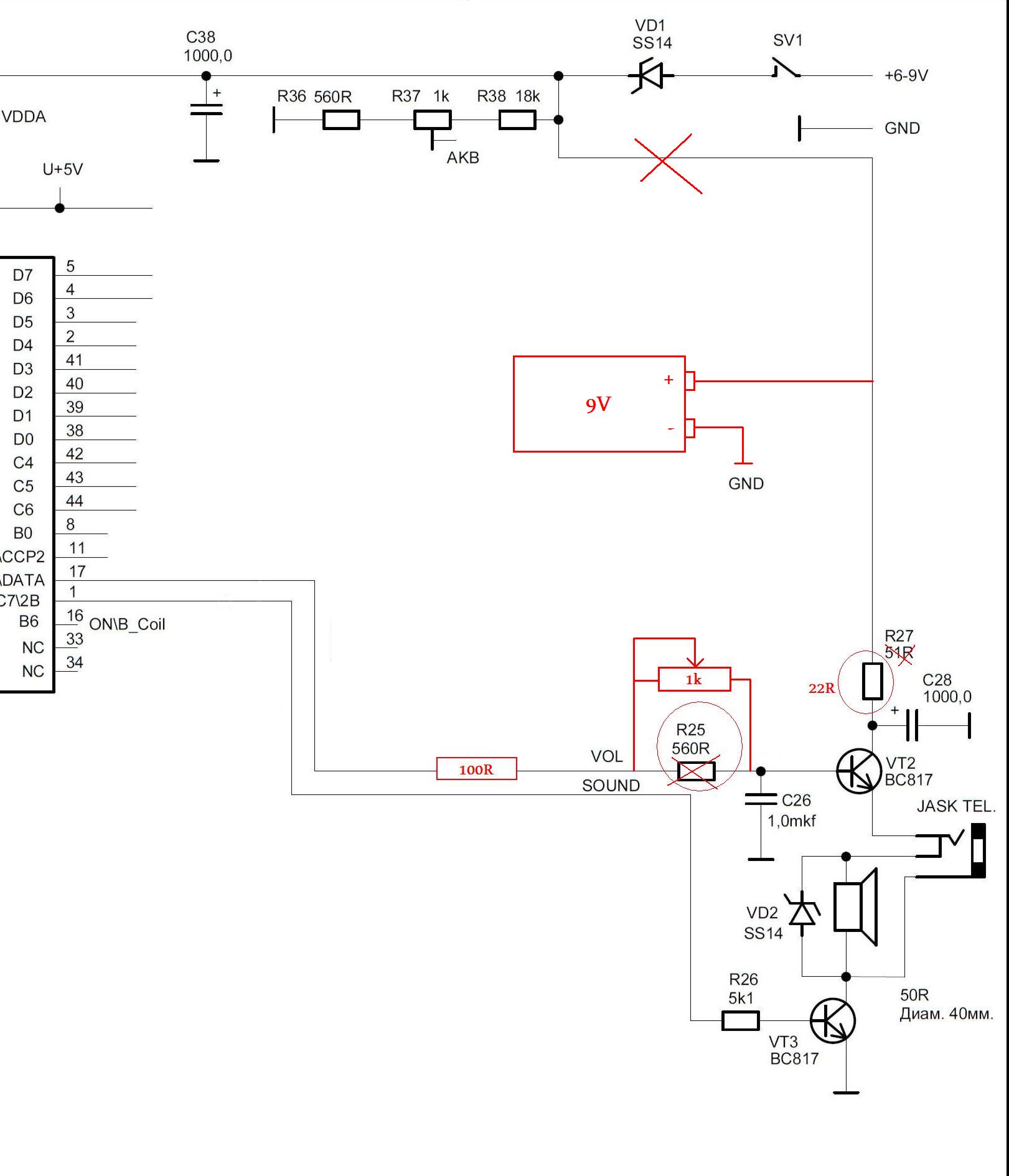

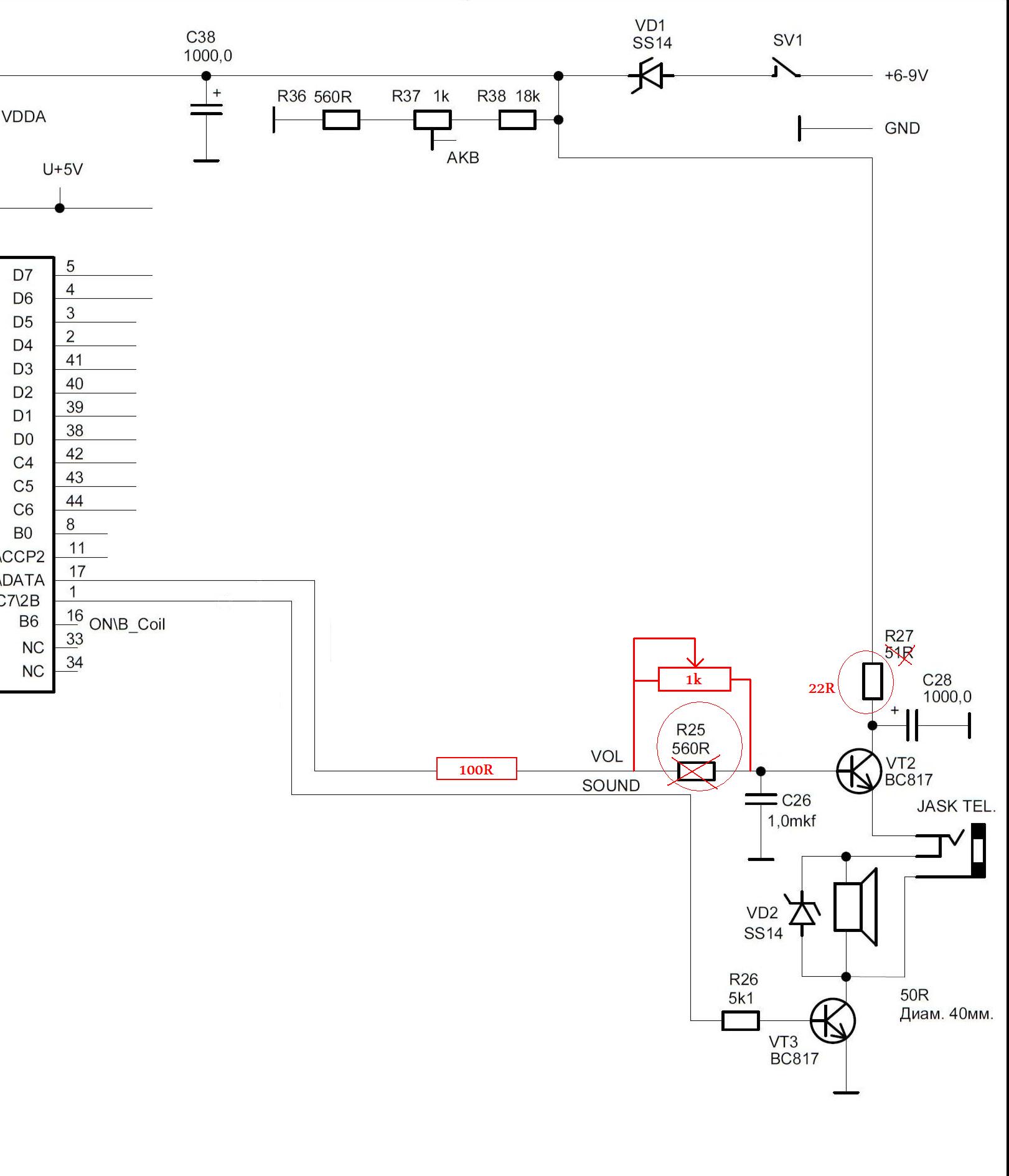

      Who helps me to make amends to increase audio? Original mounts a speaker 50 ohm 1 watt ..... I have tried to put a 8 ohm 3 watt but nothing changes ..... tanks
      • #63
        Rimettere a posto 50 ohm. Con 8 ohm si sta rischiando danni.
        È possibile utilizzare gli auricolari per l'audio più chiaro e più forte?
        Put back 50 ohm speaker. With 8 ohm you are risking damage.
        Can't you use earphones for clearer and stronger audio?
        È possibile ottenere un po 'più forte con questo:
        You can "nick" a bit louder audio with this mod:
        • #64
          Ancora meglio sarebbe se si aggiunge batteria supplementare 9V per l'audio.
          Come questo:
          Even better would be if you add additional 9V battery for audio.
          Like this:

            [ATTACH]37899[/ATTACH]
            hello, really kind ivconic but I'm not very good at electronics, and I'm afraid of doing damage on the electronic board, I should change the resistance of 560 r with the 1k? but they are in SMD resistors on the circuit board? very very tanks
            • #66
              Yes with 1k trimmer (small one, to fit inside enclosure) and than adjust trimmer to level you like. 100R before trimmer is there to limit lower end of range.
              So you will have 100R to 1K1 adjustable range.
              Yes it is SMD, problem! You can find someone to help you, someone who is having proper tools for such job.

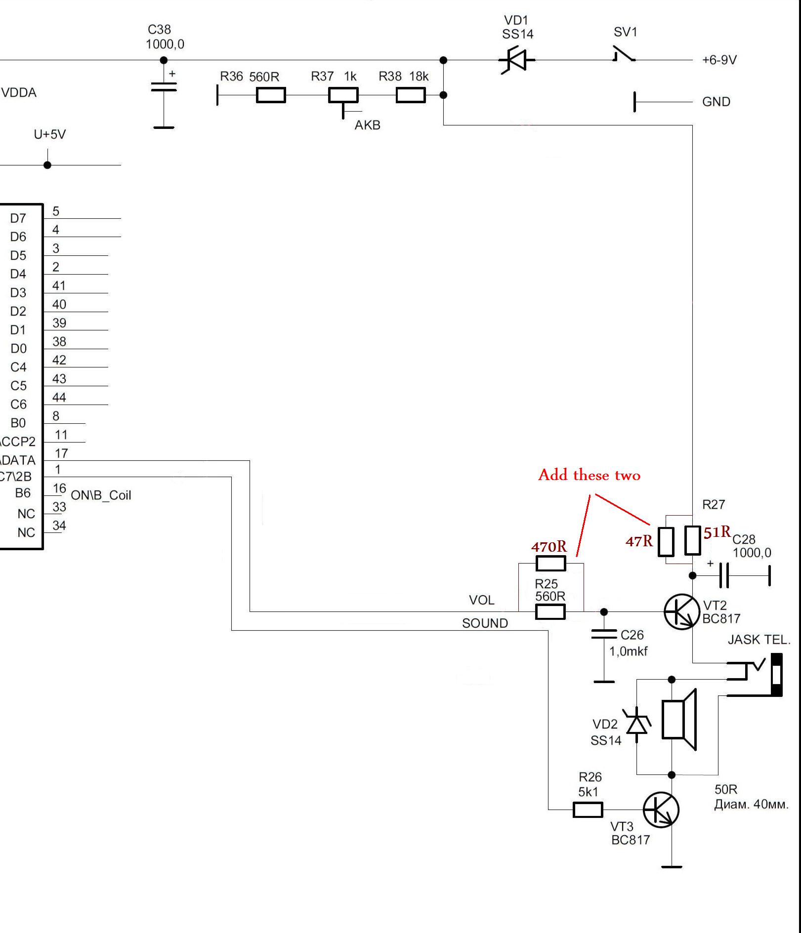

              • #67
                Ok here is much easier solution!
                You don't need to risk anything, just add these:
