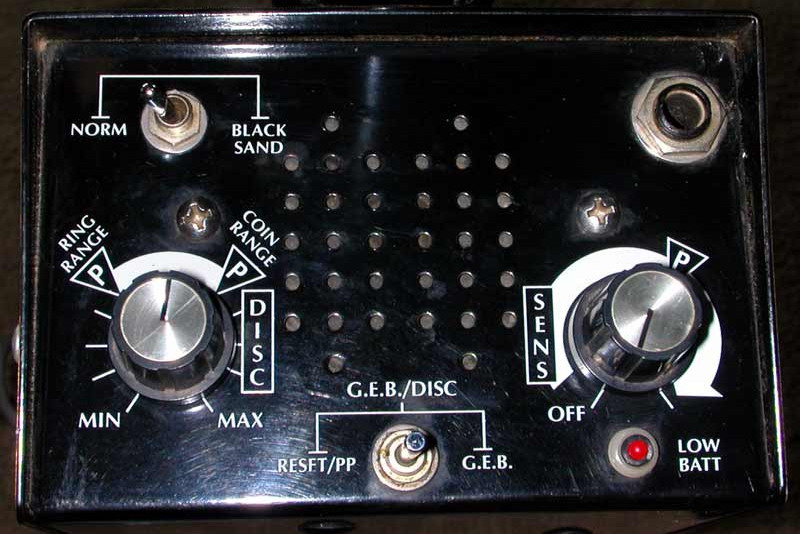

              sorry, not. a realisation of black sands tuning is different. look on the facepanel.
              try seek out this switch in the schematic.

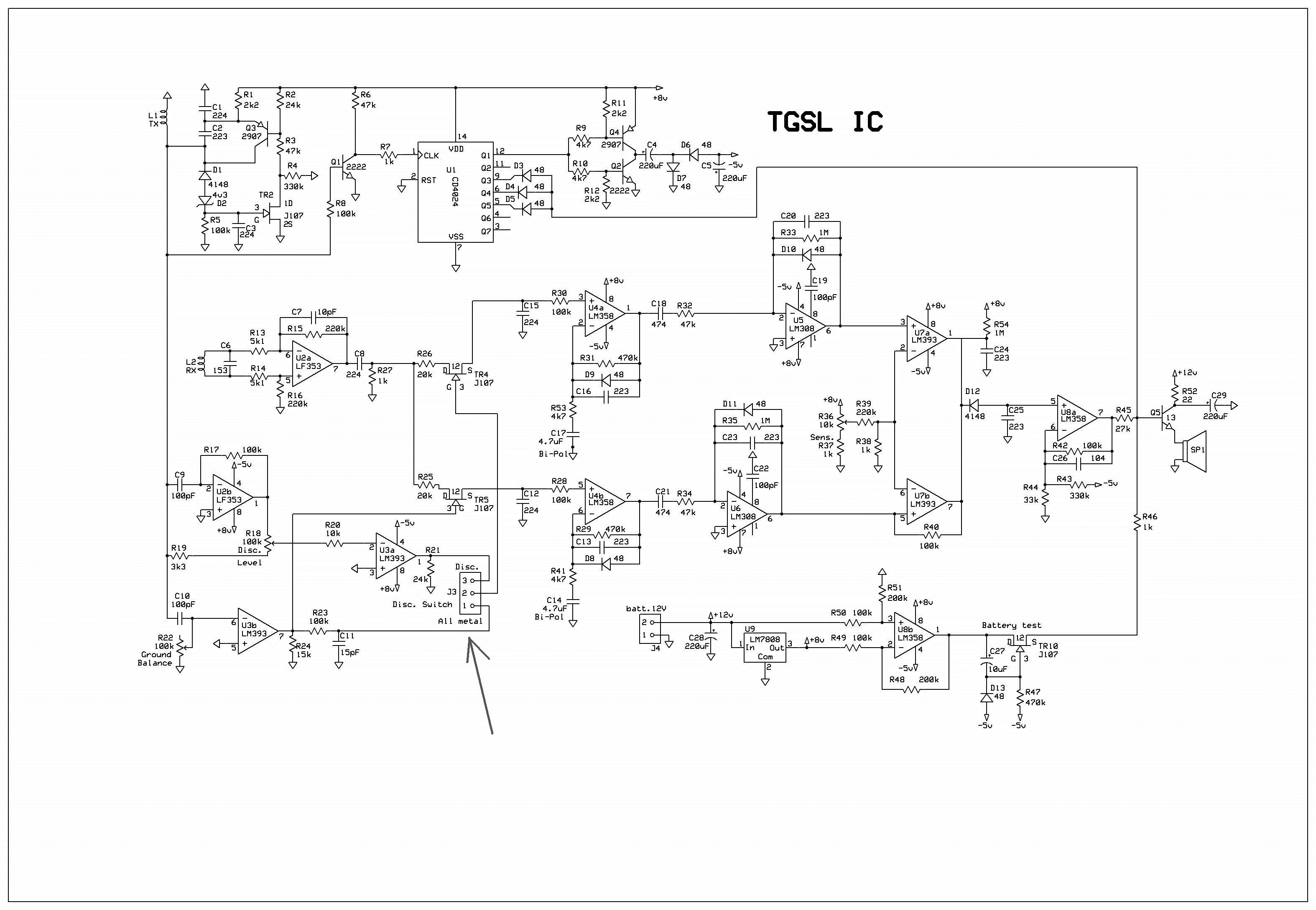

                      one who simplified the original TGS
                      for what? what aim of that if you delete out ALL-METAL mode? i reminder you that right coil balance tuning is possible just in ALL-METAL mode.
                      you just deprive a possibility to right tuning a coil and people get constant problems.
                      and are selling the projects on Ebay
                      sorry amigo, but USSR had dead. yes, it was real socialism system, but why you do not wish to support us and did not
                      build socialism in YOUR country???
                      • #41
                        As usually you don't know what are you talking about.
                        TGSL is having all metal mode.
                        What is this:

                          He never made TGSL. He never saw any in action. Actually he never saw any in alive. And yet he claims that i removed all metal mode from it!?? Despite the fact that my schematic is widely available on many topics here, repeatedly reposted so many times so far.
                          Either he was too lazy to see it ... either he is so illiterate and ignorant to be able to clearly see the all metal mode intact in schematic!
                            What is this:
                            [ATTACH]49021[/ATTACH]
                            what is this. we know this like a some mod for Tesoro Compadre adding some possibility of pinpoint.
