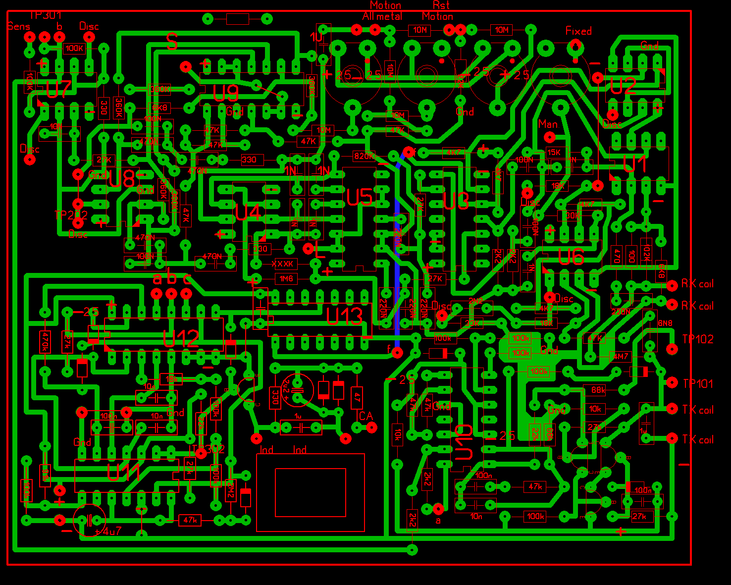

  • Hi guys,
    Here is the "pre-release"
    Still unfinished, power supplies connections are missing but still time to make some modifications, so your critics/comments/questions/errors reports will be welcome .
    As you can see there is only 2 jumpers,power supply connections and decoupling caps can be on the other side or on double side when i have done it.
    Next i´ll put components values.
    Fred

          U13 pin 1 is not connected!
            You are right, it must be connected via wire to pin 5 of U3.
            Also U3 12,13 must go to -
            Fred.

                • New version with components values (easier to check ) and important modifications : 1 pot was missing ( ! ) and some mistake due to wrong interpretation of U9 numbers.
                  Previous layout should be (completely) ignored ...

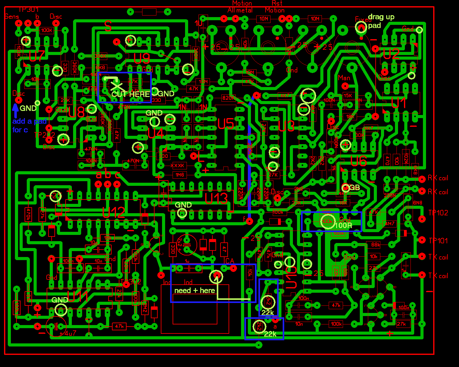

                    Hi Fred,
                    nice work... I'm trying to follow tracks and check if something missed. For now I can say it's really nice stuff and will be easy replicated by folks here I think.
                    Our purpose now is discovering if something wrong or missing... then start real construction phase.
                    PS: just see that U10 supply rails missed, maybe you meant add on top layer later ?

                      Hi Max,
                      Thanks, yes i have now put the +=4 and -=11 of U10.They will go via wire or upper layer too, as all others.
                      There is surely other mistakes,we must find them .The missing parts i found yesterday were the left pot and 3 resistors on "motion-non motion" part, completely independant so i completely missed it .Was a pain to make them fit on PCB.

                        thanks... I like the offer though virtual only... I will pick a bottle of the best and drink it all now... cause I've checked all tracks and so I'm reporting then results:
                        just 5 errors really found, 3 are about resistors values... 2.2K instead of 22K and 100K instead of 100R, so you made incredibly good work on such large schematic.
                        Other 2 errors are more subtle... one is about missing "+" indication at audio stage... I don't know if you forget about or just planned making it on upper side so just did not indicate it on label... anyway I signaled it.
                        The other is about a real mistake on signal path... you can see the "cut here" indication and yellow track for what you need to make there as mod.
                        The stuff in blue rectangles are so errors; all the rest are reminders to remind (if needed) that we need connections for supply rails , gnd on the top side, so they aren't errors and you probably already made top layer.
                        I think I found them all... but better if someone else will recheck it all... maybe I miss something too-
                        Keep doing the good work, Fred! Now cheers!

                          But i think there is something wrong with your correction near U9 where you say "cut" (pin 1).This looks OK as it was to me? I may be wrong i am not at home,and dont have them printed.also GND must be on pin3 of IC9 (not 2)

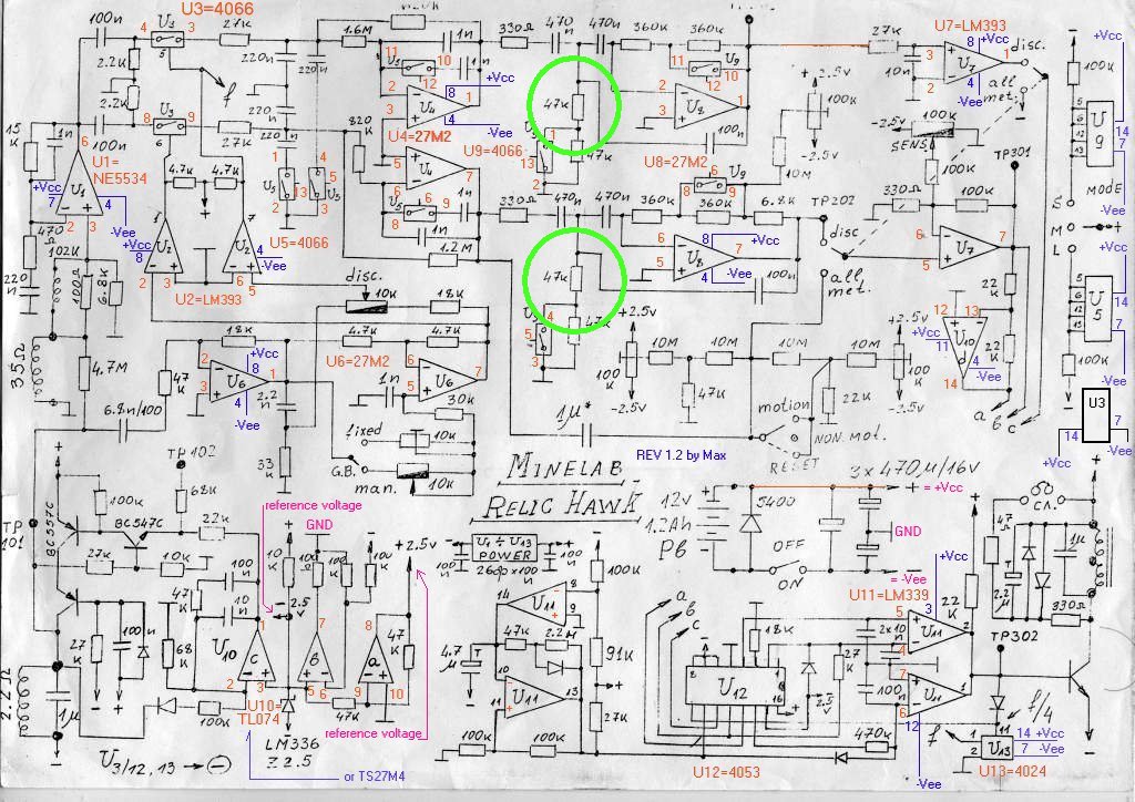

                            the "cut here" label is at a point where the two 47kohm resistors are bound : in schematics those 47kohm are one on the upper signal path, and other on the lower side... I'm going to mark them on schematics to let you find their connections better and spot the difference.
                            As you can see, in schematic the two resistors are bound to pin1 and pin4 of 4066 BUT they came from the two different signal paths, not from same path like in PCB diagram.
                            PS: Fred, another question about 3x470uF + diode at battery side: maybe there isn't enough room for them... what do you think about, can we include in PCB or better leave out ??? I think those 470u are really important on GND so we MUST have them anyway... if needed we can also solder on copper side... but would be maybe a bit ugly stuff!

                            • Hi Max,
                              Yes you are right! ,and pins 2 and 3 must be connected together and go to GND.
                              I think i can find a way to place the 470uF caps and diode below U7, rated at 16V they are not so big.Really it would look better.There is already enought wires for switches etc .
                              Also here is revealed a secret "mistake" : i have swapped connections 1/2 and 3/4 of U5, because it was easier for me.
                              BTW, i could not read value of uppermost resistor (pin 1 of U4, gain setting), maybe 820k?
                              Regards!

                                Hi Fred,
                                not it isn't : you used pin2 and pin3 for GND as in schematic... but you can swap them cause are bidirectional gates! I see... you drink too the irish whiskey with lot of enjoyment... about pin2 and pin3 of U5 they are at GND already; for U9 pin2 and 3, are too at GND (but remember to use also there the top layer for pin3), but I will prefer there direct connection at pins and one track only that goes to GND line.
                                Yes, I see it too that resistor there... it's unreadable value! Dang value it's out of bound... maybe it's something 820K but I'm not sure about.
                                We can make some educated guess looking at pictures of similar units... but it's tricky procedure.
