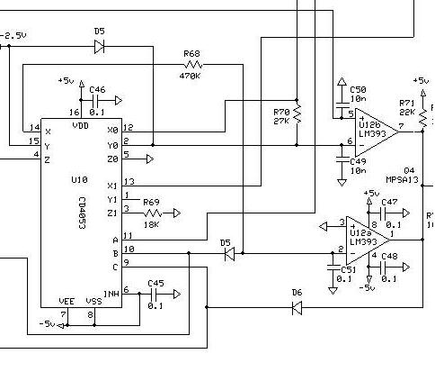

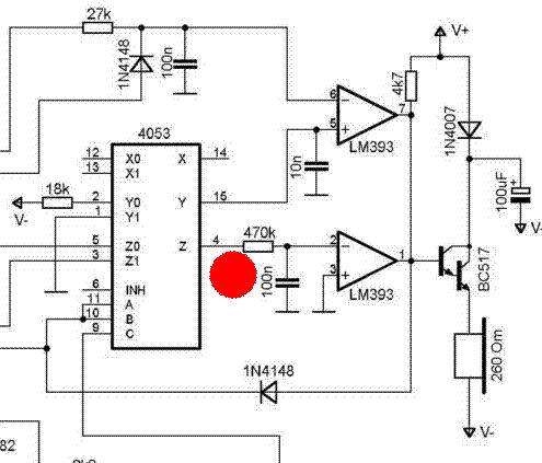

              • Too slow?
                If I understand your problem correctly the RC network at the comparator input may be the problem. You could try reducing either component by a factor of 2, 5, 10, who knows. Lets say 5. Change either R to 100k or change C to 20n.
                Here's something better: the diode should be connected to the RC junction instead of the comparator output?
                • Yes,
                  You get it right.
                  But you are using realy wrong schematic.
                  You should use last posted here.
                  And on this its R68 470K if I understood you right.But I cant see this capacitator.
                  Now its more stable.
                  Still a lot of work before field test.
                  • Porkluvr.
                    You should look this one.
                    As you can see there are diferances.

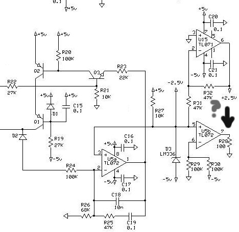

                    • space heater
                      Here's something I don't understand. It looks like all that U5B does is output -2.5V and then draw 25mA through R28.
                      WHY?? What possible useful function does this perform?
                      Ummh, besides being a 62.5mW space heater?
                      Maybe it is supposed to stabilize ground. If so then it seems to me like an inefficient way to do so. You won't find me copying that scheme. It's wierd. WIERD. (Arrgh.)
                      • Ask Max, it is redrawn from schematic he posted a while ago.
                        • Ivconic,
                          I'm not meaning to throw stones at you, Max, or anybody, and I don't want to wear on your patience. It takes a lot of time and effort to RE one of these things and I'm grateful to all who do so. I'm not intending to belittle anybody's effort.
                          If it's a mistake, then it probably won't hurt to remove the resistor and possibly save some battery juice. If it's for real, then maybe somebody will divulge its purpose.
                          I saw it and wanted to point it out for what it's worth, because it's confusing (to me) and MAY be a mistake, but I don't know. I'm not well educated and there are all kinds of tricks that I would never think of that some folks have up their sleeve!

                              You could possibly remove R28 and save battery power, but only MAX or somebody with RH could know it there is an error. Do you see 2.5V at the top of R28?
                              One problem at a time.
                              • Do you see 2.5V at the top of R28?
                                Nope 4,95!
