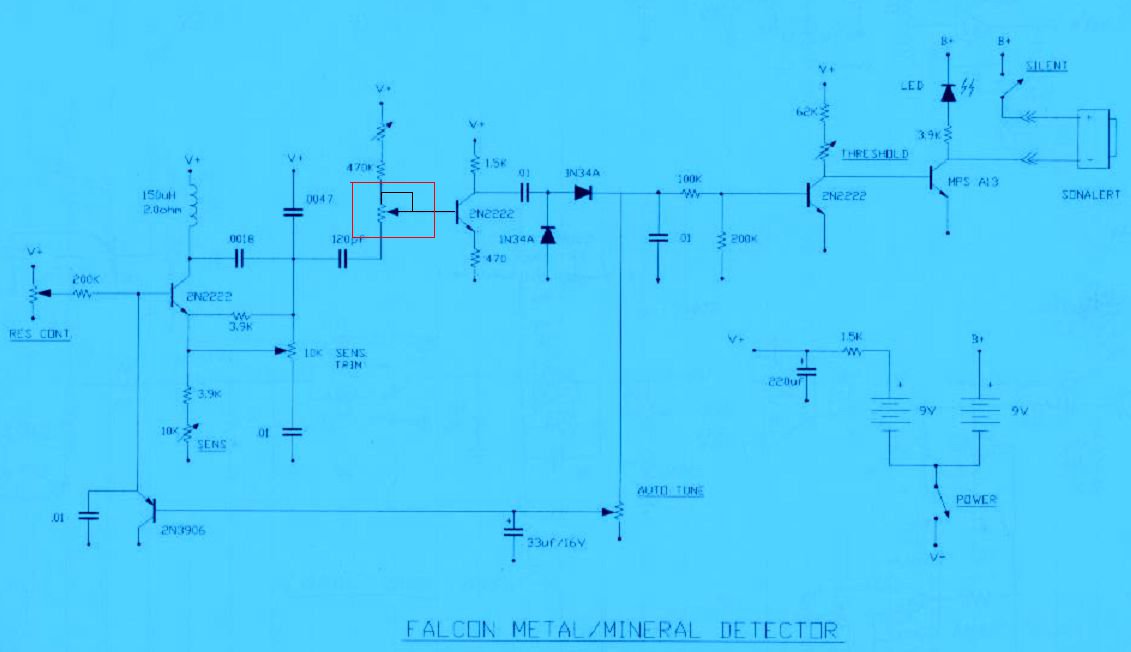

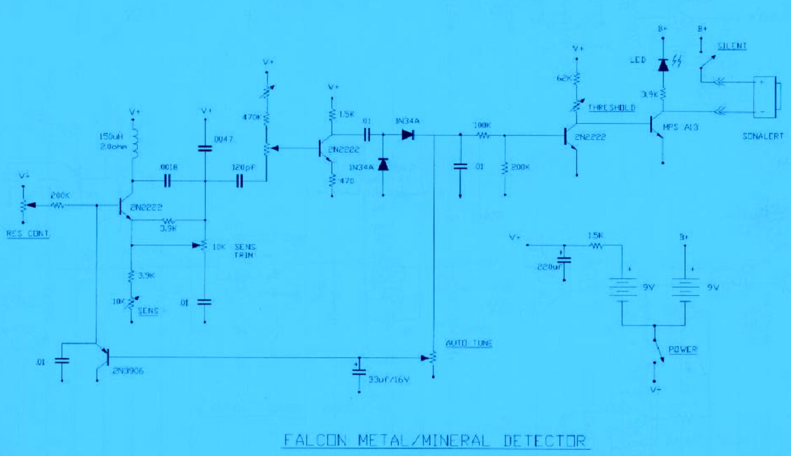

        • Altra, were are in luck! This schematic matches up perfectly with your MD8. There are just a couple of errors on the schematic which can be rectified by reference to the PCB of the working device.
            Great. That is my schematic which I posted a while back. One mistake for sure is the led is reversed.
            On the pcb pdf I posted yestarday the TX and shield are reversed, you probably caught that. Tx goes to the collector of Q1
              All that remains is to remove the trimmers ONE AT A TIME, and to measure the set resistances. Seeing that there are no setup procedures for this thing, It would be important to know approximately where those trimmers are set, otherwise someone could end up tinkering relentlessly with this little circuit, like a previous comment of the dog chasing its tail.

                      Splendid, Now having gotten that out of the way, I wish to point out that on the schematic, one leg of the trimmer should be connected to its wiper, as shown in the attachment, highlighted in the red box. When all corrections have been made, then a final schematic can be drawn.

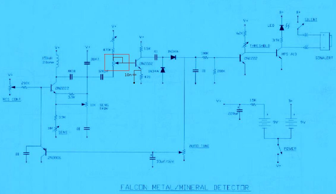

                      • Moving right along, I found another error, this time a 10n bypass capacitor omitted from the schematic but is on the actual pcb. I have now included it on the schematic. Right near the red box, on the emitter of the transistor, there is where it should be.

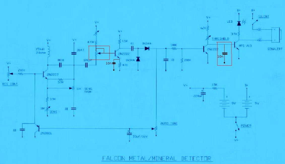

                        • Yet another correction, this time a 10n ceramic capacitor just before the MPSA13, omitted from the schematic. I've now included it. Highlighted again in a red box. I'm going through the circuit step by step, to illustrate just how easy it can be to just have a tiny error or a missing component, and the circuit is kaputz.

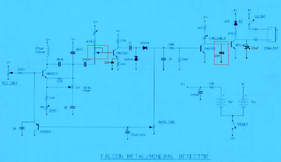

                          • And finally, a 10uF electrolytic capacitor from collector of MPSA13 to ground. Missing on the schematic, I have added it in.
                            Well that looks to be it. Now I can redraw the schematic to include all the changes.
                            • Altra, please check the orientation of your MPS5172(shown as 2N3906 on schematic). Please verify that the emitter shown on your drawing is indeed the emitter, as the schematic shows the emitter and collector swapped. This is the only thing remaining to be checked before I can finalize the schematic.
                              • I agree on all of your corrections. The big mistake was the 3906, and yes reverse the emitter collector for the mps5172. Also the led needs reversed. Get a rough schematic and I can fill in the pot values and cw/ccw connections. Most of the trim pots are set near mid-point.
