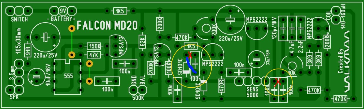

    All of the board layouts by Dom, Friiman and Walkman seem to have some minor errors which were fairly easily corrected. I posted a correction to Dom’s board a couple of posts back, Friiman’s needs a track cut between the top pins of C7 and C6 , as does Walkman’s which also needs some alteration to the diode and capacitor circuit connected to the collector of transistor 3 ( I will try to post a pic soon). Also, all of the 100n capacitors should be swapped for 10n to match the earlier circuits published (although 100n may work) 1N4148 diodes work fine even though they are Si.

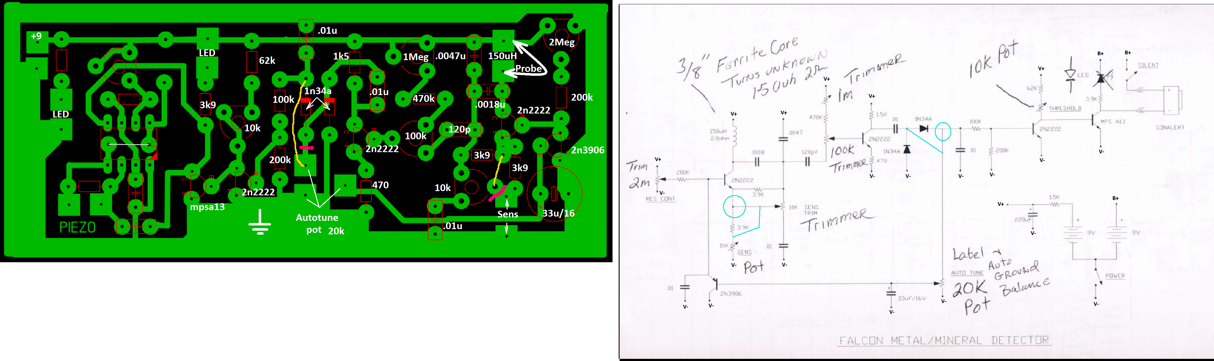

      • Originally posted by Goaty View Post
        Friiman’s needs a track cut between the top pins of C7 and C6 , as does Walkman’s which also needs some alteration to the diode and capacitor circuit connected to the collector of transistor 3 .
        Cut tracks at X and add jumper.

                        • Originally posted by homefire View Post
                          Yes, I would appreciate a copy as well. Which version is this one ?
                          I am hoping it is this one -
Name:	Old and new fixed.png
                          I have marked the fixes required (Yellow - links, red - cut tracks) but will need re-checking.
                          There don't seem to be any component values around the 555 audio section but these could be gleened from other circuits in this topic.
                          This one has a LED indicator which is quite useful when tuning the front end.
                          It would appear that the original MD20 board had extra trimpots which were later replaced with fixed resistors - all adding to the confusion around which version to build!

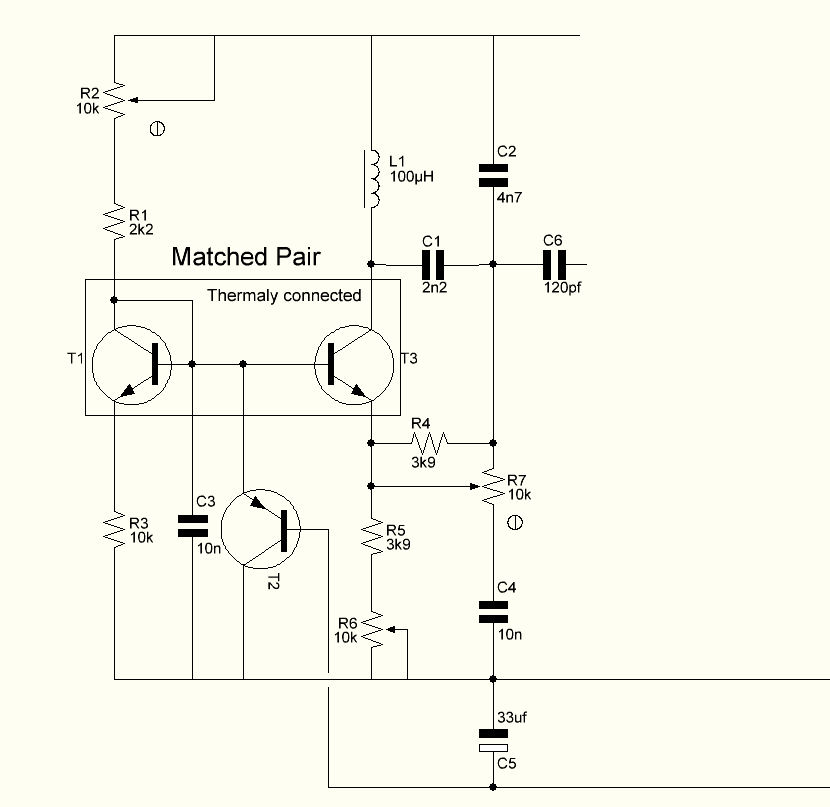

                          • I thought i would play around with the circuit a bit more been to busy with other things lately, just built this test circuit to improve the oscillator using current mirrors to give thermal stability to the circuit, so far looks good built a test circuit works as expected. any suggestion would be appreciated.
Name:	temp stable osc.jpg
                            • have been running the circuit on and off quite a while, mine is locked at 277.7khz with 60 turns on a 50mm fer-rite rod, and is very amplitude sensitive to metal objects.
