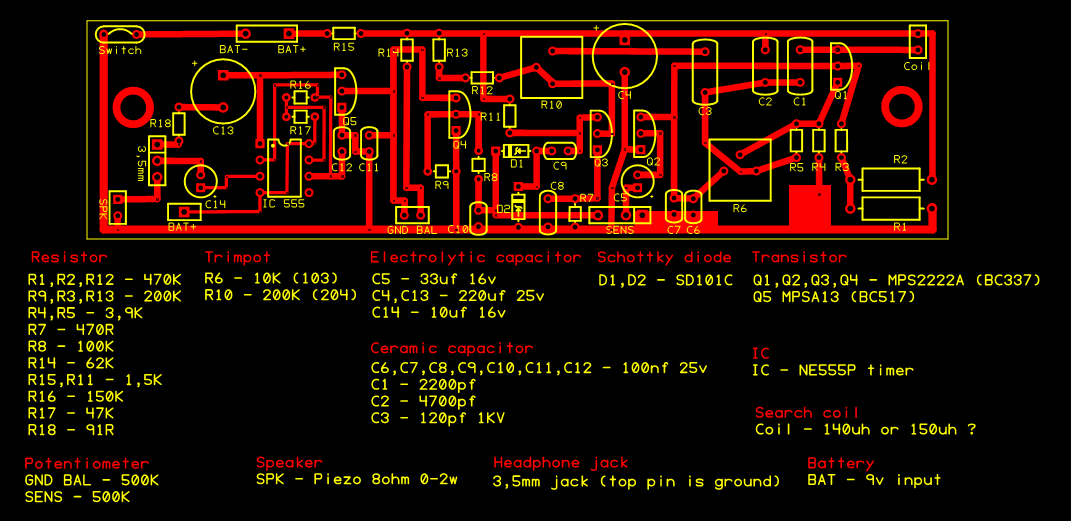

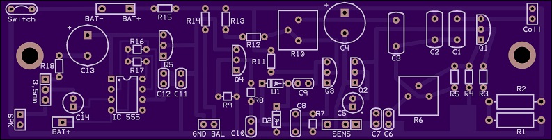

            • #81
              Finally I found people making this pcb. I thought I was the only one until I found this forum.
              i made a pcb and etched it myself and now I ordered it from oshpark.com but I have one last issue regarding the coil.

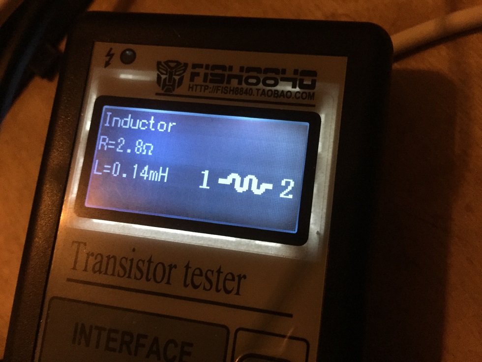

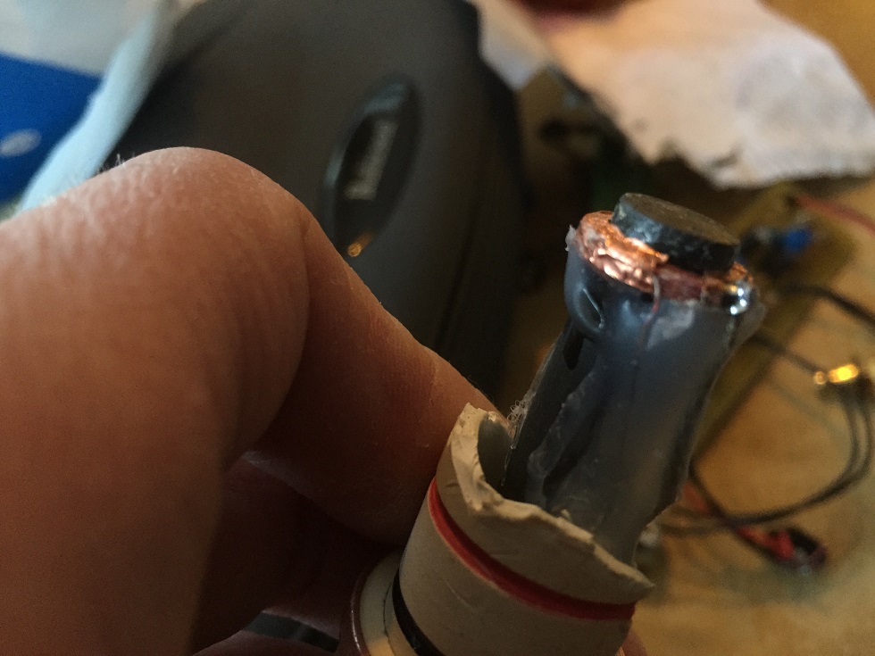

              Havent ripped it all out. But I can see that it's a ferrite core 50mm long and have a tiny coil at the end measured it at 140uh 2,8ohm. But my meter can be off and it can be like previous posts saying its 150uh 2ohm. For any who's interested in the component values I can post them. I got the ne555p timer version.

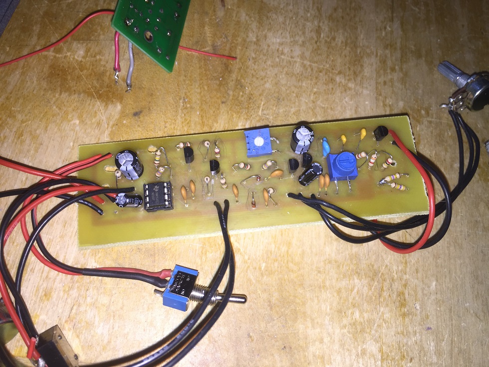

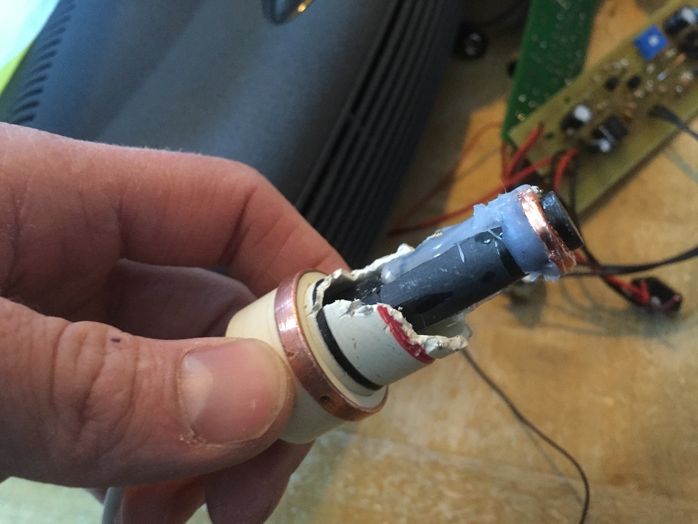

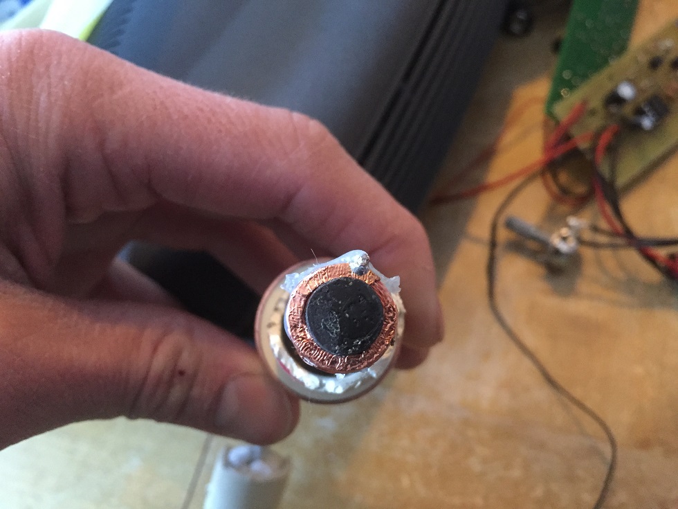

                  • #84
                    Can post them here in a bit.. Going to try posting some pictures of it to but im new to posting, i only read threads, so this is my first ever =)
                    Do you have any clue with the coil? i can see its dimention and all by ripping the pvs pipe open but i dont want to wind it up just yet i want to figure it out how many turns etc before i might destroy it.. its really tiny coil, about 2mm in each direction.. posting those image to later.. Sorry for some miss spelling and such. English aint my first language =)

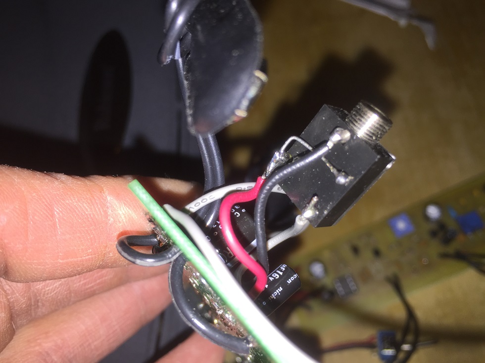

                      • #86
Name:	coil inductance.jpg
                        • #87
                          Does anyone know how many turns o wire and size etc? would help alot thanks =)
                          Hope you can manage to figure out my remake of the board
                          • #88
                            how much is diameter of ferrite rod and lenth? good home work, thanks.
                            • #89
                              I used a digital slide guage and it showed this
                              diameter is 9,7mm
                              length is 50mm
                              and the coil show about 2,3mm thick and about the same in height
                              • #90
                                can you measure the wire diameter?
