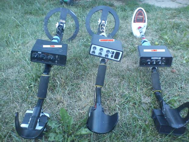

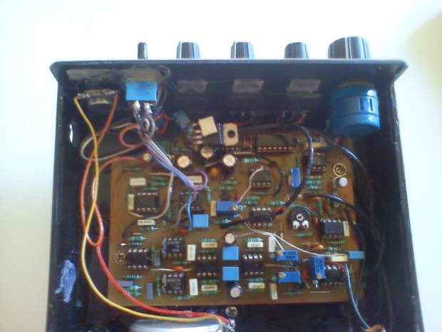

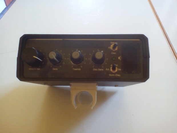

                  • Ground Balance
                    Hi for everybody!
                    I write from Hungary.
                    II built it LOBO
                    LOBO works.
                    I cannot portray it correctly Ground balence.
                    Somebody can prepare a short video the correct one tuning.
                    Thank you

                      • Ground Balance
                        Hello everyone!
                        Excuse me!
                        Then now the pictures.
