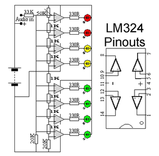

        another note
        there is no good gradual change in volume so cannot estimate if signal is week or strong
        trying to use audio VCO circuit
        or voltage level indicator such as analogue voltage meter or led voltage indicator with LM324

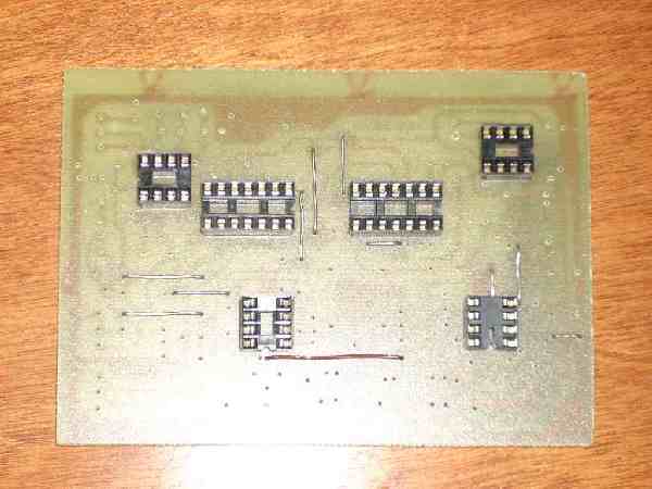

          Have downloaded files titled SurfXX posted by Apberg. Found here http://www.geotech1.com/forums/showt...516#post149516 I Etched board but some of the components are questionable, to me. Could you kindly post a
          partslist?

              • I am going to build Surf XX.
                Part list is not available... I must collect from schematics
                Bought aluminium crutch for shaft, housing for electronics, t-shirt transfer paper for etching, pertinax...
                parts are waiting for final list.
                Aluminium shaft or part of it... can it be a problem for detection?

                  • I am trying to make a list for Surf XX ...
                    parts are not matching PCB and schematics
                    C2 is 2200nF on PCB and 1000uF on schematics (+12 V and ground) ... bigger is better ?
                    R2 on PCB is 5k and schematics says 3.3k
                    Here is list of parts for Surf XX:

                    If I made a mistake please correct me...
                    • Sdesic,
                      It looks like R2 can be either a 5k trimmer or 3.3k resistor. I elected to use a 5k trimmer. What are you using for C2? 1000uf?
                      For C8 I have 47nf instead of uf.
                      On Apberg's board there's a resistor that appears to be a 1 watt. Just above LT1115 (NE5534). It's also on the placement drawing marked "12R" ?
                      By the way, thanks for your input.
                      • I didn't start building yet, I am still collecting parts, so I looked at this schematics...
                        From that picture of assembled board ApBerg used fixed resistor 3k3
                        And C2 is 3900 uF at his photo... page 4 in this thread
                        ***** C8 is 47 nF ***** it is my mistake ****
                        • There is also C19 100pF
                          • Large cap 3900uF was 1000uF, for NE 5534 now LT1115.
                            Ok, thanks I missed that. So it appears now if you use NE5534 = 1000uf cap.
                            If you use LT1115 = 3900uf cap.
                            Yes, I see Apberg used a fixed resistor 3k3. But the etched board has place for trimmer. I was reading in the Surf PI (older version) where they used a trimmer and I have one allready. Has to do with adjusting the coil.
                            So you think the resistor marked 12r is 150 ohms? I had that on my bom. I was going to use a 1 watt.
                            I've etched my board and installed ic sockets and jumpers. Some of the parts I have here allready.

                              • I don't know why is that resistor changed, I will use what ever is on paper... don't want any new changes...
                                This PI has already 4 different potentiometers, don't need more adjusting, I will use basic coil.
                                which one is this ?
