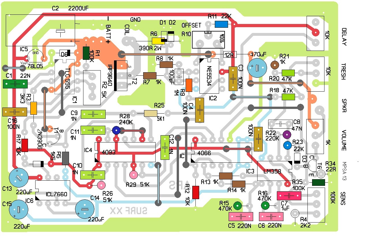

    • Read through all the pages of this thread first. It might take you a while but it's highly recommended. There are simply too many different potential errors, and false diagnoses. As far as I remember - take care of proper IC's (prefixes and suffixes do matter); transistor pinouts may differ depending on type you have; be sure you have connected the coil; all the way to checking for eventual overdone etching, or poorly cleaned (isopropanol) and dried PCB before use.

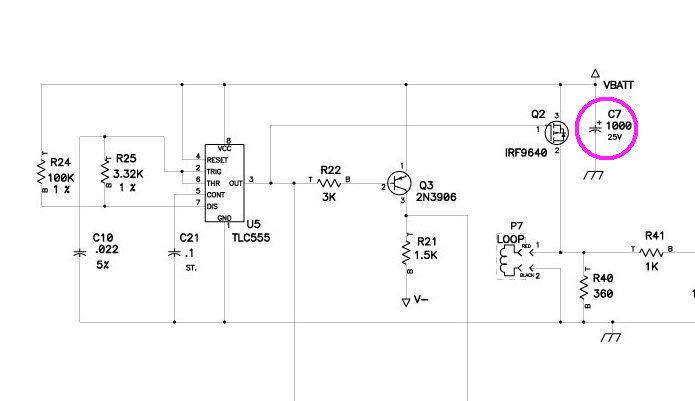

        You were talking about C7, did you not mean this C7?
        It looks like a 1000uF/25V electrolytic, to me, but then I never stuck it out and stayed in engineering school for four years... so what would I know?

          • Here is the Surf PI Pro schematic that Carl posted earlier (reduced to 50% and converted to pdf). I would like to call attention to note #3 (bottom right, next to the title block):
            "CAPACITOR VALUES ARE IN MICROFARADS"
            (that would make C7 to be 1000uF)
            I hope we're talking about the same C7.

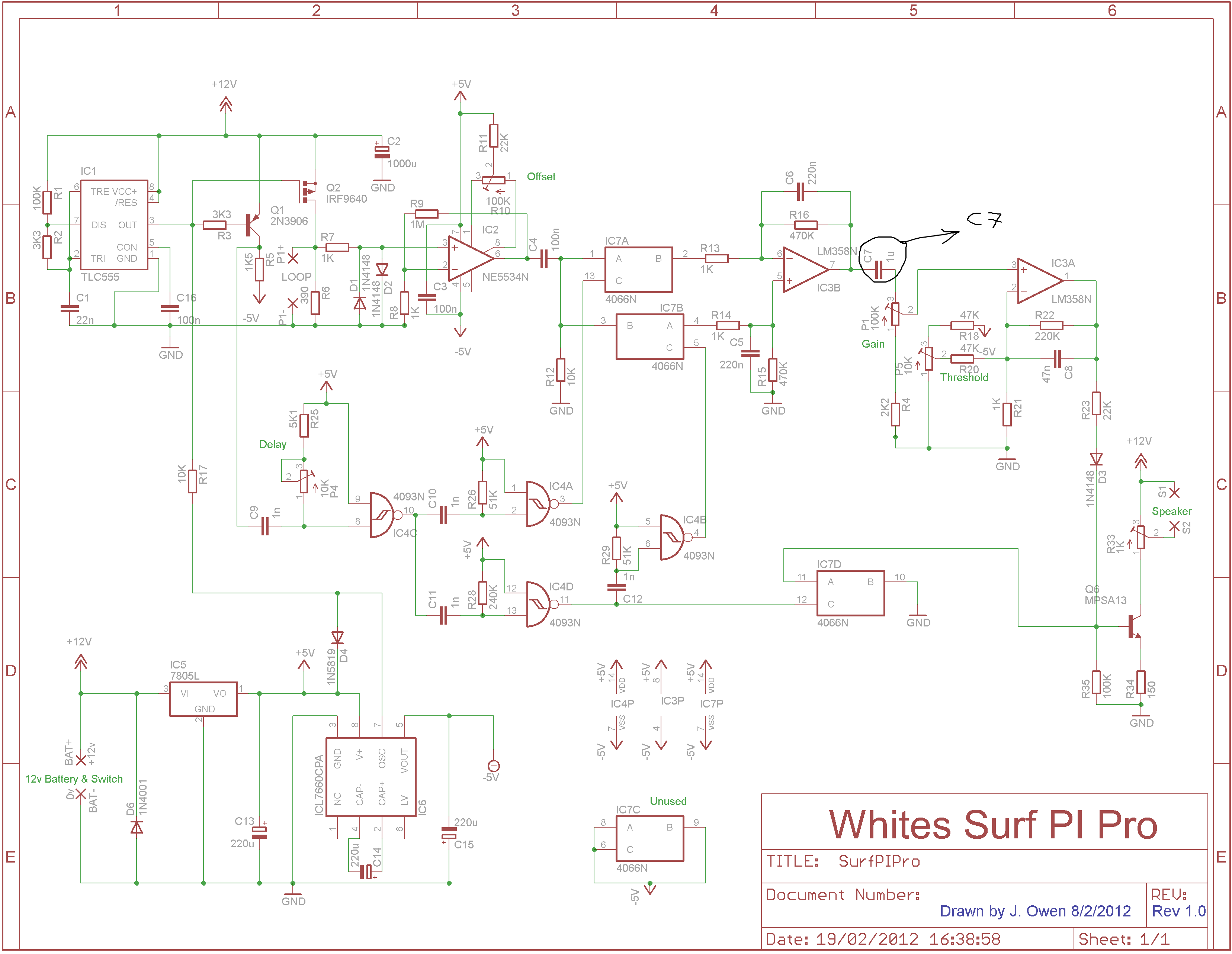

              no bro this is old schematic here is the new one

              • please someone confirm me this image to be right
                does anyone worked with this !!!

                • Can't say for sure if your Image is Correct, But that C7 on your schematic is Basically Correct.
                  In the ORIGIONAL Surf Schematic Posted by Carl, it shows it a 1uF Electrolytic.
                  Problem is: There are NOW so Many PCB Variations and Different Schematics for the Surf, It is difficult to know Which Schematic belongs to Which PCB?
