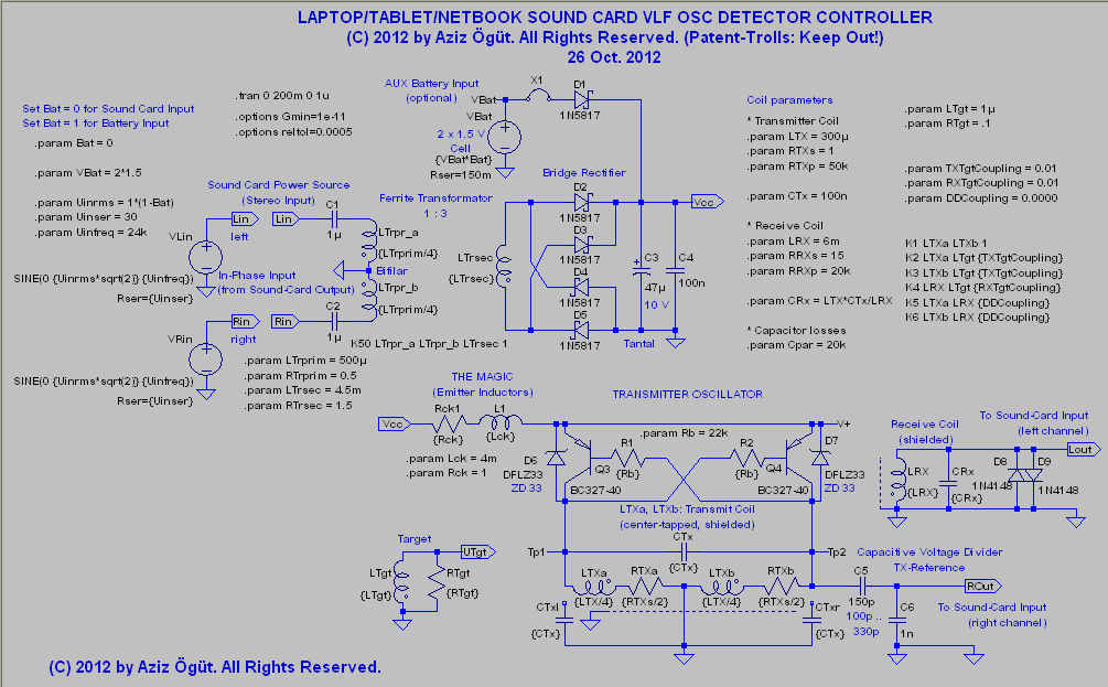

            • Good morning again guys,
              (was very late last night *LOL*)
              I want to mention, that the crucial point and all of the merit of the whole circuit is in the magic emitter inductor(s). And I haven't seen any LC oscillator having an feedback like the emitter inductor. The transistors base current is a half sine current (owed to the fact of emitter inductor PS: ... oops, b.s. detected! no, the cross-coupled voltage is a half sine anyway but the supply voltage over the oscillator is a half sine, which is owed to the fact of using emitter inductor) and the whole current injection into the resonant LC circuit is some kind of frequency locked current injection.
              Are emitter inductors a "don't do"-rule in electronics? If yes, oooops sorry!
              *LOL*
              Cheers,
              Aziz
              PS: added, b.s. killed

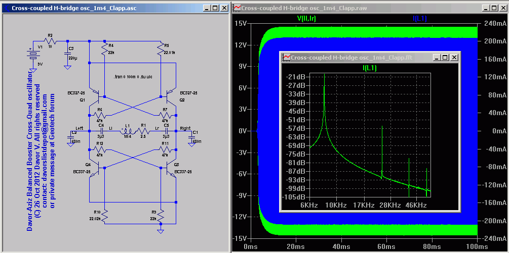

                I played just a little bit with now famous cross-quad oscillator and came up to something beautiful. I combined my initial design with Aziz' and mixed in some Clapp-style tricks, and voilà - a booster cross-quad configuration. I also dropped the emitter resistors for simplicity that resulted in somewhat higher 3rd harmonic, but let it be ... for now.
                So what you see is an oscillator that will use my existing beloved FKK coil with Musketeer specs for IGSL, working at precisely where it is supposed to oscillate, at 60% more voltage and current than it is supposed to provide, without Aziz' chokes. Vcc bound of course.
                There is a caveat though. The oscillator won't start if the series capacitors are not at least 4 times larger than the lateral ones, and I guess it is highly advisable to use foil capacitors as series ones, which may turn a bit spacious.
                Whoever cares to do so may rejuvenate the existing rig using the existing coil (provided it is not nailed on one side to the ground ) with the balanced oscillator, and as a bonus gets 60% more coil current for free
                Enjoy, a Cross-Quad Clapp-style booster oscillator:

                  • Must see my new VLF oscillator detector controller.
                    BTW, you can play with the spice file if you like.
                    SingleFrequencyOsc-VLF-passive-pnp-03.zip
                    Cheers,
                    Aziz

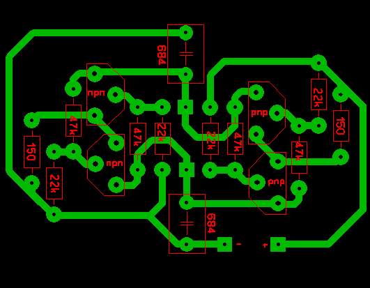

                      • At least i did draw pcb...
                          I=U/(wL)
                          • Of course
                            One must adopt marketing ways of expressing ideas in nowadays economy. The funniest part - I'm not selling anything!
                              Nice work ivconic. You use Davor's solution.
                              Can you post black-white slide too? And schematic (if) you draw. Seems R2 is missing in your PCB?

                                Hi Ivconic,
                                ok, I have provided the hardware part for the nice toy.
                                Who is going to make the DSP software part now?
                                This "comic" is a brilliant simple and powerful detector platform to implement the whole VLF detector technology in software. It looks really very simple ... (but can knock out a lot of VLF detectors *LOL*).
