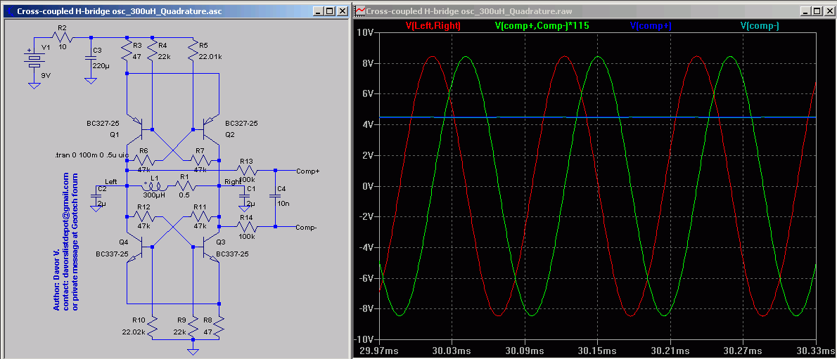

            How about this one, it has a pretty accurate phase, but not amplitude ... which is not a problem for supplying a comparator:
              Well, not in my case. I knew what I was after, and a balanced Tx is a result. You can't say component tweaking is trial and error, because there are no errors to begin with. You could calculate everything, but even there you'd have to start from some assumptions and build your calculation from there.
              I'd say this is a nice platform to make standalone detectors as well. Having Tx voltage in abundance and in perfect counter phase begs for a simple and reliable no-brains I-Q phasing network. That would make it complete.

              Nice, really very nice to have the balanced quadrature clock signals (after a comparator stage) for demodulating the RX like a true I/Q lock-in amplifier.

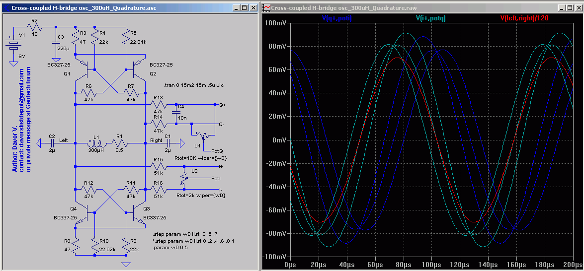

                • A small step forward, a Tx with phases manipulation for GEB and Disc. With these values any comparator would have some negligible offset error, so this is just about it. See how both Disc and GEB are shifted left and right from the ideal I and Q phases by rotating the pots left or right from the centre? That's the beauty of it - it makes the most logical phases control I can think of right now. Red trace is a "normalised" Tx signal for reference, blue traces are GEB, and grey traces are Disc.
                  Boy! I love this oscillator.

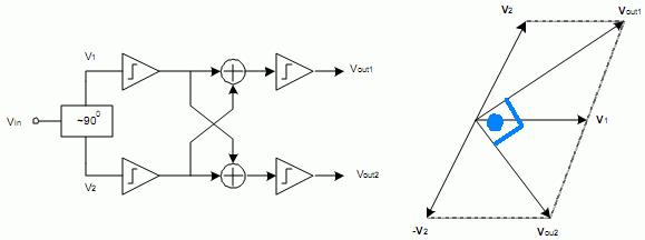

                        E.g. an obvious application of this source would be applying the Haven's technique to obtain perfect quadrature (where needed), as per the attached picture. From left to right you have a semi-quadrature source, a pair of limiters that are not needed if the amplitude is kept reasonably equal (see picture). It is followed with a pair of summing and limiting devices that are safely replaced by comparators - summing and limiting action happen at zero crossing. You may observe v1 as I+ on my schematic above, and v2, -v2 as Q+ and Q-. So all you need are two comparators hooked (Q+, I+) and (Q-, I+), and voilà, perfect quadrature is on their outputs. Same as vout1 and vout2 below.

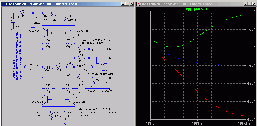

                        • I've plotted the GEB control voltage phase V(Q+,PotI) against the I+ phase V(I+), and here is the result ... derived in spice as phase of V(q+,poti)/V(i+). Blue trace is the Q+ phase by itself (PotI at 50%). I'd say it is very nice for a circuit of this level of complexity.

                            • Yeah, I know, the Haven's principle is just for the academic point of view.
                              As shown in the post #128 both GEB and Disc phases can be set independently, and the beauty of doing it this way is that no active phase shifters are needed, the setting is linear within reason, and can work nicely in a large frequency span.
                              So my future VLF rig will have very few components on the board

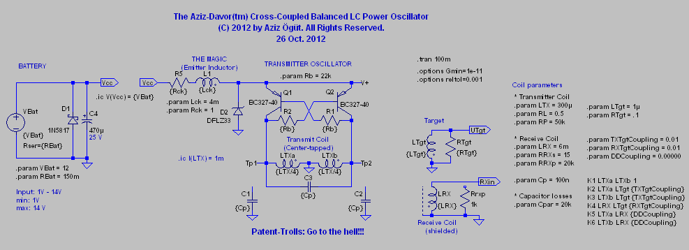

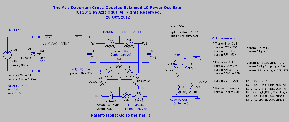

                                Hello friends,
                                you will find my new kiss-masterpiece. *LOL* (I like to exaggerate, it is probably invented already, but in case it isn't, it is now. )
                                You will find two different solutions. Either Vcc or GND referenced. Use whatever you prefer.
                                Notice, there are only two transistors required (cool switching = low loss, low power). And one magic emitter inductor.
                                The TX coil is a center-tapped coil. This oscillator is ultra high efficient and gives ultimate bang to the targets. It works even at lowest voltages. You can increase the supply voltage, if you use high voltage rated transistors.
                                Enjoy.
