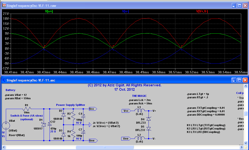

                1. Half sine wave supply voltages V+ and V- and the differential voltage (V+) - (V-) of the oscillator.
                Note: Supply voltage is going almost to zero! Look at the differential voltage! Nice. Nice oscillator having zero voltage supply phase. And having a maximum voltage supply phase. *LOL*
                Here is the magic buried.

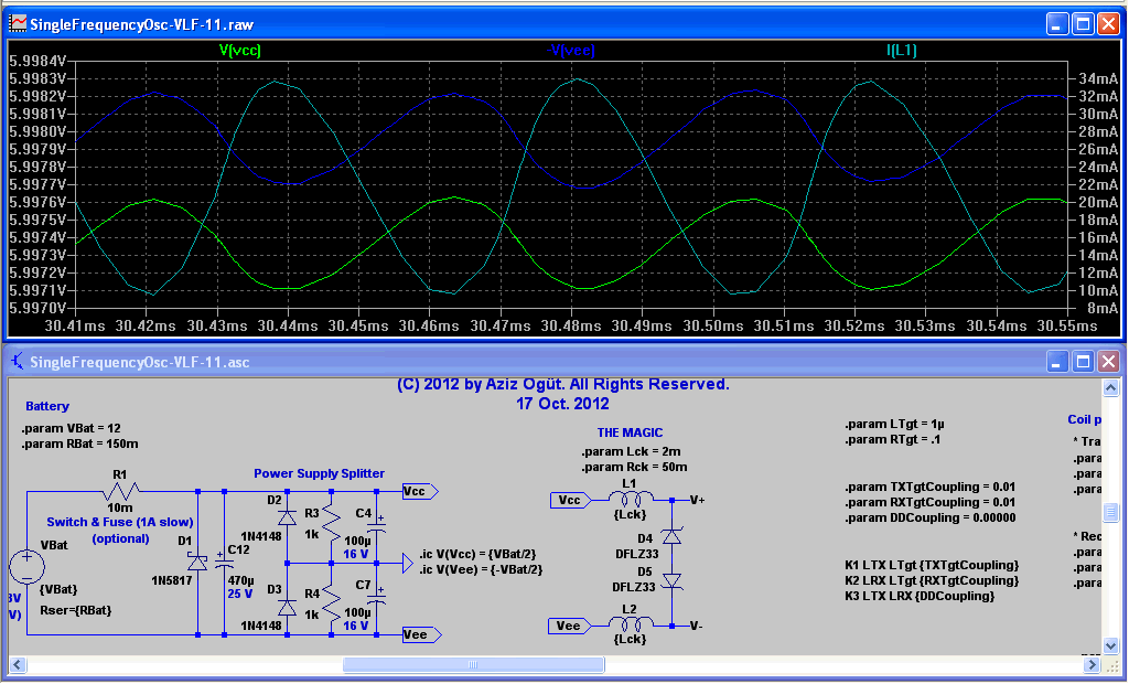

                2. Inductor current and the ripple feedback voltage from the oscillator to Vcc and Vee (note, Vee is inverted)
                The ripple voltage is approx. 0.5 mVpp. The inductor "injection'" current: Average DC current = 22 mA and oscillating AC current = 24 mApp.
                Comeon, let's do more magic things to the circuit.

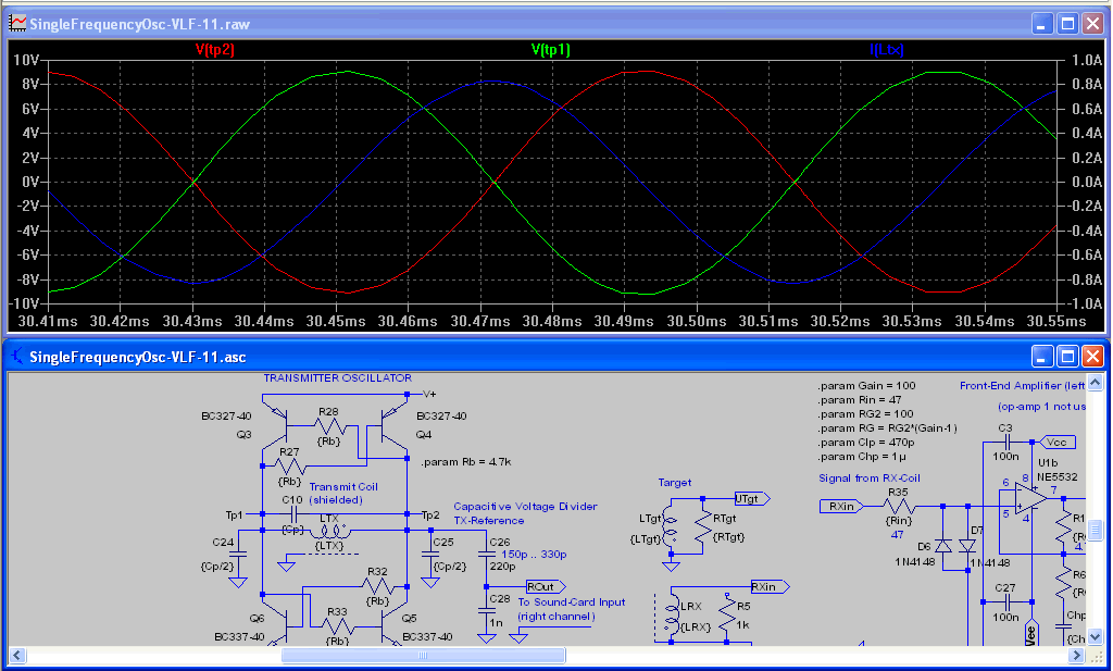

                • #83
                  3. And here is the oscillator coil current and voltages:
                  Not bad.
                  Aziz

                    One of the very important fact is, that V+ and V- should be half sine wave.
                    Don't smooth V+ and V- with capacitors. They have to be half sine waves and not DC voltages.
                    If you put some smoothing elco's to V+ to V- and V+ to GND and V- to GND look at the power consumption rise and at the transistors temperature or power consumption (they could even smoke).
                    Again:
                    (That would be a magic killer.)
                    Cheers,
                    Aziz

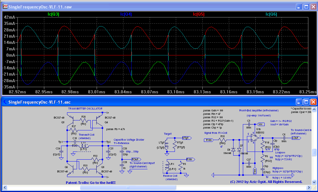

                          Forgot the collector currents. Sorry, but I have lost the previous time base. Anyway.
                          4. Collector currents of the transistors (base/emitter current isn't important at the moment)
                          Aziz
