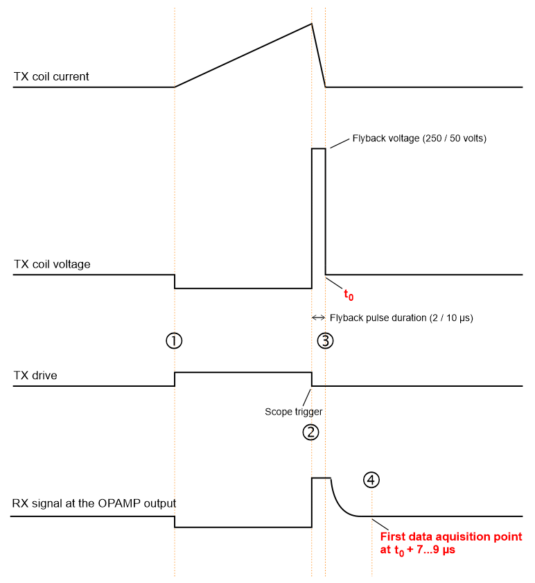

                  • Hi Aziz,
                    I thought the description in my previous post was clear enough Below is a timing diagram with 4 time marks (1) … (4).
                    The scope is triggered by the falling edge (2) of the microcontroller TX drive pin. There is a delay of maybe 100 ns (driver, MOSFET as you said), but this is negligible.
                    With the scope timebase set to 1 µs / div, I measure the time between trigger (2) and the end of the flyback pulse (3) directly at the TX coil. The end of the flyback pulse is t=0 (t0). The error should be quite small, maybe +/- 0.25 µs. Any delay in the driver and MOSFET would not be added.
                    Then I look at the RX signal at the OPAMP output (i.e. after 200x amplification) and select (4) as the earliest possible acquisition point, i.e. the RX signal should be almost zero without any ringing or over/undershoot. The time difference (4) – (3) is the first time code for the first acquired sample, i.e. 7 to 9 µs for the latest measurements I made.
                    The scope is then set to 20 µs/div and the trigger position is moved off screen by exactly the sum of the two measured times, i.e. flyback pulse duration plus necessary delay for the first acquisition. This time is displayed by the scope as trigger position delay, so it is accurate. Now (4) is exactly at the left side of the scope screen, and this will be the first acquired sample.
                    Finally, the air signal is stored and subtracted from the acquisition channel.
                    Thomas

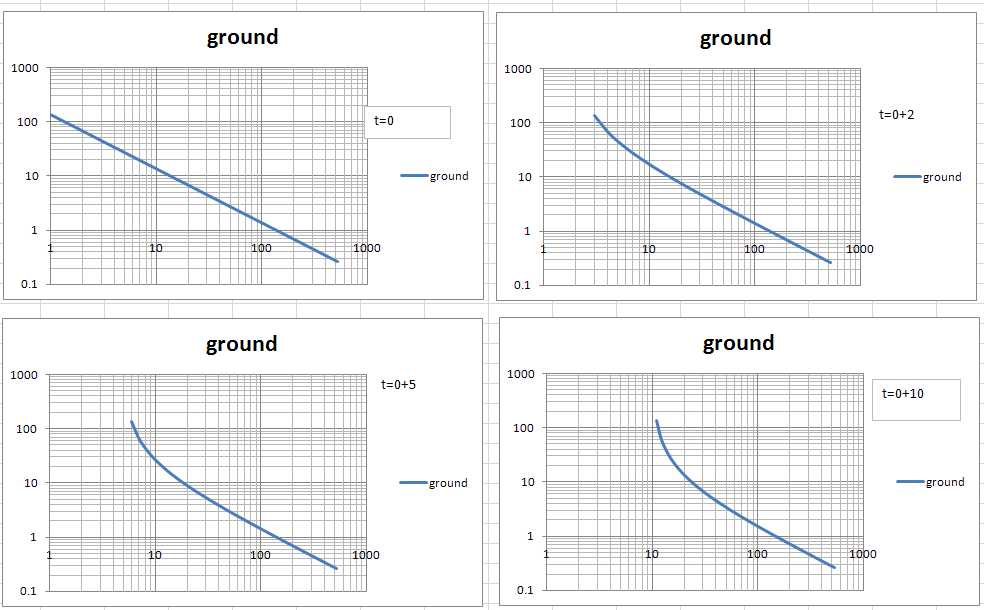

                    • I've wondered how a time shift effects the curve. Generated a slope of -1 at t=0. Plotted the same data starting at t=0+2, t=0+5, t=0+10. I hope I did it right, maybe not.
                      • Thanks Thomas,
                        it is clearly now where your t0 is. No wonder, that it has confused me when I looked at your original data with original time code 0.
                        Nevertheless, I don't like your t0 position. I like the t0=switch-off time position no matter how long the coil damping takes place (t0 = 0 time code).
                        Aziz
                          Hi green,
                          Yep! If you subtract a phase shift, then the log/log-curve should go down in the early times in your example.
                          That is the main problem here. If you don't know the real time code of the measurement data and make a best fit curve with Excel solver, you don't get reliable model parameters. Phase shift p is altering the exponent and other parameters.
                          Nevertheless, we have learned to be careful.
                          Cheers,
                          Aziz

                            • Hi,
                              I can’t believe that it is still not evident to some of you that the flyback pulse is the one that kicks the target. From the target’s point of view it does not make any difference if the H-field change comes from energizing the TX coil, or from de-energizing it during the flyback pulse. The coil’s energy can either be dissipated as heat in the MOSFET during avalanche breakdown, or in a resistor or electronic load in parallel to a tank capacitor, or can even be recovered from a tank capacitor. The flyback voltage determines the pulse length, and this usually does not need to be shorter than 2 µs. The only excess energy that needs to be dissipated as fast as possible in a damping resistor in parallel to the coil comes from the parasitic capacitances of coil, cable and MOSFET – but this damping takes place after the flyback pulse has finished. No need to have the damping resistor in parallel to the coil all the time, it is sufficient to turn it on just when the flyback pulse stops. In case of energy recovery, this saves quite a lot of energy that is otherwise dissipated in the damping resistor.
                              See here: http://www.geotech1.com/forums/showthread.php?20038-Triangular-Wave-Technology&p=164732#post164732
                              Aziz, my t0 is exactly at 'switch off' of the flyback pulse, i.e. exactly at the point where the H-field of the flyback-pulse has completely collapsed, and where the eddy currents in targets resp. the magnetization in MV soils reached their maximum.
                              Did you ever read my comments on the TX waveform of the MV document in post #545? It’s about the same problem – they do not take the flyback pulse into account, and instead they use pulse widths of the driving pulse in their equations.
                              With a standard PI timing, both the driving pulse and the flyback pulse affect the shape of the response curve of targets with multiple TCs and MV soils. Only when the driving pulse is separated in time it is solely the flyback pulse width that affects the response, so this could be used as a starting point to make things less complicate.
                              Thomas
