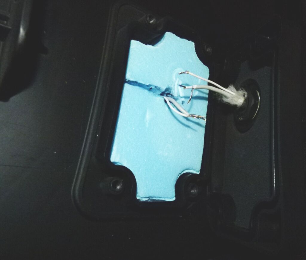

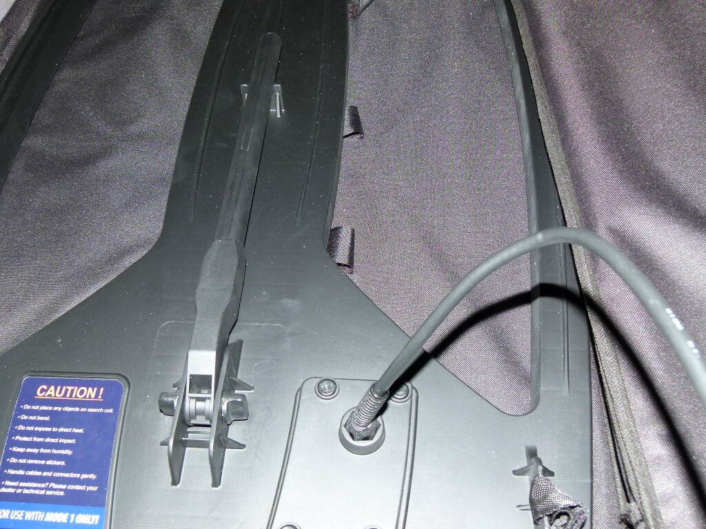

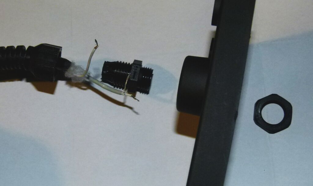

                  DeepHunter 1m-coil-mod for ultrafast broad-scanning!
                  20 days ago I finished the rolling-device for the Jeohunter coil:
                  http://www.geotech1.com/forums/showt...745#post183745

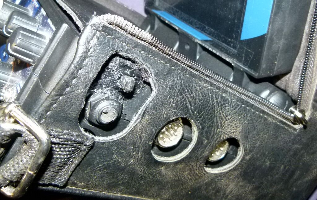

                  and yesterday I modified the 1m DeepHunter coil so it also is able to drive on wheels with the broad side ahead!

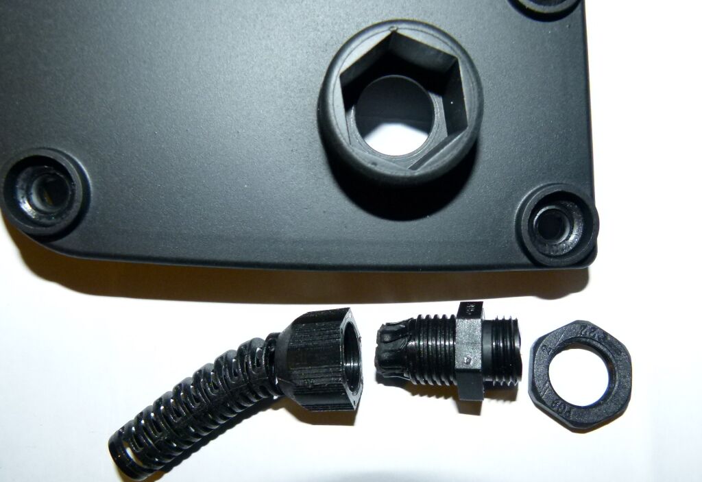

                  Because of the smaller coil-plug which fits through the original DeepHunter fiberglass-pole where the handle is mounted incl. reset- and other buttons
                  the following mod is not absolutly necessary, but it is better because that way the cable is completly free of the fiber-pole.
                  The steps are pretty simple but still must be done correctly:
                  1. if connected, disconnect the 1m coil cable plug from the DeepHunter electronic box
                  2. remove the plastic screw of the coil-pole which is mounted to the 1m search coil
                  3. remove the pole
                  4. remove the 4 plastic screws at the location where the coil-cable vanishes into the coil
                  5. open the plastic-cover carefully

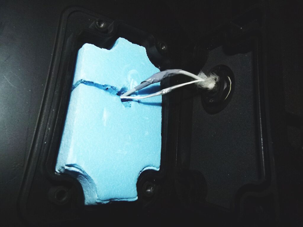

                  6. cut the two cables with a pliers in the middle so you have still enough lenght to work with them
                  7. unscrew the plastic parts from the plastic cover and afterwards drag the cable out of the screw-parts
                  8. drag the cable out of the fiber-pole (hold it at the bend-gum-part, it should move gently out of the pole)
                  9. remove a 5mm part of the plastic-shielding from each of the cables (see pictures)
                  10. insert the cable back through the upper plastic screw part and turn this, until the coil-cable is fixed
                  11. stick this part back to the plastic-cover and screw it tight closed from the below side

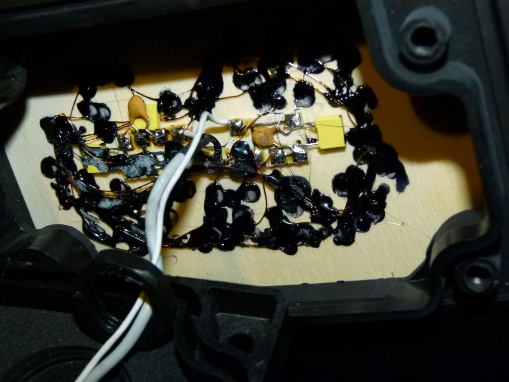

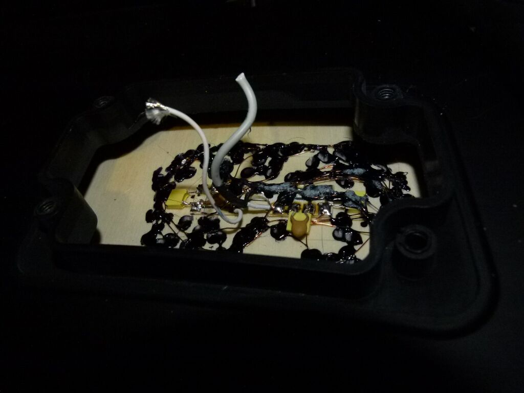

                  12. solder the cutted cables back together on their fitting ends:
                  13. start with the inner white cable of the thicker grey cable, isolate it first and afterwards solder the shielding wire
                  14. after all cables are isolated again, you can close and screw tight the plastic-cover
                  15. make a short test if the coil still works as before, there should and will be no difference if done correctly

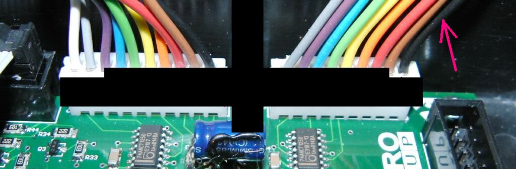

                  btw. I found out that the DeepHunter and Jeohunter 1m coils would be compatible if there justs exists a coil-cable adapter plug!
                  Instead of installing a seperate 4pin plug for the new motion coils they are using a connector with 9 contacts which
                  has enough connections for motion plus non-motion coils alltogether, but of course this is not good for compatibility.
                  You can read the little-pin numbers directly at the coil-cable plug, this is now the pin-out:
                  pin 1: the inner white cable of the grey shielded cable
                  pin 2,3 and 6: the shielding of the gray cable (those pins are connected inside the plug so the DeepHunter knows its the 1m coil
                  pin 4: the single white cable
                  If you compare it with the Jeohunter 1m coil diagram here:
                  http://www.geotech1.com/forums/attac...5&d=1325844719
                  you can see how the cables are connected, and if you have a spare Jeohunter 1m coil you can use it for
                  the DeepHunter and vice versa.
                  1m coil pin layout:
                  DeepHunter pin1 = A pin Jeohunter
                  DeepHunter soldered together pins 2,3 and 9 = B,D and E soldered together pins Jeohunter
                  DeepHunter pin 4 = C pin Jeohunter

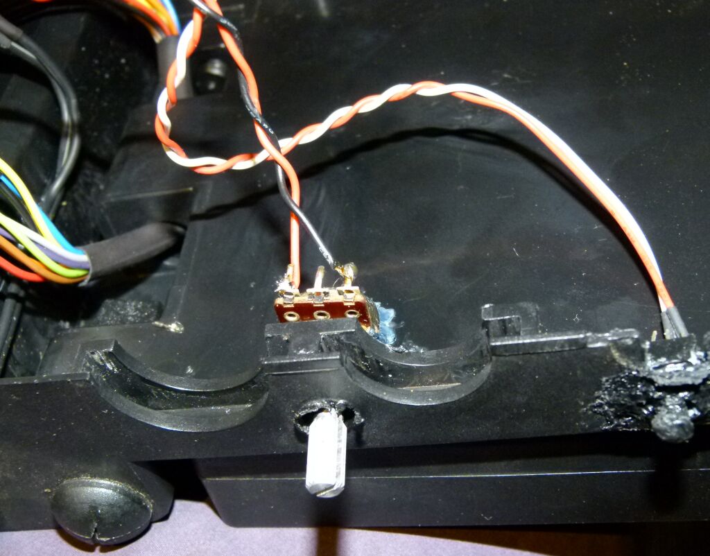

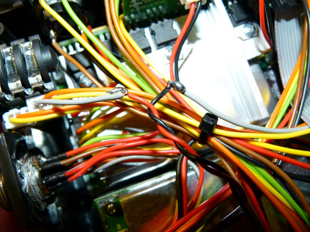

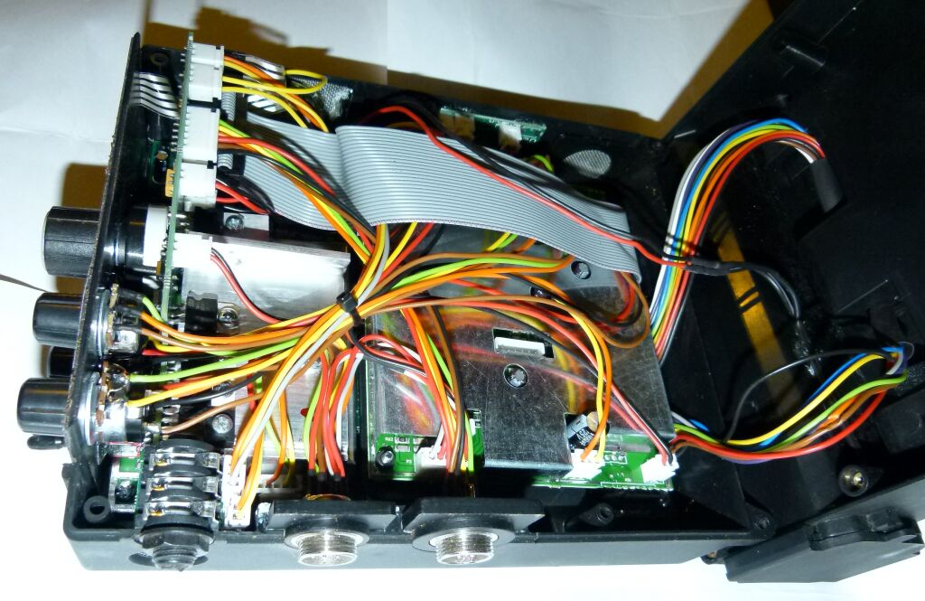

                      LCD backlight on-off- & Volume-Mod
                      Today for the first time I opened the DeepHunter.
                      link below:
                      The new motion circuit pcb is mounted on top of the improved JeoHunter platine.
                      This time I modified directly 2 things at once - the procedure is pretty simple:
                      LCD (backlight) on-off switch:
                      The LCD is used for the nonmotion circuit only (depth- and object-shape-scan, 1m coil, cavity etc.)
                      But often the LCD wastes energy for nothing and if the LCD is off the most of the time the battery life
                      per hunting time last up to 50% longer (9 hours instead of 6 hours with one accu pack for the Jeohunter).
                      The needed monitor cable is still the same as it was with the Jeohunter - it is the most right black cable.
                      Its the cable (of all those colored monitor cables) that is located in the most right and behind corner.
                      The black cable of the right row of cables - see picture.
                      Cut the cable, solder wires and a switch inbetween, isolate everything and mount it at a good location.
                      I've used the place directly over the head-phone jack for that little on-off switch.
                      variable resistor for the Audio-volume:
                      The non-motion circuit has a digital volume adjustment (10 steps) but the new motion-circuit has none at all.
                      Usually this is no problem but sometimes it is better if the volume is full adjustable, besides adjustable headphones.
                      The DeepHunters inbuilt speaker has an orange and a grey cable. Cutting one of those cables, solder 2 wires to both ends,
                      isolate them and connect the ends to a poti (or variable resistor) is the whole thing. Important is only a good place so it
                      is easy and fast turnable - from the outside of course. You can place it above the coil-cable and press-buttons-connectors.
                      The default motion-circuit signal output is pretty powerful or "very good hearable" even if there is a loud storm or a street
                      close to the search location, so I guess if set to more quiet the battery life could last ca. 15% longer.
                      And at special locations where it is quiet everywhere anyway a too loud signal-output could attract unwanted persons
                      or animals. Sometimes a treasure-hunter needs or wants something like "stealth mode" but without head-phones for
                      listening whats going on in the near vicinity like silent voices or steps, does somebody comes closer etc.
                      Try to make the needed holes as small as possible or isolate them afterwards so the electronic is safe from water or moisture.
                      The best location for the holes is the side where the coil- and pushbotton-cable-connectors are located.
                      Warning: You may lose your warranty if you open the box!
                      Those 2 mods are pretty simple but its still "your own risk" and you have to decide if it is worth the improvements.
                      And: Please remove the accu-block before you start with this modifications.

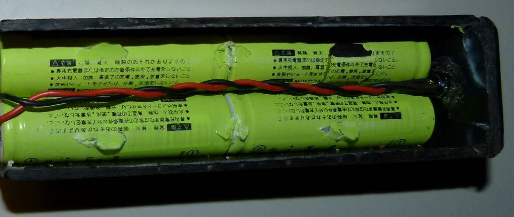

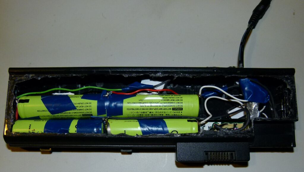

                        useful DeepHunter Accu-Pack
                        This time - instead by soldering-iron - I opened the Accu-pack with a foxtail saw!
                        Of course this has to be done extremly carefully, otherwise the saw destroys the cover of the batteries which even can lead to short-cuts.
                        But everything went great! The half stuff of the DeepHunter akku-pack now is inside the laptop akku-pack, replacing the old batteries.
                        A very good tip:
                        If you have a notebook, laptop or similar device with a removable accu-pack, always remove it if it is longer connected to the mains adapter
                        and used for longer time at home. Otherwise within one or a few years the accus will be ruined because of the many charge-recharge cycles.
                        Such LiPo or Li-Ion accus can remain for a long time in very good shape and working-condition if recharged / charged every half year only
                        or just if they are really depleted through normal device activity.
                        My DeepHunter / Jeohunter akku-packs from 2009 - 2010, now over 4 years later, still contain over 90% power compared to that time!
                        Also because those are completly disconnected from any "low-energy-draining" circuits. Inbuilt accus often gets slowly "eaten" by internal
                        circuits, standby and all-the-time-ready "solutions", especially mp3-players are prone for this. Those devices are never really switched off,
                        and over weeks or months in standby they consome alot of energy and even can fully deplete the accu.
                        So for storage if possible always completly remove the accu from the device and keep it at a cool and dry place.
                        btw. meanwhile I have a spare DeepHunter plastic case but thats no problem, the standard size of those accus is 18mm diameter and 65mm lenght (type 26650).
                        You can buy those as single units or already 4 in series connected with the same voltage and size, so when I find some good 3000mA strong, I can create a super
                        new megapower accu-pack.
                        And be warned if you see such model 26650 lipo or liion accus with 5000 or 6000 mA written on it. This is ridiculous exaggerated by many fishy accu-producers!
                        Outside they write an attractive high mA value but inside such accu often is totally unpowerful! Those 26650 lipo-cells can maximum contain around 3000mA!
                        If you will really test the capacity of such oh so fantastic 5000mA accu-cells you will see that it may only contains half the power!
                        Good Luck for the new treasure season!

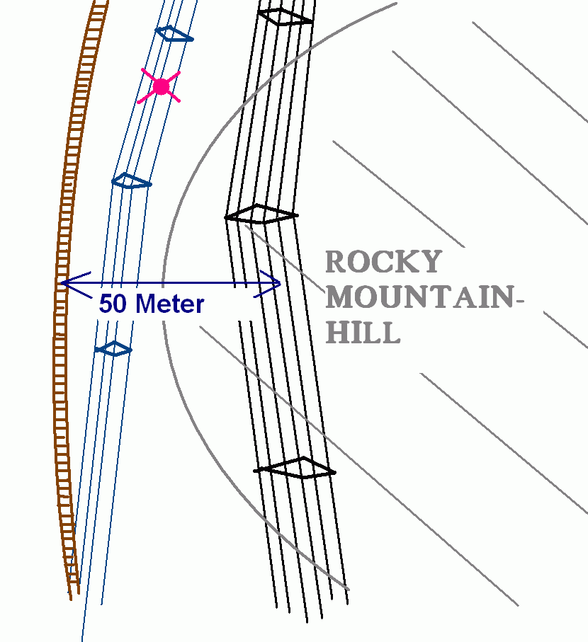

                                Yesterday I visited a location where usually EVERY non-motion detector is completly useless,
                                because it just beeps like crazy and the sensitivity is reduces by 70-80 % !!!
                                There is within 50 meters a 380kV line, a ca. 50kV train-power-overland-line and a train-route !!!
                                Can you imagine what an ultra-high concentrated electro-smog pollution you get there ???
                                Usually a metal-detector already starts to go mad if just one single train route is 50 meters nearby,
                                but the train-electricity overland lines are 5x noisier and those lines was 25meters directly above!
                                This special situation is because the last hill of a steep mountain is in the direct way from A to B
                                so all the connections are concentrated at this spot (have to go around there). (see attached sketch)
                                But as you can see in the two videos, the DeepHunter with 32cm motion-coil still does a fantastic job.
                                It detects a little 16,25mm and just 2,3gram lightweight european one cent coin from 15cm in air
                                - at around 50% sensitivity and ca. 55% disc-level. If that coin is buried the result is even better
                                because that way the motion-circuit is fully active and filters away even more of that high e-smog.
