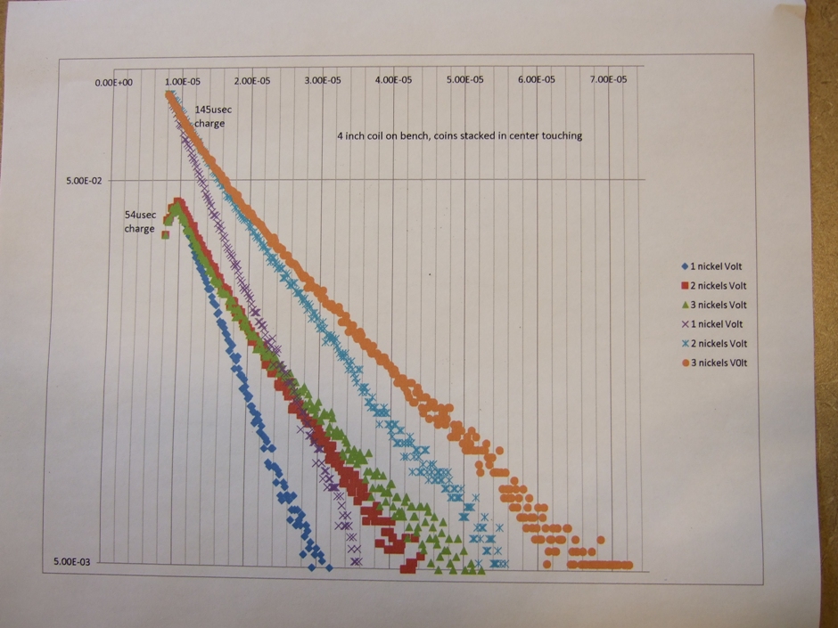

                  I didn't get a difference in amplitude at 10 usec when stacking the coins the other day. I tried again today. I measured 1 coin and 1 coin stacked on a wood spacer = to 2 coins to see if position mattered. Plotted the same. I tested 1,2,and three nickels again with different charge times, 54usec and 145usec. Very little change in TC.

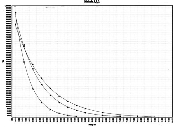

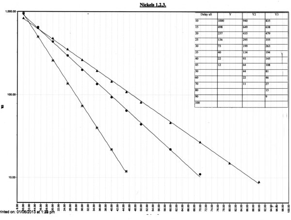

                          Here are the plots for the 3 Nickels test. As each coin is added it is insulated from the previous one by double sided sellotape. This prevents relative movement of the coins while the measurements are taken. To answer Carl's question about the TX pulse, all my tests are taken with proportional pulsing. This means that the TX width increases proportionally to the delay time and sample width. i.e. 40uS TX for 10uS delay and sample pulse width - 80uS TX for 20uS delay and 20uS sample width - and so on such that at 100uS delay we have 400uS TX and 100uS sample. Constant current TX circuit keeps current the same for all pulse widths. With the Nickels I still see the drop in initial amplitude as each coin is added. This shows up more on the linear plot than it does on the log linear as the top end is obviously more compressed on the log. Actual data is in the data table.
                          The question I am wondering about is, if I had a piece of identical solid metal equal to the thickness of three coins and the same diameter, would I get the same decay curve as that of three insulated coins?

                            I posted my plots since they were different from Erics. Why I don't know. Maybe neither test relates to measuring the coins at one and two times the coil radius. I got very little difference in amplitude at 10usec when adding the coins. At 40 usec adding nickels increased the amplitude. Adding quarters decreased the amplitude. We have a sign at work (One test is worth a thousand expert opinions). Only true if the test is valid and relates to what you want know. Measuring the temperature of a cup of coffee with a large metal dial thermometer gives the right answer but not what the temperature was before measuring it. My test is simple. Anyone with a DSO could do the test. If it doesn't relate to PI metal detecting I would be better off not doing them. I've worked in measurement for many years and for me it's fun. I'm not trying to disagree with anyone. When it comes to metal detectors I don't know enough to agree or disagree. Just wanting to know what testing methods might be valid.

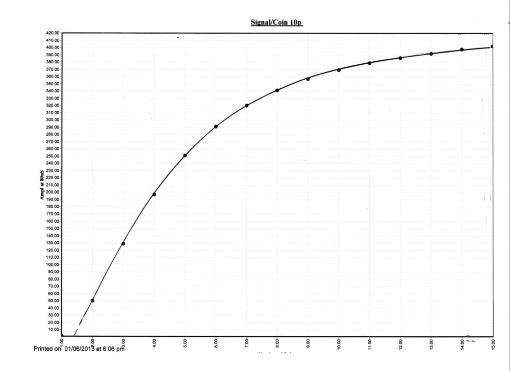

                              We are all learning, whether we have been in the game for a few years or many. There are many variables which can alter results, but experimenting can be extremely valuable and as you say, Green, it is fun. By experimenting, I have come across things which work, that no amount of time doing calculations would have done. When it works, then see how the theory fits.
                              I have just done another plot for fun. Using our plentiful 10p coins, which are a similar material to a nickel, I set my instrument to 80uS delay where 1 coin does not quite give a reading. I then stacked up one at a time 15 coins and noted the reading increase. This is still my 30mm diameter solenoid coil, so the coins are getting further away as they stack up. However, the amplitude increase at 80uS shows the lengthening decay time. X axis is number of coins.

                                Eric
                                Your plots with nickels look closer to being the same at the start. I averaged my readings from 10usecto 12usec to see the difference. (54usec pulse) 1 coin .0378v,
                                2 coins .0381v, 3 coins .0403v. (145 usec pulse) 1 coin .0625v, 2 coins .0705v, 3 coins .0691v. Mine were lower at the start. Thanks for all the testing you have been doing with targets and ground response.
