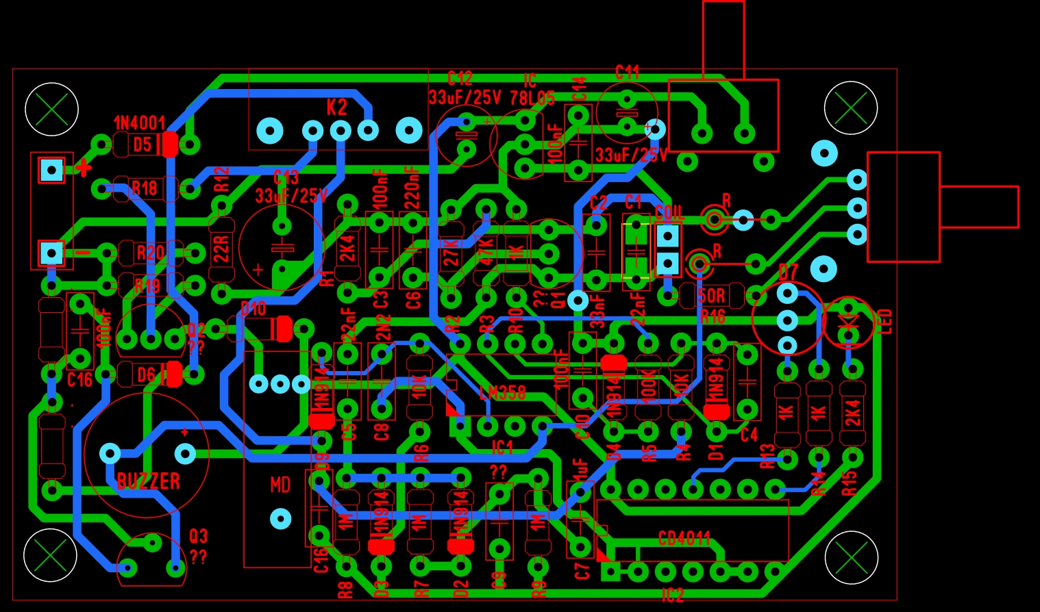

                            PCB maybe that?
                            Mistakes can happen. only suggestion
                              unless some tracks are missing, the 4011 does nothing.

                                Wow, impressive given the short amount of time. Yes, you have some missing tracks, but tomorrow (late) you will have HiRes images of the top and bottom faces of the bare board.
                                I have a plan to use a light table to backlight the bare board as well as do a regular image of each side. Backlighting really shows up thin tracks well.
                                Please see the final draft of the Parts List, as there are a few corrections in it now, plus 'as measured' values as all parts were removed tonight.
                                Looks at first glance that the 4011 is partly being used as an inverting buffer....
