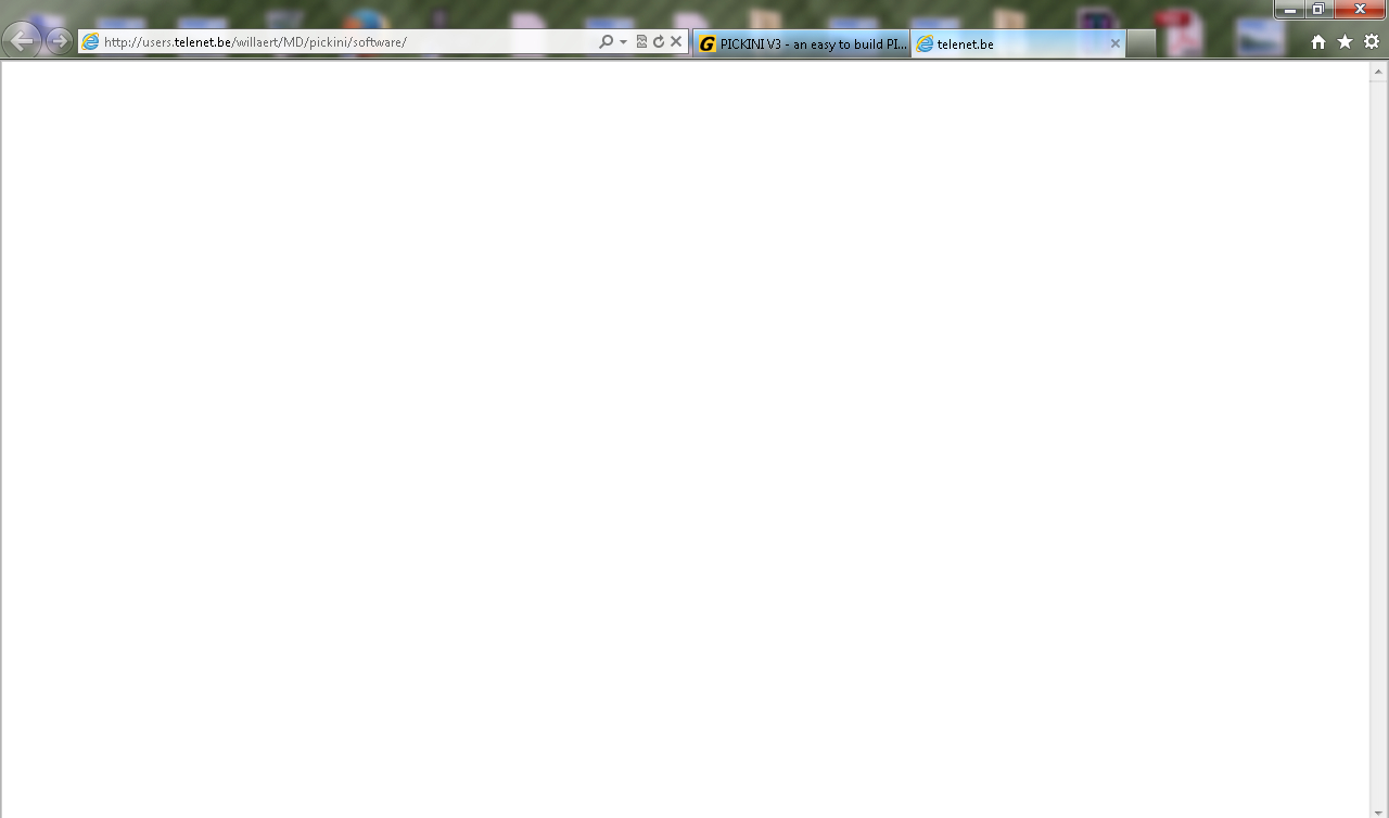

                            hi
                            i can't download any thing from http://users.telenet.be/willaert/MD/.../pickini_en/V3 because the link not open for me!!!
                            can you upload all file here?
                            many thanks
                            • #89
                              http://users.telenet.be/willaert/MD/pickini/software/
                              Try this, just click on each file and save.
                              • #90
                                thanks 6666, but the link don't work for me!!! when i'm clicking on, there is no thing , only blank page!!!
                                please if you can, upload all files here
