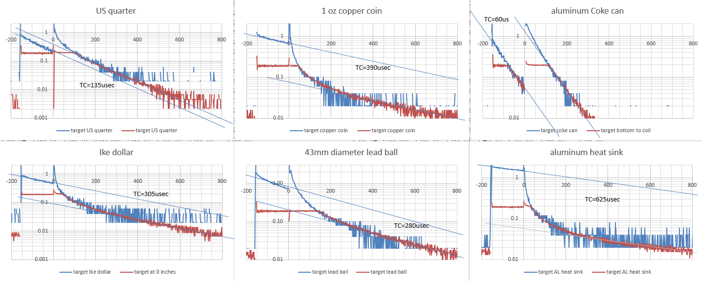

        Thanks for the link to the paper. Read it a couple times. Decided I needed a paper(magnetics for dummies)to start with. Did a search and found some but so far haven't answered my questions. Charted targets a little different. Tx, 160usec 6250 amps/sec. Rx two 200mm round coils figure eight, IB. Blue trace, preamp out(gain about 450)target recording-no target recording. Red trace, amplifier out(gain=9, total gain about 4000)(target recording-no target recording)/9. Added a line to coil off trace where it appeared to be straight on the lin log chart and calculated time constant. Added another line parallel to the other line thru the coil on decay. The decay slope was similar with all targets but the lead ball. Ground, ferrite and some hot rocks I have chart an amplitude change with little or no decay slope when coil is on. A nail depending on orientation charts an increase in slope when coil on. Coil current shape and on time effect the coil off decay. Does the target look like an inductor with resistance when the coil is on? What controls the decay slope when the coil is on with a constant rate current? The paper explains the coil off decay.
        I've made a lot of measurements. Knowing something about what I'm trying to measure and what to expect makes for better measurements. Some time things don't repeat as close as I think they should, probably because I don't know what to expect. Any suggestions would be appreciated.
        How much if any would reducing the Tx from 1000pps to 100pps effect the Rx signal amplitude or decay shape?

          Tried a spice simulation to understand what is happening with a constant rate current Tx pulse. The target(coupled LR circuit) volts and current look like they increase exponentially. The signal decreases on my charts. Don't know how to do a IB simulation. Maybe that would help explain or maybe someone could explain what is happening. Thanks
            It is not that complicated. Although physically more correct is the paper Eric linked, you may observe this via skin effect as well. The skin effect is frequency dependent. After a transient excitation, the immediate response at time t1 is bandwidth limited from below at about 1/t1, and the high frequency corresponds to thin skin. Later on at time t2>t1 the bandwidth limit goes down to ~1/t2, and that's the reason thick chunks of good conductors appear on PI machines to have taus exceed values expected by their conductivity.
            IB-s have no such problem because there is no frequency dependence - frequency is set. Therefore with a given material skin depth is constant, and only when a sample is considerably thinner than skin size, like with aluminium foil, you get off effects.
            As for detecting deep anomalies, I'd say "cable locator" kind of a detector would be in a considerable advantage over normal metal detectors.
              Thanks Davor, I think I'm starting to understand the coil off decay. The coil on I hadn't. I keep forgetting coupling is rate of change. Don't see skin effect on the coil on trace. With spice the target current had an exponential increase in current during coil on with a constant rate Tx pulse. Faster at start so the IB Rx trace should be higher at the start and decay exponentially? Maybe all wrong? Still would like to know how to do an IB simulation with spice.

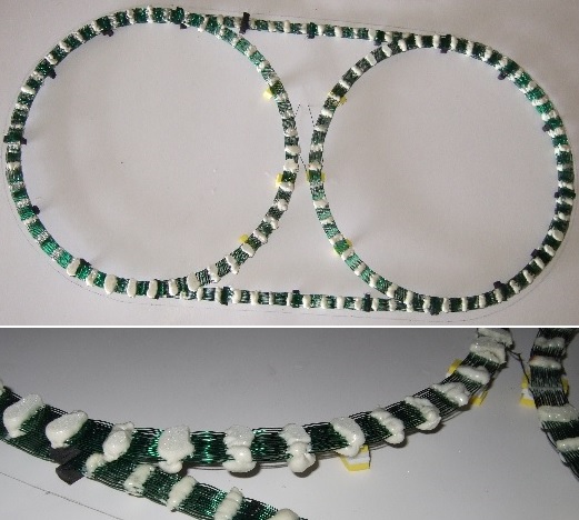

                    My IB coil. Rx two(200mm round coils, figure eight) Tx(oval over Rx coils). A picture I posted awhile back.
                      Very nice. And what is the setup you use to get the response diagrams?
                          I use a RIGOL 1052E to record the data(low cost scope but good enough). Use IB coil reply #39 potted with foam with graphite shield. Two stage amplifier, first stage(gain about 450) second stage(gain=9 for total gain about 4000). Scope channel 1 connected to first stage amplifier out, channel 2 connected to second stage amplifier out, scope trigger connected to coil mosfet driver input to trigger at Tx off(zero usec at turn off). Record a no target scan, record a target scan(target height adjusted for near full scale on channel 1). I use a similar coil(Rx about 38mm diameter) for smaller targets to get enough signal. Copy the no target recording and the target recording into Excel. Multiply the time recording by 1E-6 for usec. Subtract channel 1 no target recording from channel 1 target recording. Subtract (channel 2 no target recording from channel 2 target recording)/9. Chart the data on a XY graph. Change the XY scales to desired range, linear or log.
