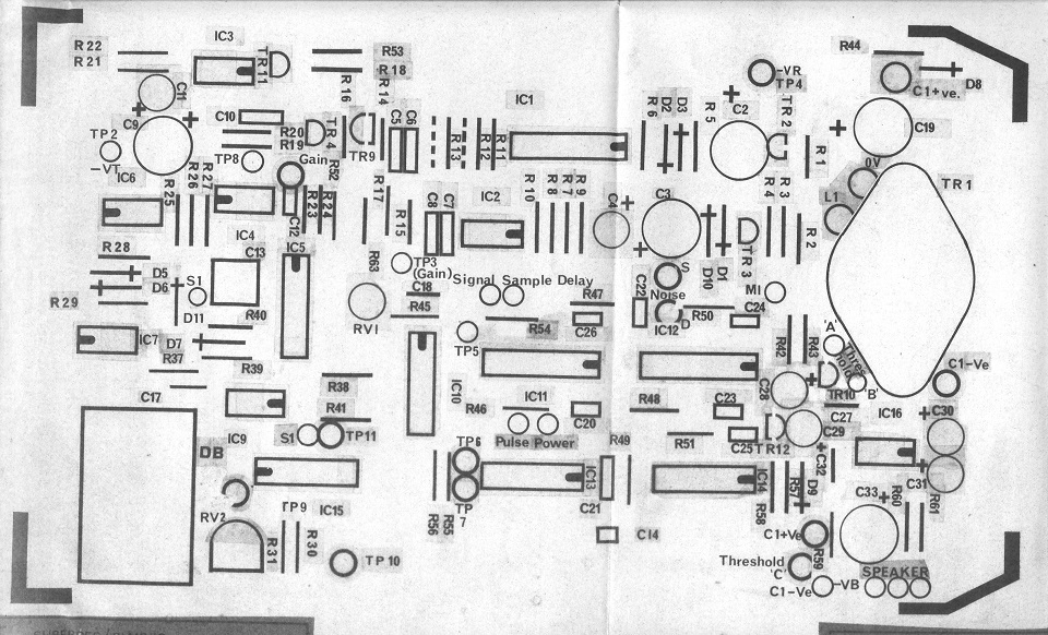

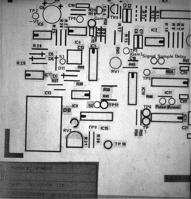

Pim Puls .XR 7
    I looked again I do not have a complete scheme I put pcb xr 7 !Click image for larger version
ID:	350535Click image for larger version
ID:	350536Click image for larger version

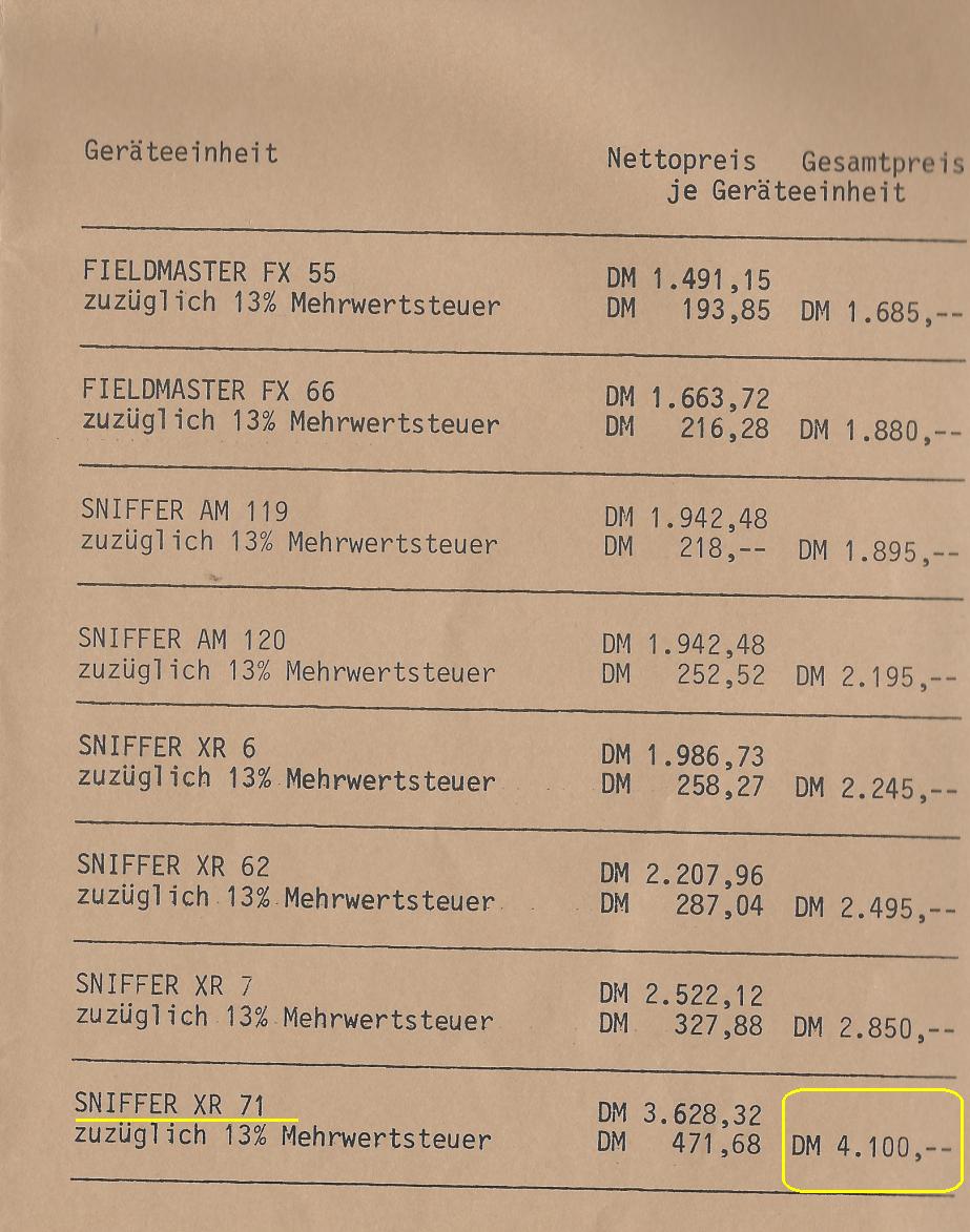

          Hi Eric
          It was known as "AS" company:
          A+S, Albrecht + Scholz, Handelsgesellschaft mbH & Co. KG Kühlwetterstr. 28, Postfach 140106, 40239 Düsseldorf
          Seem not active in detectors field anymore.
          Sniffer XR 71 "kostet" in 1983 more than 4,000.00DM (Deutsch Mark).
          More details out of my archive (click on picture for zoom):

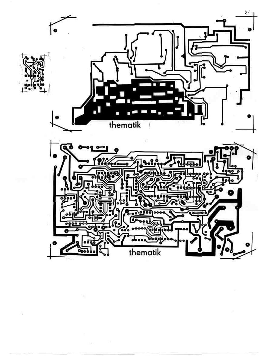

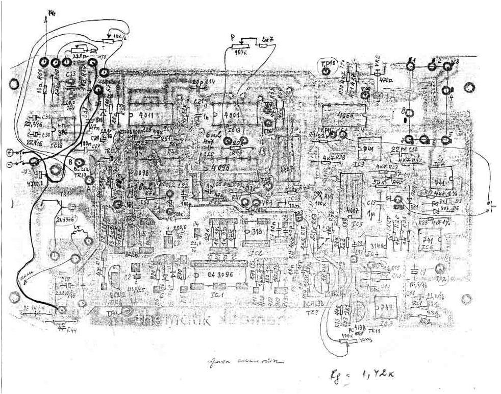

Name:	4_4 dijagram 2.jpg
ID:	350550 Click image for larger version
                Components on pcb this is it !

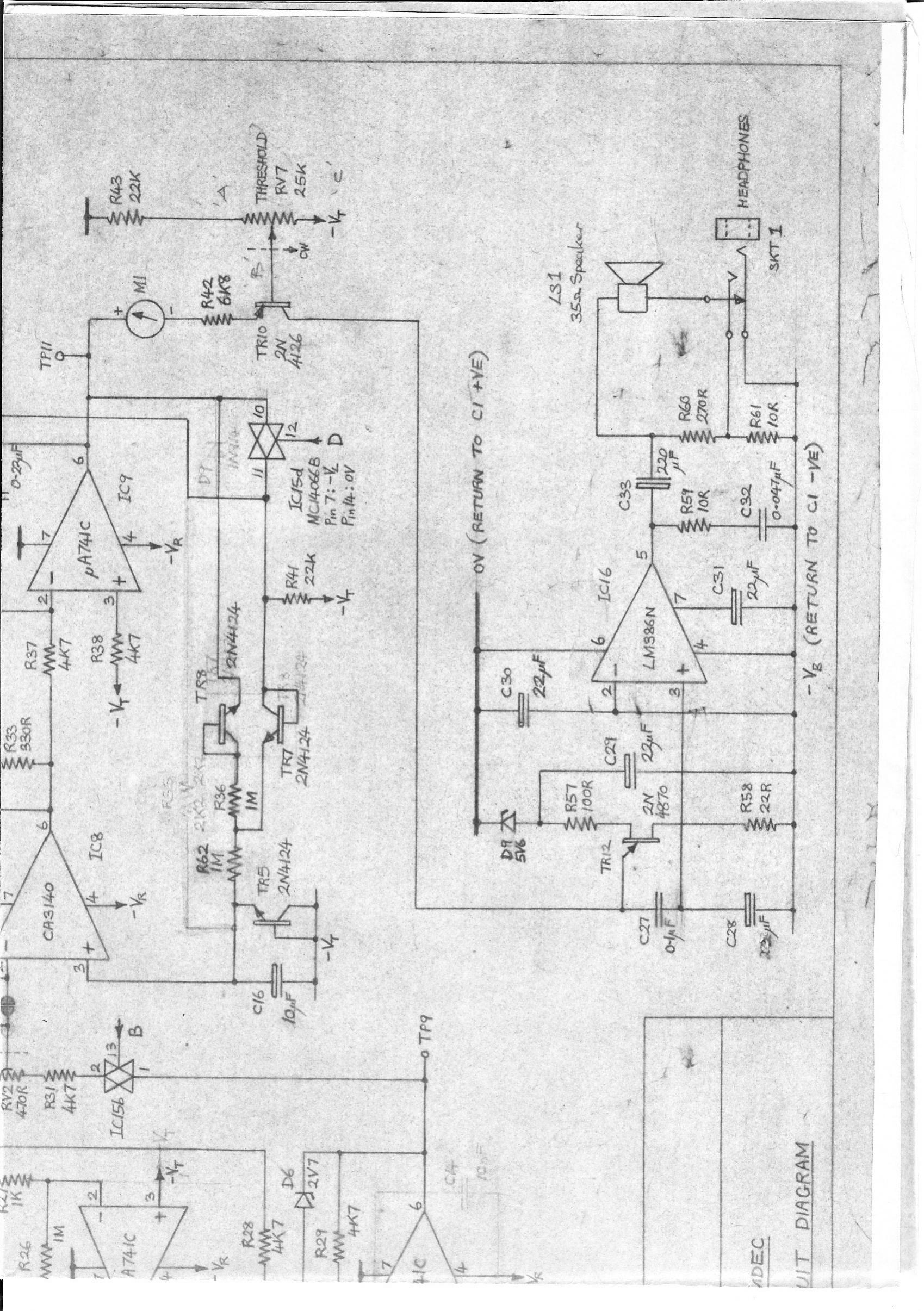

                        Hi Kt315
                        You said, "After a few years, Australian Erik Foster (Eric Foster) and Bulgarian Georgi Georgiev modified Sniffer XR-7 and commercialized it under the name Sniffer XR-71".
                        There are lots of Eric Fosters, but I don’t know of one from Australia that is also involved with metal detectors. This one, UK born and bred, has only visited Australia a few times to test detectors designed for the unique conditions of ground mineralisation. I have no knowledge of a Bulgarian person by the name of Georgi Georgiev, and I have never been personally involved in modifications or commercialisation of Sniffer XR-7 or XR-71.
                        "So, when all is assembled, it is certain that the DBP2010 and Sniffer XR-7 detectors are technically identical to the Sniffer XR-71 and Delta Pulse
                        detectors, while the detectors DBP2010 and Sniffer XR-7 are different from the Sniffer detector XR-71 and Delta Pulse.
                        To date, the Delta Pulse detector has undergone countless modifications (fewer or more successful or unsuccessful), and most of the trick".
                        As always seems to happen, detectors are copied, modified, improved, or their appearance changed by third parties, and in the course of time their origins become blurred or lost. What I do know for sure is that the 1979 schematic, parts list, and pcb layout that I have for the Pimdec and Superdec, originated with a company called Slade Electronics and the designer was Roy Parkin. His pcb matches that posted at the start of this thread.
                        There were lots of other ‘dec’s. Pulsedec, Microdec, Aquadec, Friskdec, and Hypodec. All of which were originally designed and made by my company and sold through Allen International in London who later setup Pulse Induction Ltd.
                        In the mid 1980’s, Slade Electronics also produced a detector called Eurodec, and the company where I then worked as Technical Director (Pulse Technology Ltd), got involved in helping to trace a design fault where one of the IC’s kept failing. That is when I met Roy Parkin who visited us with his Pimdec/Superdec and Eurodec, and gave us the schematics etc that I now have, so that we could do our own sales and servicing.
                        My parts list shows that the difference between the Pimdec and Superdec is that the Superdec has two less controls. i.e. 5 and 3 respectively.
                        It is good to know that these designs are still current and attract considerable interest.
                        Eric.

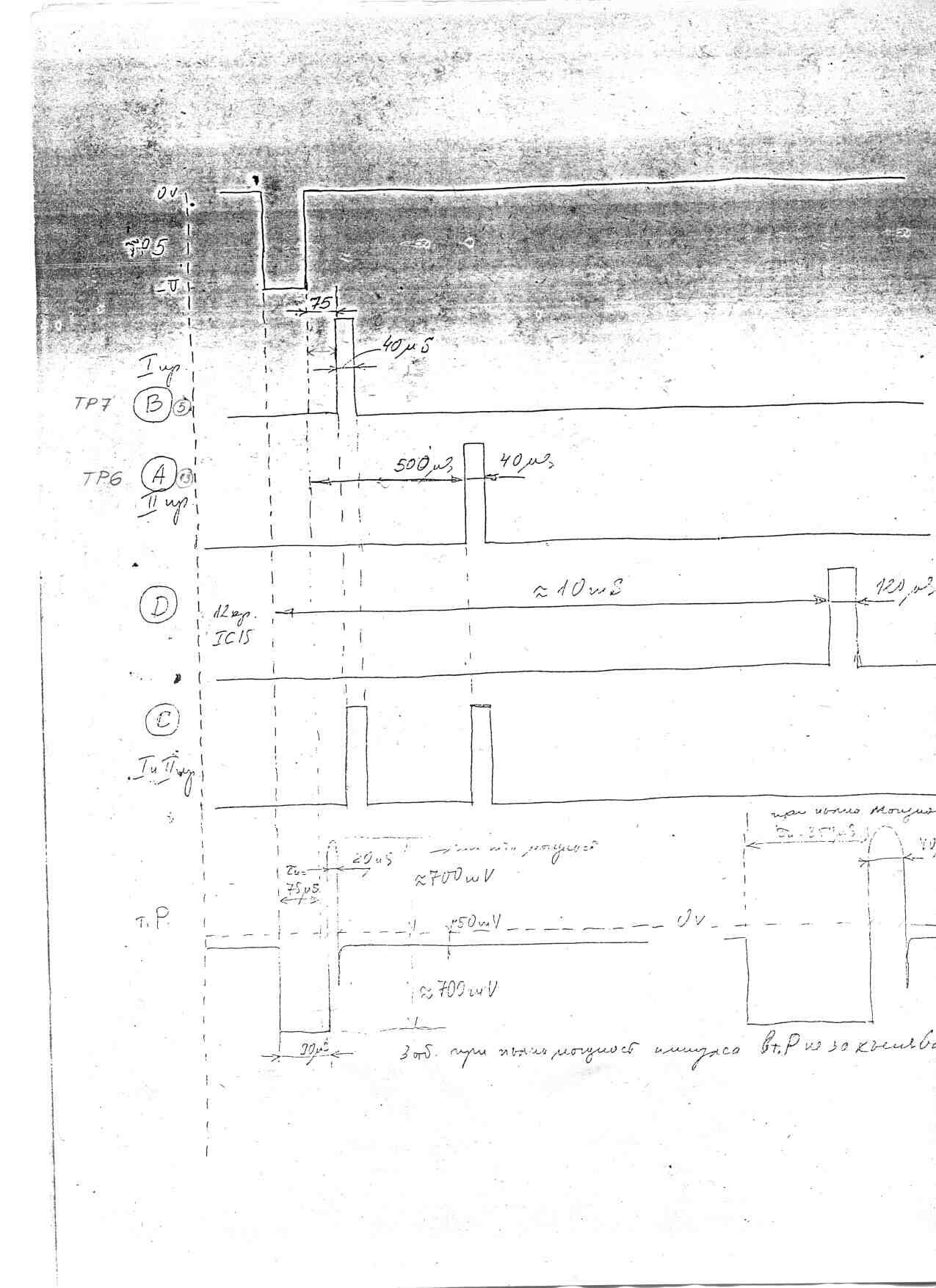

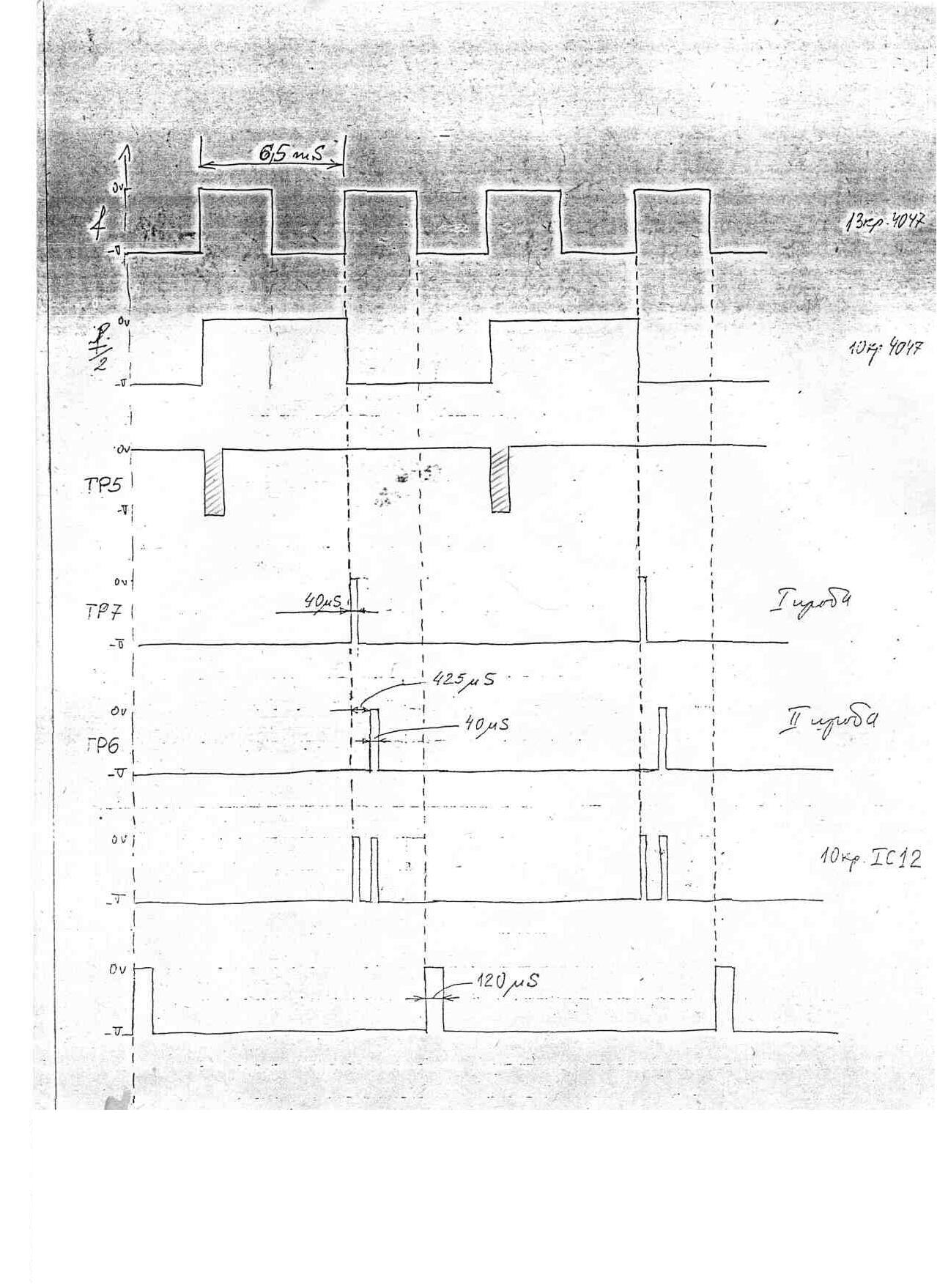

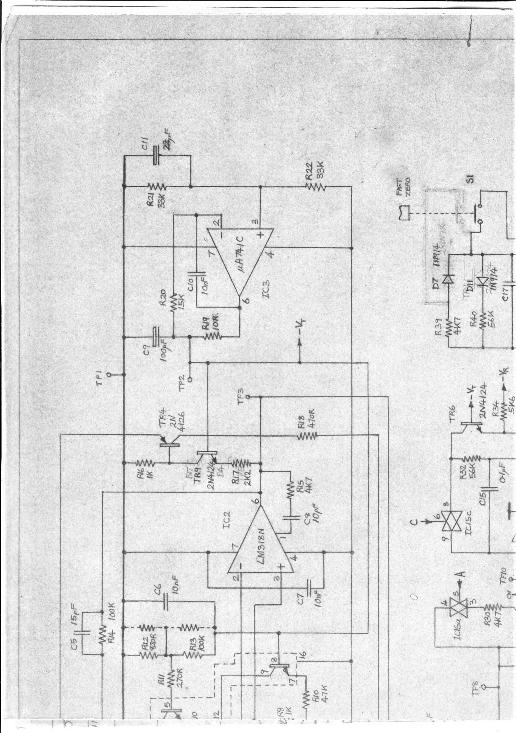

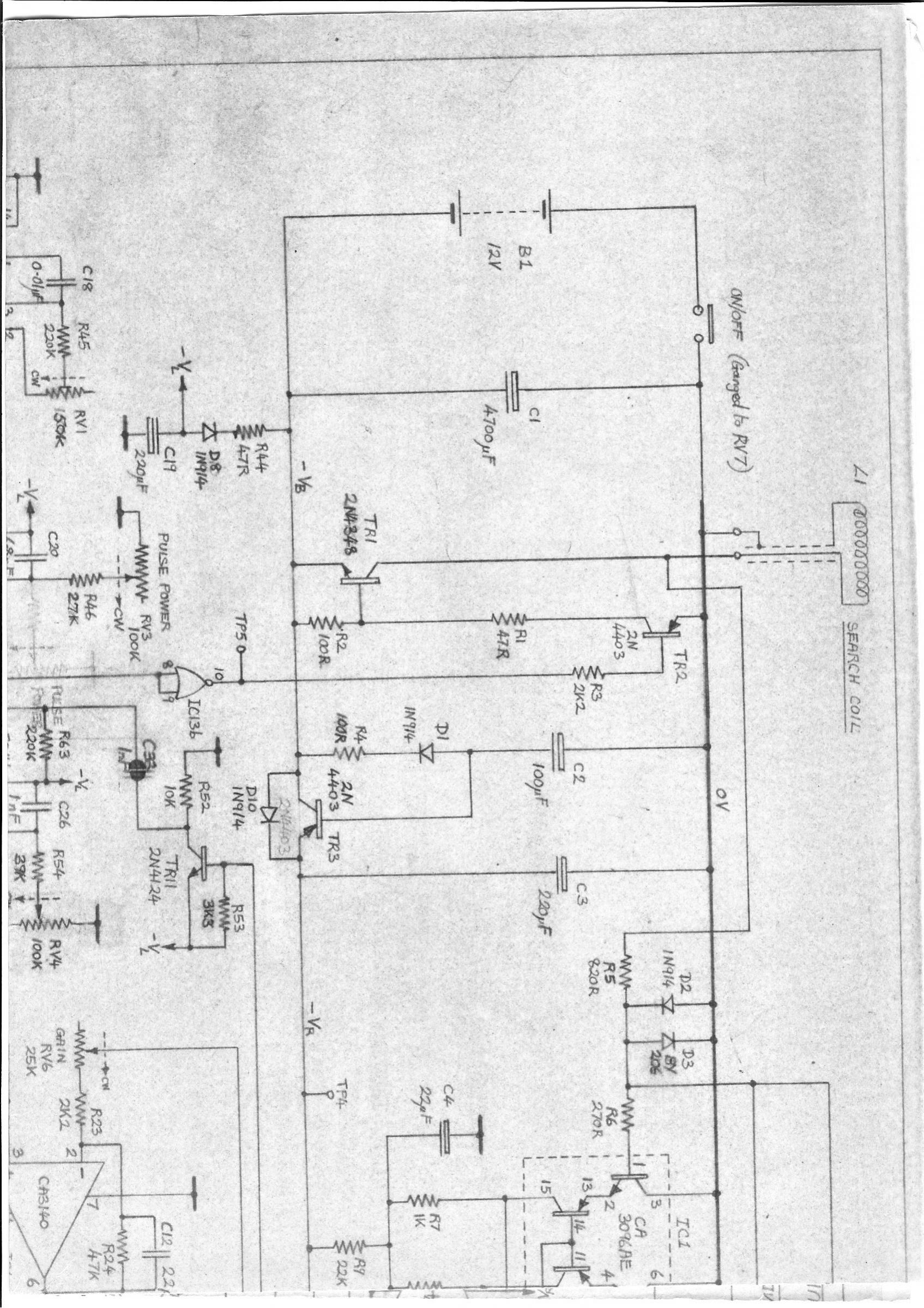

ID:	350551 Click image for larger version
                          i said? 'Sneshka' said. i have to correct my notes by your new historical excursus guys.
                          he meant you Eric. there are not more Ferric Toes.
                          thank you.

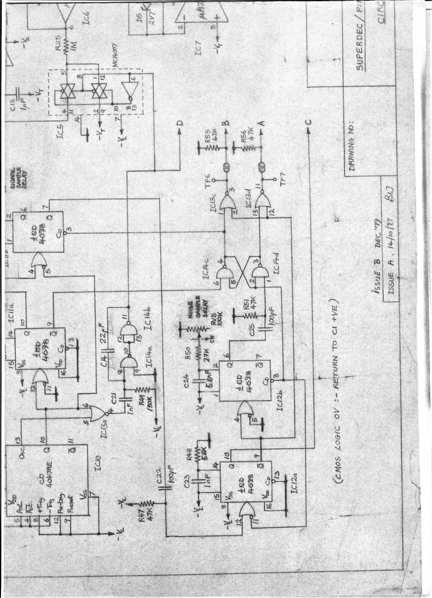

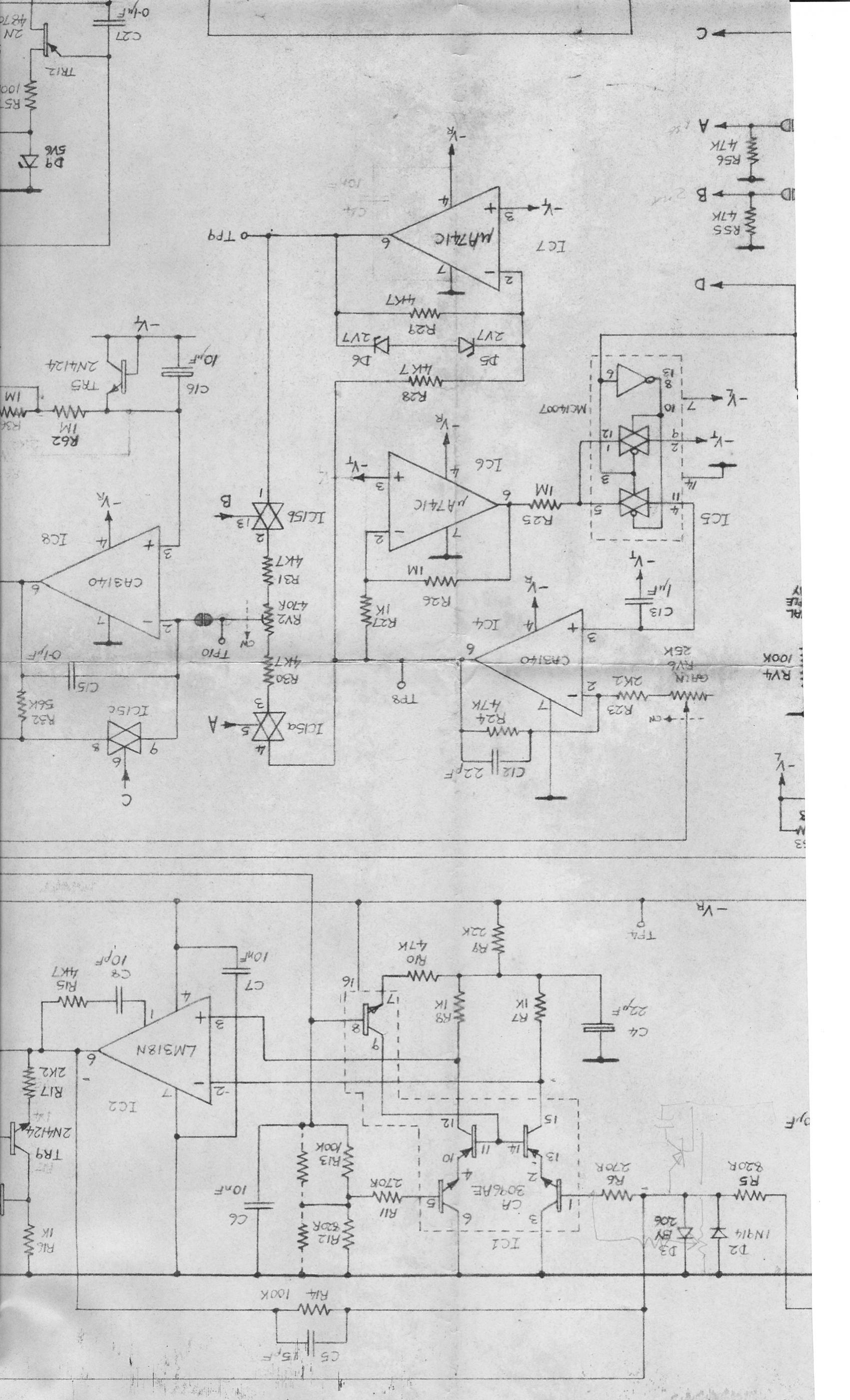

                            Is there some more complete electricial schematic for this design that are possible to share in public?
                            The bits posted by Orbit looks like drawings from reverse engineering done by bulgarian folks and are incomplete.
                              thank you.
                              Sorry, I thought Sneshka might be your name, as I only know Kt315.
                              The size of the schematic is such that I had to fold it in 4 to get it in the scanner, so I have scanned into 5 pieces which have to be stitched together. the vertical scan is of the mid section top to bottom as this is where some connections may be missed or unclear. Parts list to follow later as I have other work to do.
                              Eric.

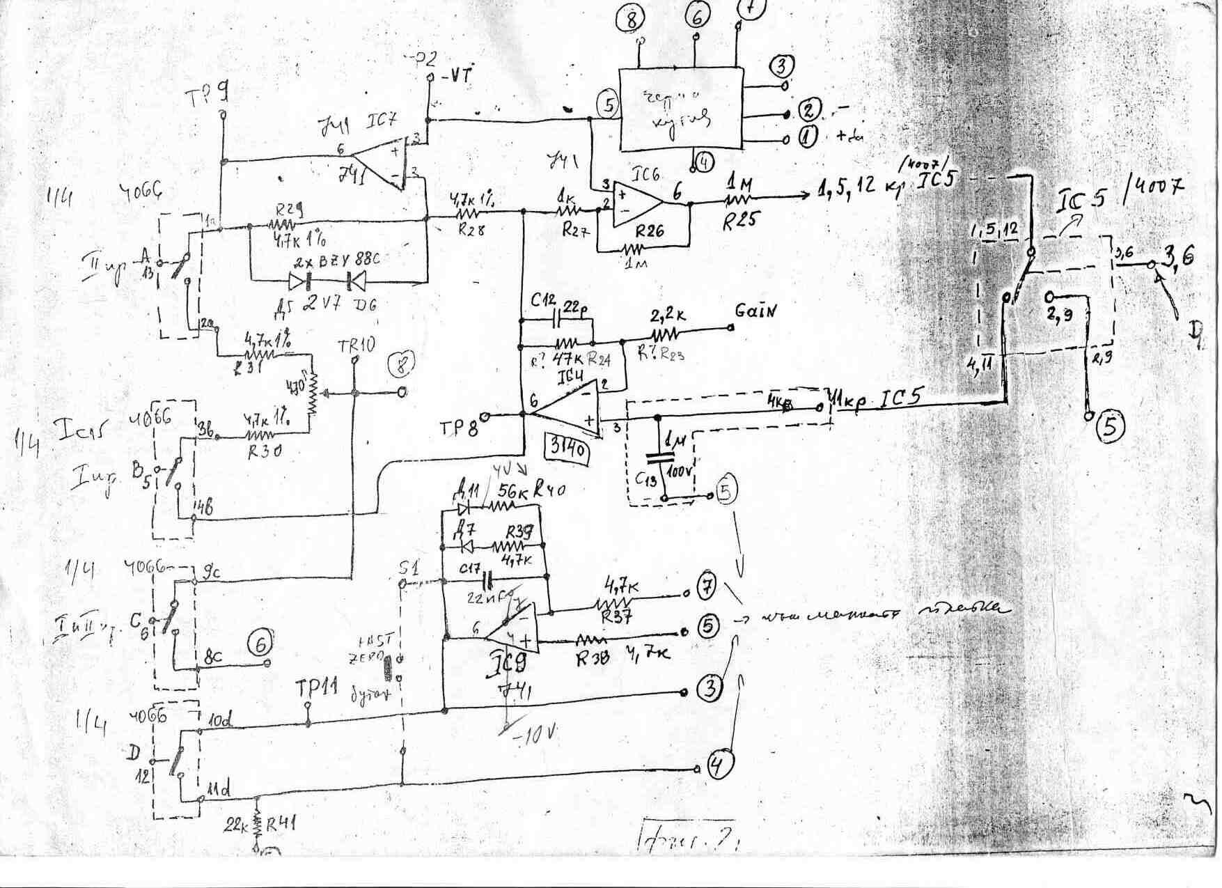

ID:	350553 Click image for larger version
ID:	350554 Click image for larger version
ID:	350555 Click image for larger version
ID:	350556 Click image for larger version
                                Wow that's fantastic, Eric, that's valuable contribution once again!
