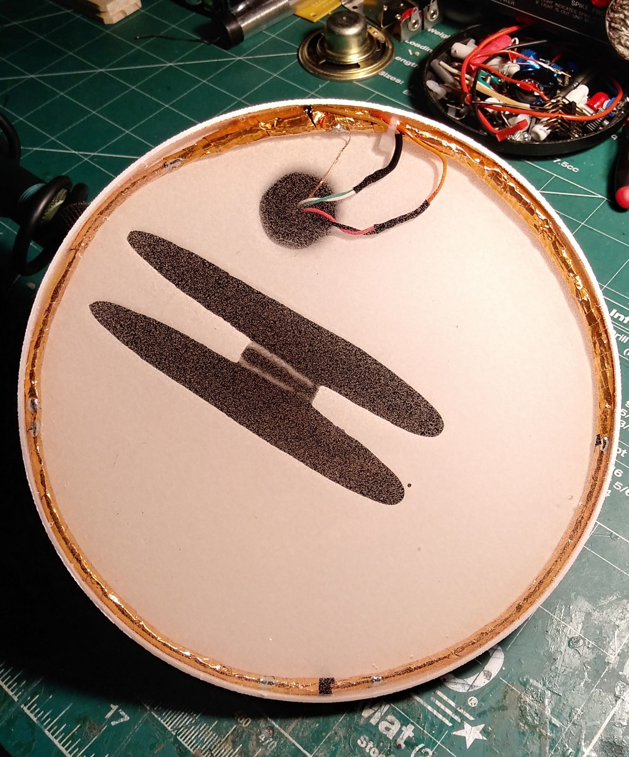

    Hello, any photo of the coil inside?

            • #51
              Don's friend and mine sent me one he has built last winter. He says it works very well to 7" on a men's gold wedding ring.
              Unfortunately, the parcel has been sitting in the US since early part of this year at my parents. I was going to go down there to visit from Canada. But, Covid hit and they closed the US-Canada border.
              No guarantee when it will open again. Having it shipped up to me, should have it within the next 10 days.

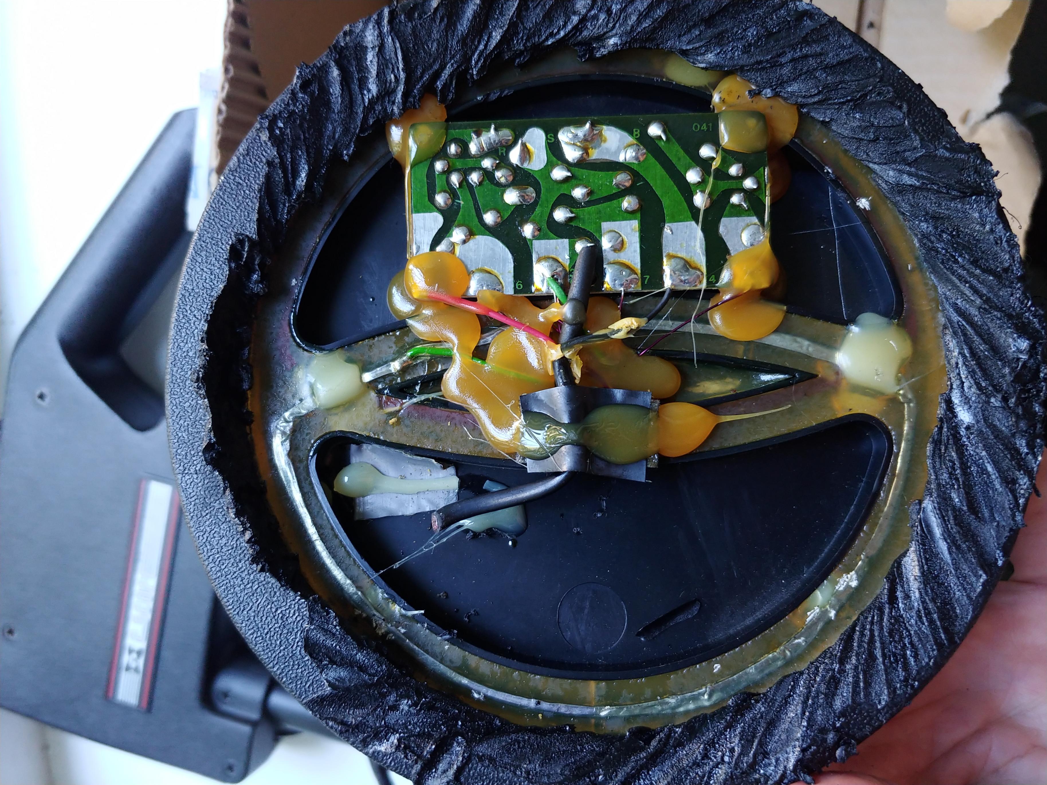

              • #52
                Thank you, glad to see you here) I have TR 200 DD coil it should work with this Mod. Will try soon.

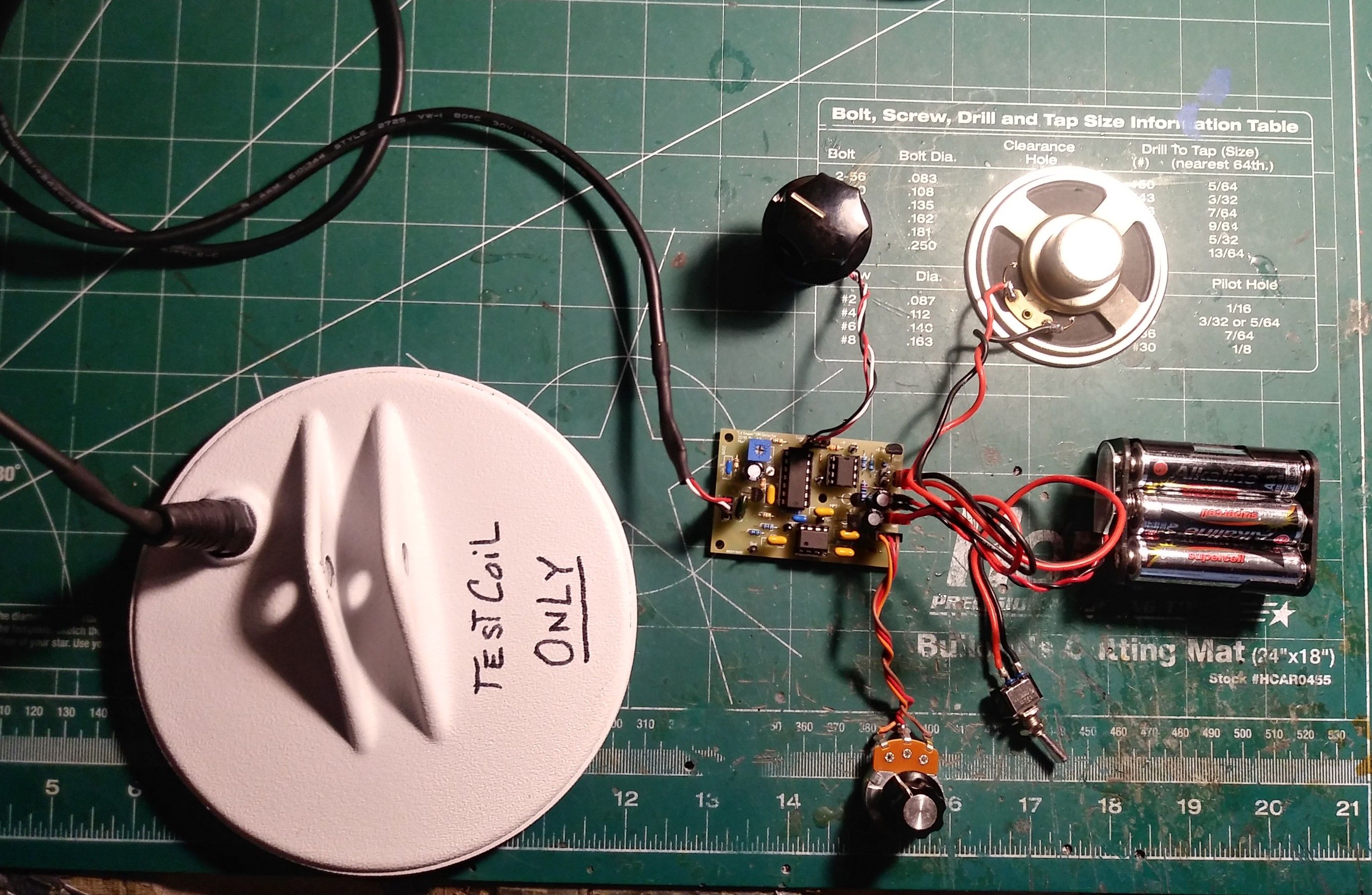

                          • #58
                            Just got my parcel sent over to me from my parents. Looked at the TR board, sure is tiny. Like the small coil as well.
                            Have to find a small box for the board and battery. Looks like fun.
                            The board is 2019 rev. 13
