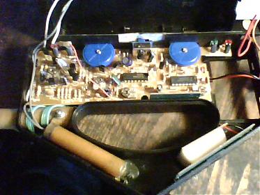

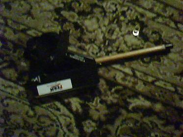

      i made my pinpointer out of this thing
      preety good sensivity 2 - 3 cm, but deam this thing is huge
      i attached small vibrator from mobile phone directly to the speaker and installed switch, also made push button trigger

        I like it... stud detectors are good for that... I made also one, but it's "lost" ...I mean I borrow it to a friend...and never come back!
        My was smaller and yellow thing... but detection was never up 1+1/2''... good but not as good with smaller stuff.

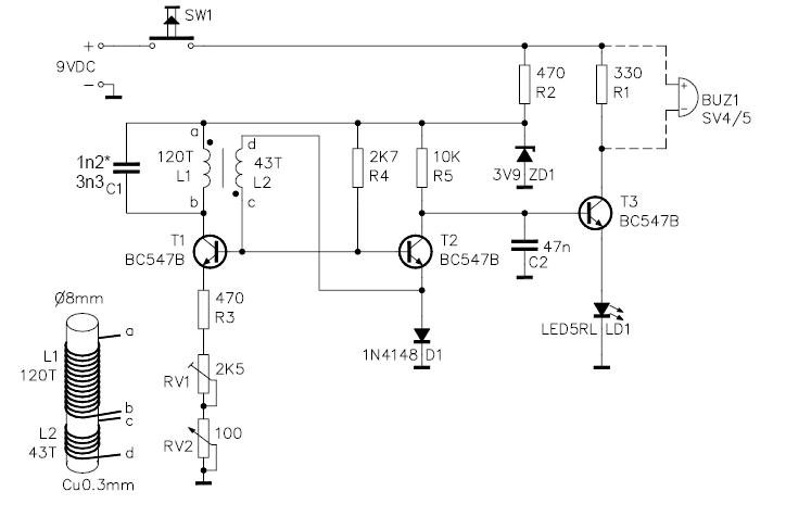

                      first pdf
                      Hi Max,
                      I had the same problem with first pdf. It should be ok this way; try to open the attached file.
                      • #42
                        Originally posted by Noemio View Post
                        Hi Max,
                        thanks. It's another simple and interesting schematic for small DIY pinpointer.
                        I think I'll make it too...
                        Kind regards,
                        Max
