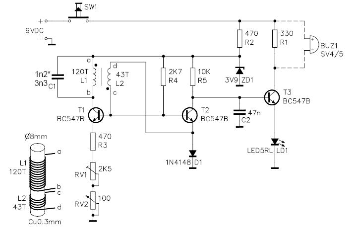

      THanks kt315.
      But, has i understand the below schematic does not belong to Automax.
      My question refers to the schematic show below.
      Nelson
      it is Automax Precision V4 schematic. I have give a bunch of the schematics and all are standart type one like to Automax.

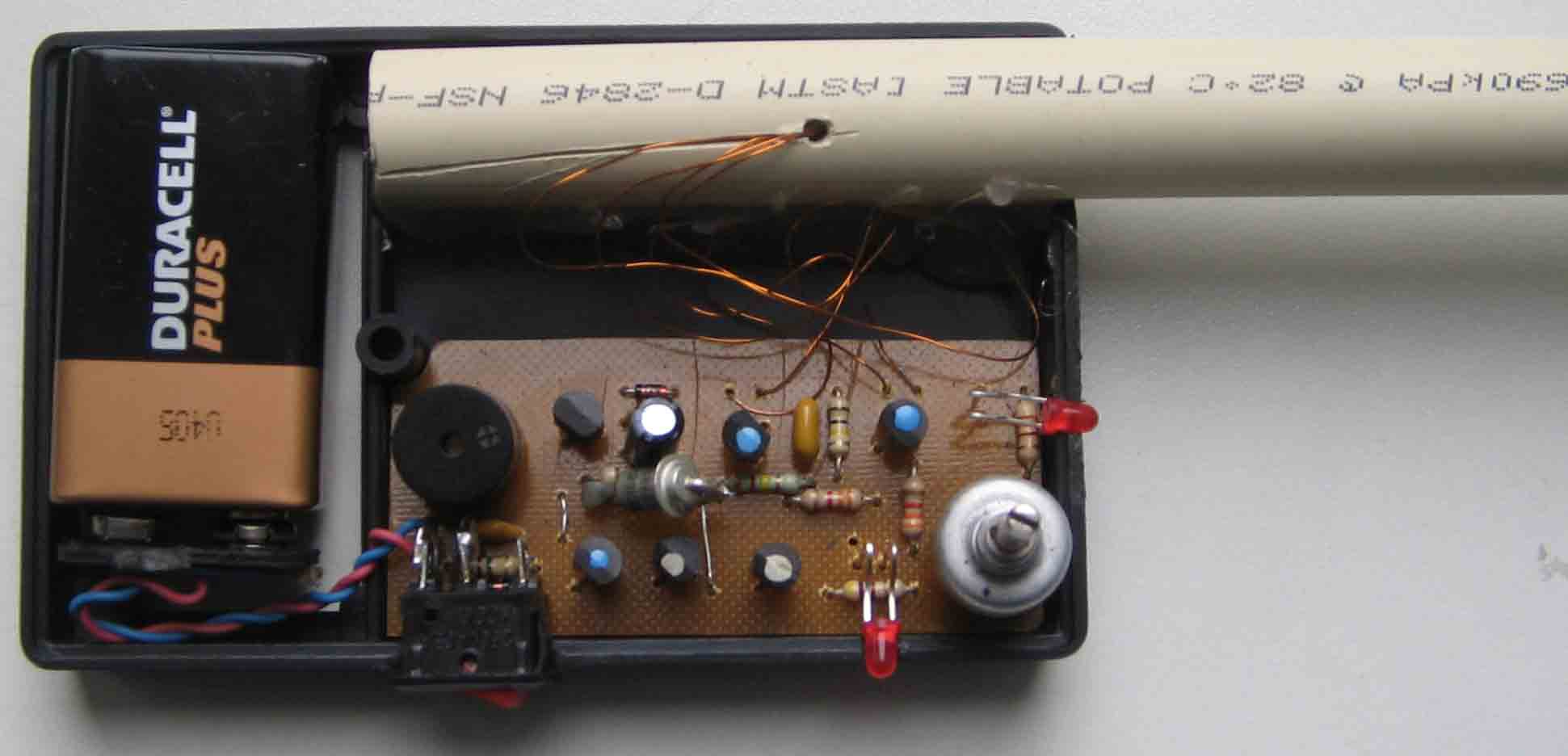

            I had build this pinpointer yesterday and is still under test.
            So far is detecting a 22 mm copper coin at 2,5 cms,; a small screw from his head at 1 cm.
            Now i m asking about the ferrite coil, where i should play to take or put more turns to get more sensitivity, L1 or L2.
            Nelson
