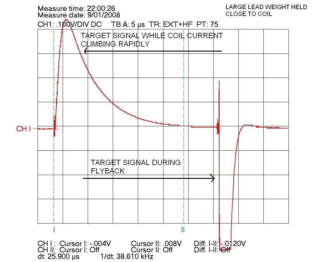

          question
          Aziz in an effort to see where your coming from in regard to the fly back i have a question,
          The attatched scope pic is of a target signal taken straight of the receive coil.
          Setup
          1/2 inch round copper tubing bent into a circle of 18 inches diameter with ends not connected together,used as transmit coil.
          Two receive coils residing within transmit coil,approx 30 turns of wire per receive coil,receive coils connected opposite in phase to cancle out flyback signal.
          12 volts on transmit,45 amps running through coil,max current reached within 10u/s,pulse width 34u/s
          Question
          if i understand you correctly you say the flyback kick starts the eddy currents on the target.
          on the scope pick,at the start of the transmit,while current is rising very fast i get a very good signal on the target,yet there is no flyback to generate this high target signal,are you able to explain why this is so???
          Zed

            • #51
              The Flyback question
              Setup
              Question
              Zed
              This is just what I am talking about. My signal amplitude is about 10 times as high at the beginning of the TX pulse than after TX switch OFF. Using a common IB coil combination.
              Not only that, it also DISCRIMINATES between FE and non magnetic targets.
              What kind of relation of signal amplitude have you observed between sampling during TX ON time and TX OFF time?
              Monolith

                  • #54
                    Setup
                    Question
                    Zed
                    I think it is relative -- there should be a signal while current rising, but a much larger one during flyback. Your flyback signal looks "clipped" in the picture. How far negative did it really go? Maybe much more amplitude than rising signal?
                    -SB
