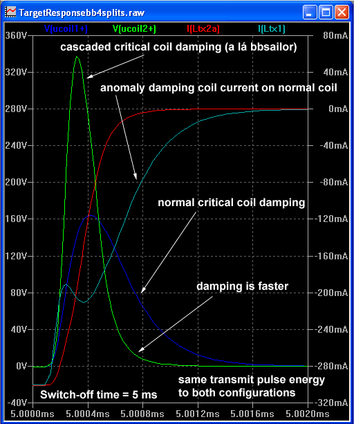

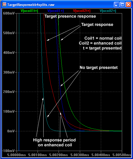

        • #79
          Hi Carl,
          a MONO coil is divided into 4 sections. Each of the parts are individually critical damped. A second standard MONO coil is compared to the first one.
          The coil is driven as usual on both ends (not center-tapped).
          The following picture (1) shows the damping voltages with no target presented.
          The second picture (2) shows the comparison of the target/no-target response.
          It could be useful to find the reason for the anomaly coil current with the standard coil, which delays the decay curve. This is totally absent with the bbsailor's proposal. I am not sure, whether this effect can be measured and verified in a real practical configuration.
          Aziz
          • #80
            I think, the more coil splits with his each individual coil damping resistors are made, the more coil voltage we will have and a faster damping time. The MOSFET will breakdown anyway and will add some delays as a consequence of this.
            It is very remarkable, that despite of the same transmit pulse energy (same coil current, same configuration except the coils) the flyback voltage increases with the splitted coil.
            Aziz

                  Zed
                  Finally, I found the reason for this anomaly:
                  Coils effective capacitance!
                  To test this, I have excluded the switching electronics (MOSFET and Diode) and replaced this with an ideal voltage controlled switch (Ron = 1e-12 Ohm, Roff = 1e+12 Ohm). Then I reduced the normal MONO coils capacitance from 300 pF to 30 pF. I have lower anomalies and faster decay then.
                  The cascaded coil damping method is in this ideal model even better.
                  Interesting result is the Voltage-time-product (see pictures above):
                  The integral U(t)*dt (t->infinite for one pulse) for both damping voltages seems to be equal, in which it represents probably the exposed magnetic energy per ampere.
                  The anomaly effect should be observable in real world. The more the coils capacitance, the better the observations should be.
                  Aziz
