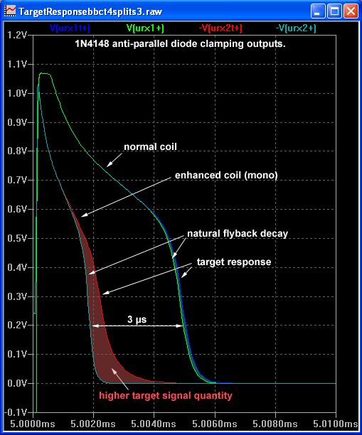

        To compare two different systems with same conditions (same exposed magnetic field energy), the coil current of the system 1 is 300 mA and of system 2 is 600 mA. It is the example of center-tapped coil configuration with splitted PI critical coil damping.
        This example is not posted yet. So feel free to play with it.
        The enclosed zip file is a .rar file. Remove .zip file extension before unpacking.
        Aziz
        • A special single ended version is also possible and omitting the need for differential signal front-end provided that the proposal works in real world (not only in the spice simulation ).
          As you can see, there is huge signal quality available (surface area between two systems with equal exposed magnetic field energy and same targets). Also, provided that 1N4148 will survive high voltages. I will do some high voltage test's on 1N4148 today. If they won't survive, then other diodes must be used. If I don't reply, then probably i haven't survived the test due to high voltage shocks.
          If offers 3 µs early sampling even the diodes are clamping on both systems. The RX voltage is stepped up like a Tesla coil. The high RX voltage is decoupled from the TX driver parts (diode, fet) and exceed the kV ranges easily.
          Aziz

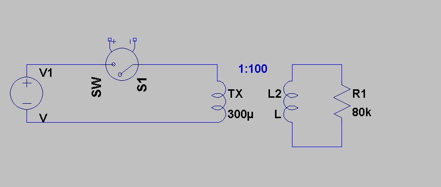

                      • analogy
                        I am wondering how center-tapped, half-driven TX coil is different from analogy with full transformer, like attached image (very simplified circuit)?
                        Forget about metal detectors -- could such a circuit achieve faster decay because of high voltage secondary? Or is there simply an impedance-matching effect where the secondary circuit resistor looks like R/100 to the primary circuit and circuit behaves same as if just primary with R/100 resistor?
                        -SB
