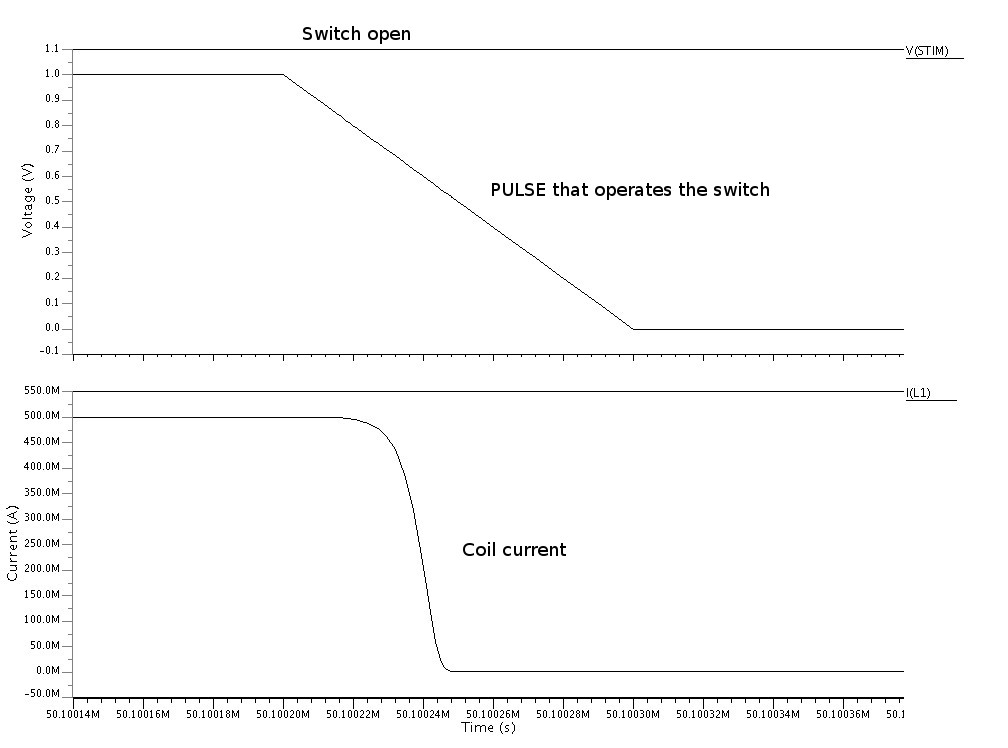

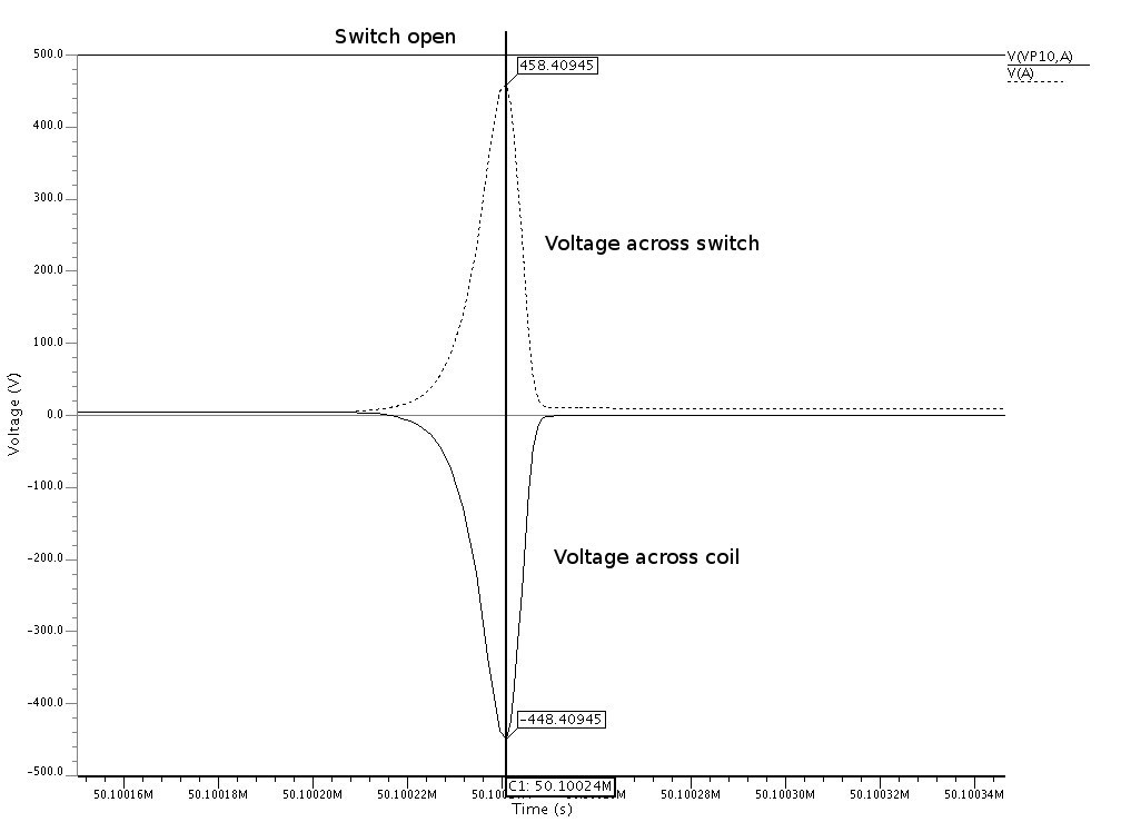

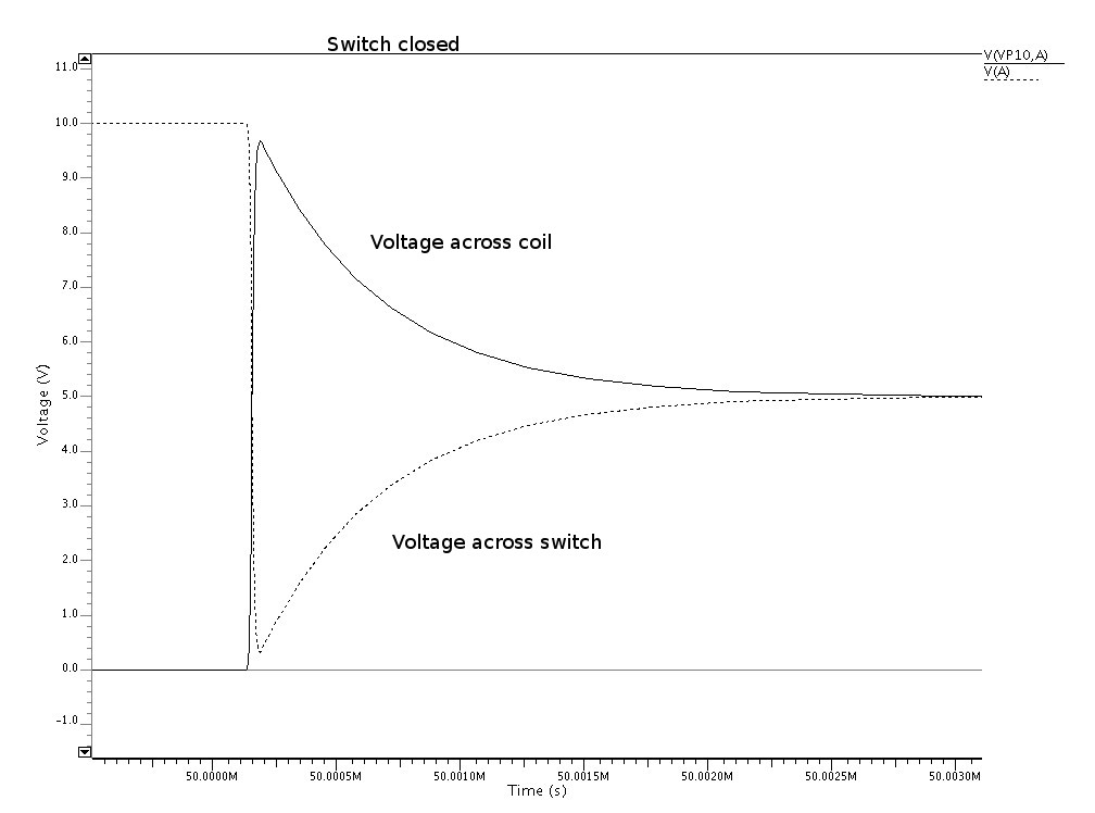

        Let's take an even simpler example than we did previously. i.e. a 10uH coil (with a 10 ohm DC resistance) connected in series with a switch (10 ohm ON, 100MEG OFF), and connected across a 10V supply - see SPICE netlist.
        Plot 1: Switch closes. No surprises here - voltages across coil and switch both settle at half the supply voltage (5V), as we effectively have two 10 ohm resistors in series across a 10V supply.
        Plot 2: Switch opens. There is a back-emf generated across the coil of -448V due to the collapsing magnetic field, and +458V appears across the switch. Note that this value is the sum of the back-emf + the power supply voltage (448 + 10). This has to be the case, in order to satisfy Kirchoff's laws.
        Plot 3: Now this is the interesting one. This shows what happens to the current in the coil. When the switch was closed, a steady-state current was established in the coil of 500mA. i.e. 10V/20ohms. When the switch opens, the magnetic field collapses, and the current in the coil rapidly decays. At no time does this current become negative. Therefore, from Ohm's Law, if the voltage is negative and the current is positive, then the resistance must be negative. In this case, because we are dealing with a coil, it is actually the inductive reactance that goes negative. This simply means that the coil has now become a generator.

                If I understand your water analogy correctly, I think you are attempting to prove that the back-emf is not a negative voltage. This is incorrect.
                If you monitor the voltage across the coil you will see that the amplitude is positive when the switch is closed. But when the switch is opened the collapsing magnetic field generates a large negative voltage (back-emf) in the coil.
                Personally I don't like water analogies when describing electrical circuits. It only seems to be relevant for simple passive circuits.
