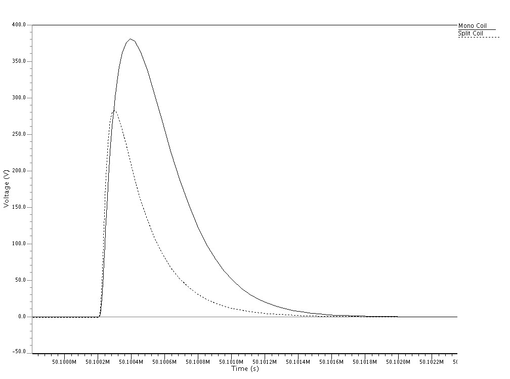

      Hi Aziz,
      I've hacked together a SPICE netlist (without a schematic) as it was the quickest approach for this simple circuit. You will see the parameter statements are implementing the equations that you provided. However, I am not getting the same results you claim to be seeing. Please have a look at the netlist below, and see if you can spot any mistake. The split coil has a lower flyback voltage than the mono.

      • Hi Qiaozhi,
        both systems doesn't expose same magnetic energy due to different current flows of each coils.
        System 1:
        I1 = U/(Ron+R) = 12/(20+2) = 0.545 A
        System 2:
        I2 = U/(Ron+R/2) = 12/(20+1) = 0.571 A
        As the system 2 drives only the half of the coil, it should drive with 2 time more current to the system, to be compareable.
        So I2 should be 0.545*2 A = U/(Ron/2 + R/2) = 12/(10+1) = 1.091 A.
        The switch on system 2 needs Ron resistance of 10 Ohms.

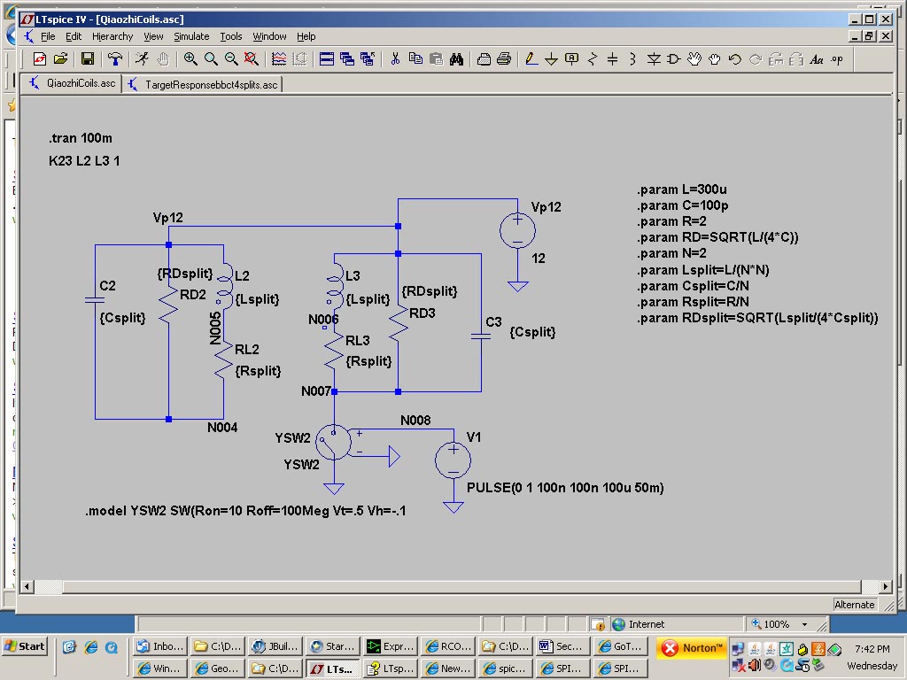

            Hi Qiaozhi - I tried to draw your netlist for split coil in LTSpice.
            (By the way, in mono coil, should switch be connected to node 2 instead of 1?)
            In split coil, node 4 doesn't make circuit -- it floats at 12 volts. I don't get waveform for V(7,4) like yours, instead step up from -1.1V to 0.0 V.
            I must be missing something from your netlist.
            -SB

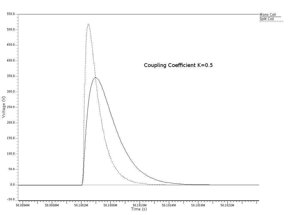

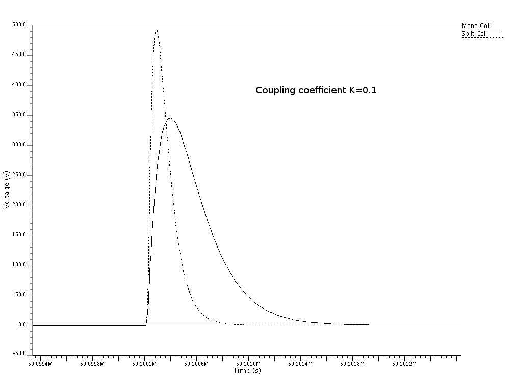

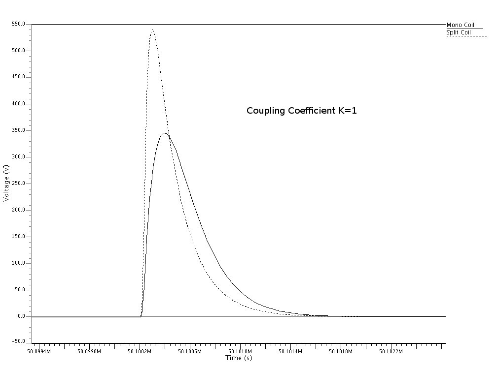

                    • Thanks Aziz. I was wondering whether that might be the problem. Now the results match.
                      Thanks Simonbaker. You are correct ... I accidentally used node 1 instead of 2, although it only makes a small difference to the results. While hacking together the netlist by hand, I typed in the value of RL1 which was next to the node number (2). Doh!
                      I suspect you're not getting the correct output, because your coils are in antiphase. The coupling coefficient of unity means they are cancelling each other exactly.
                      And finally ... the updated netlist is shown below, with 3 sets of results. I am not happy with the coupling coefficient set to unity, and have re-run the simulation using 0.5 and 0.1. As you can see, the waveform settles even faster, but with a reduced peak amplitude.
                      Comments?

                        I forgot completely about coil phasing, thanks.
                        I still don't understand "floating" coil that is attached to V+ at one end and nothing at other (except damping resistor across it).
                        I think you could completely disconnect second coil section and make it a transformer instead of center-tapped half and get same result (without DC bias).
                        It seems there should be another damping resistor that spans both coils to help out somehow.

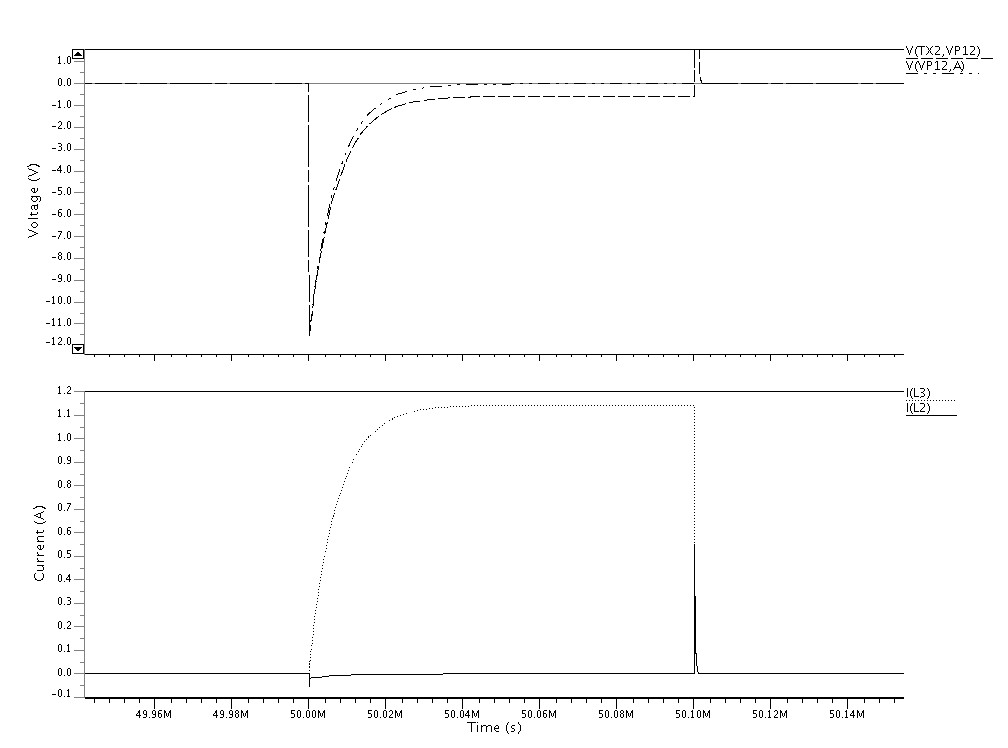

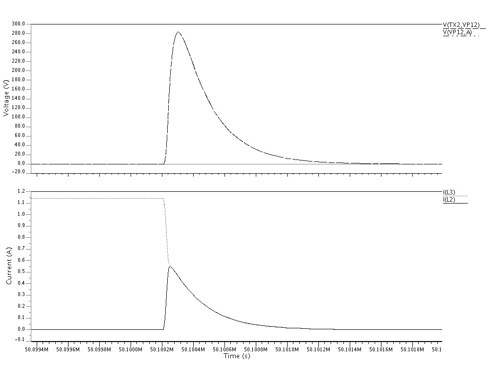

                          Let me see if I can explain what's going on ...
                          With reference to the two graphs below, and the updated netlist.
                          1st Graph - the switch closes
                          2nd Graph - the switch opens
                          These graphs show both the current and voltage waveforms for the split coil configuration. You will note in the 1st graph that the voltage in the lower coil V(TX2,VP12) jumps to nearly -12V and then decays to a value of around -600mV, which represents the voltage drop across the resistance of the switch (10 ohms). The voltage in the upper coil also jumps initially to nearly -12V, and decays to 0V. The reason the top coil jumps to nearly -12V, when it appears to be floating, is because L2 and L3 are closely coupled. As time progresses a current path is established through L3 (the lower coil) and RL3 from VP12 to TX2, which decays to 600mV, but no similar path is available for current to flow through L2 (the upper coil). In the latter case there is a very small current that is dissipated through L2 and RL2, in parallel with RD2. The result is that a magnetic field is established around the lower coil (L3), but the upper coil (L2) does not contribute to this field.
                          Now ... the switch opens (2nd graph) and the magnetic field collapses, causing the current flow through the lower coil (L3) to drop quickly to zero. The collapsing magnetic field also generates a very large back emf across both coils. Again, remember that L2 and L3 are closely coupled, and the coupling coefficient (K) has a large effect on the behavior. The result is that both coils will experience this large voltage from the back emf, and since they are in series, there will be double the voltage across the whole coil assembly. So what's happening to the current? The current in the lower coil starts to decay faster than with the mono coil because the upper coil (L2) is providing a charge path in addition to the usual damping resistor. So the current in L3 is dropping, but the current in L2 is increasing. Once the current flow is equalized, the decay proceeds at its normal expected rate, and both coils will discharge through their respective damping resistors. This is why the damping is faster with this configuration, when compared to the mono coil, as the upper coil provides an additional current path.
                          If you look at the netlist, you will see a third coil configuration with a single damping resistor, instead of two separate ones. The simulation results for both configurations were the same. i.e. no improvement in decay time between the two types.
                            Updated netlist:
                            * PI Coil Simulation
                            * Coil parameters
                            .param L=300u
                            .param C=100p
                            .param R=1
                            .param RD=SQRT(L/(4*C))
                            .param N=2
                            .param Lsplit=L/(N*N)
                            .param Csplit=C/N
                            .param Rsplit=R/N
                            .param RDsplit=SQRT(Lsplit/(4*Csplit))
                            .param RON_mono=20
                            .param RON_split=10
                            .param ROFF=100MEG
                            * Single coil
                            L1 VP12 1 L
                            RL1 1 TX1 R
                            C1 VP12 TX1 C
                            RD1 VP12 TX1 RD
                            YSW1 VSWITCH TX1 0 STIM 0 param: RON=RON_mono ROFF=ROFF
                            * Split coil with separate RD
                            L2 A 2 Lsplit
                            RL2 2 VP12 Rsplit
                            C2 A VP12 Csplit
                            RD2 A VP12 RDsplit
                            L3 VP12 3 Lsplit
                            RL3 3 TX2 Rsplit
                            C3 VP12 TX2 Csplit
                            RD3 VP12 TX2 RDsplit
                            YSW2 VSWITCH TX2 0 STIM 0 param: RON=RON_split ROFF=ROFF
                            * Split coil with single RD
                            L4 B 4 Lsplit
                            RL4 4 VP12 Rsplit
                            C4 B VP12 Csplit
                            L5 VP12 5 Lsplit
                            RL5 5 TX3 Rsplit
                            C5 VP12 TX3 Csplit
                            RD4 B TX3 {RDsplit*2}
                            YSW3 VSWITCH TX3 0 STIM 0 param: RON=RON_split ROFF=ROFF
                            * Coil coupling
                            K23 L2 L3 1
                            K45 L4 L5 1
                            * Voltage sources
                            VP12 VP12 0 DC 12
                            V1 STIM 0 PULSE 0 1 100n 100n 100n 100u 50m
                            * Simulator commands
                            .TRAN 100u 100m
                            .PROBE ALL
                            .PLOT V(TX1,VP12) V(TX2,A) V(TX3,B)
                            .PLOT V(TX2,VP12) V(VP12,A)
                            .END
                            I guess I need to go back to school. I thought back emf was the opposition to an increase in current as a voltage was applied to a coil.
                            HH,
                            Rip
                            • I think in your first split coil arrangement (floating end), you can disconnect the two coils electrically at the center tap with no difference to the behavior, as the coupling is purely magnetic - do you see what I mean?
                              Center tap is only meaningful if you have some return current path in the non-driven coil, otherwise it might as well be pure transformer (electrically separate coils).
                              Is that not so?
                              -SB
                              • Originally posted by UWLocator View Post
                                HH,
                                Rip
                                You are correct. It's the same thing.
                                Back-emf is the electric potential difference that opposes the current that induces it. It is this opposing electric potential difference that manifests itself when the switch is opened. During the time when the switch closes, a magnetic field is established around the coil, which opposes the applied current. You could imagine this being the same as winding up a large spring. It gets increasingly harder to wind the spring. The spring is now charged with potential energy. The same with the coil, although the energy is contained in the magnetic field. Once you let go, this energy is released. In the case of the coil, the collapsing magnetic field generates a current in the coil, and hence a voltage that is the reverse polarity of the initial applied voltage. This is also referred to as the back-emf.
