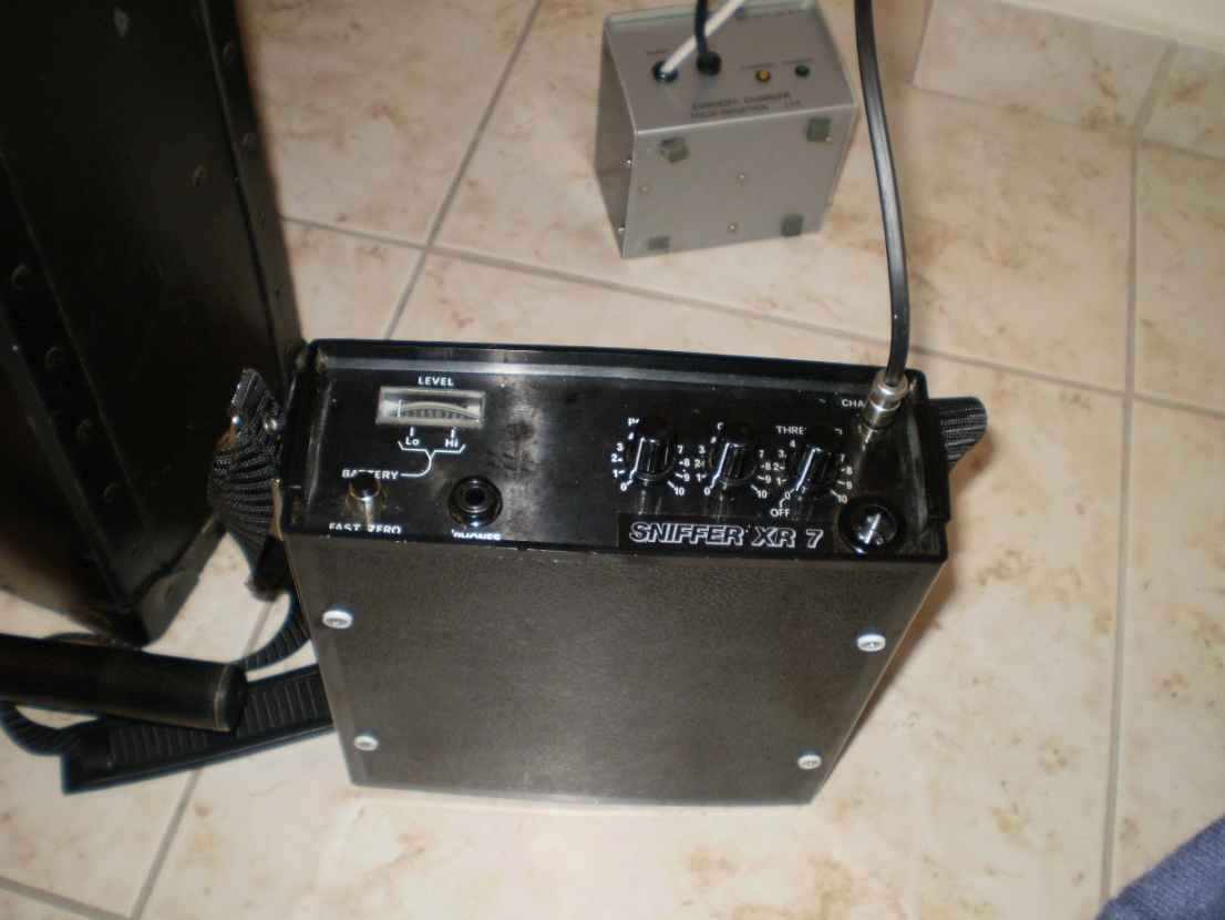

            lorenz...
              XR7is full diferent than XR71. It is other detector.
              XR7 is clone of DBP-2010. Before 3 months i had one.
                For me the max depth has the Superscan from Eric. The detector with original coil (1x1m) can detect a soda can at 1.8 m on ear.
                The Best!!!!
                If Eric read this thread, can tell me about the wire diameter of the coil of SuperScan???
                  E-mail me schematic of XR7 please on MDforALL@gmail.com
                  must to compare... there are differiencies or not... but please do not send DPB-2010 one vice XR7.

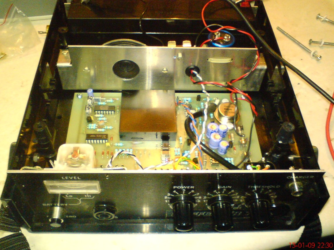

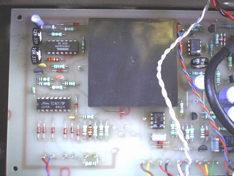

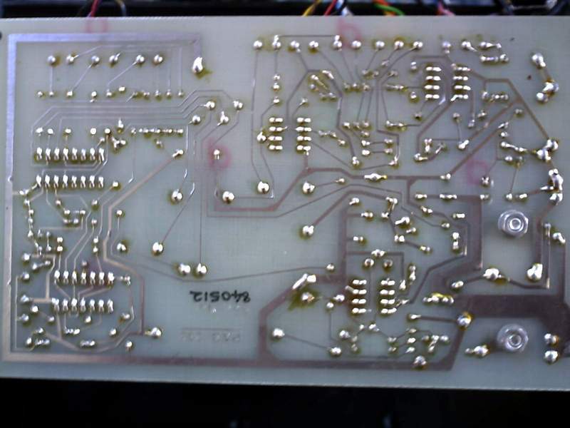

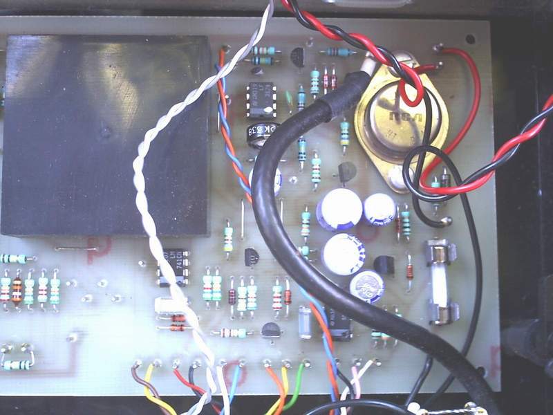

                    Hi KT315.
                    Sorry but i did not reversed the pcb. I attach here some photos of the pcb and the box. Photos was taken by Rospy
                      I forgot the front panel with the model
                        thank all friends
