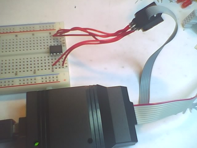

              Hello,I have recently recieved my USB ISP programmer from China,at this stage it has a ten pin cable with header plug,so I guess I will need to make a board to program the Attinys..

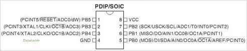

                just program your chips on a breadboard, you only need 6 jumper wires

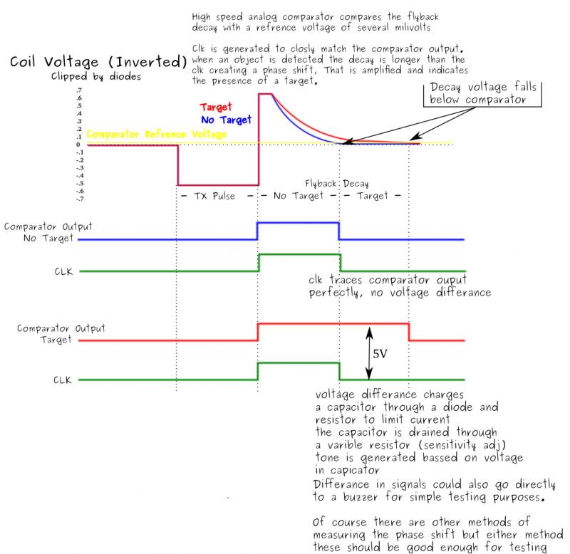

                                convert to analog?
                                I've been looking for sources of noise and I think that the bottom line is that the analog comparator in the
                                atmel attiny series mcu is just not made to do what I'm trying to make it do,
                                I've schemed up a plan to make the rx frontend entirely analog, I will use a ultra highspeed/low noise analog comparator.
                                the tx will output pulses on two pins, 1 to drive the mosfet and another (clk) to try to match the output of
                                the analog comparator as closly as possible, when the two waveforms fall out of phase analog circuitry
                                will pick that up and produce a sound
                                ok enough talking, here's a graphical representation of the idea
                                I'd love to hear any comments on this idea, It's sorta like BFO but using pulse induction
