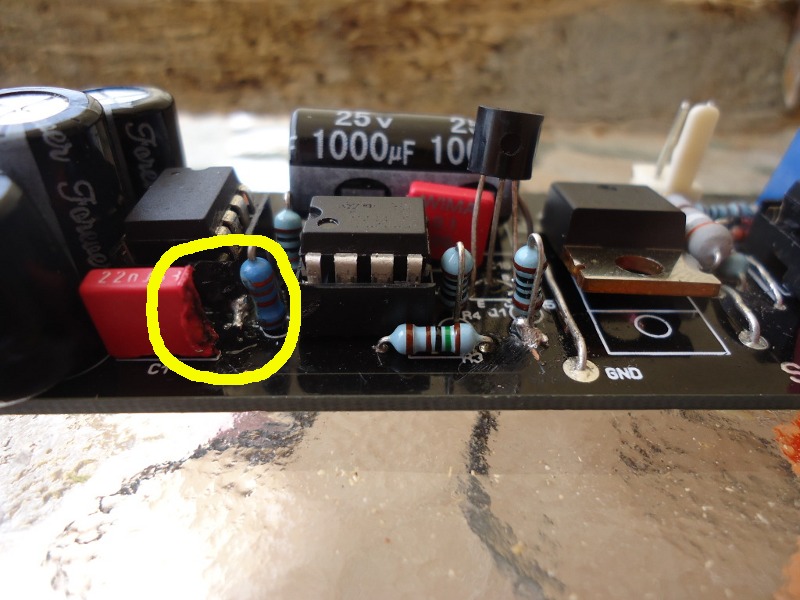

                • #68
                  • #69
                    Is R25 soldered?
                    • #70
                      I suggest you replace C1 and R2, which have been damaged by the soldering iron.
                      • #71
                        Nooo, man. Those dings just add character to the final product!
                        • #72
                          being sarcastic doesn't make you smarter! i was planing to change them, i had no choice, i had to make the soldering on top of pcb where the problem was and then check it with components on to see if its ok, R25 is ok
                          • #73
                            I guess I can never be as smart as you are, or have such a good sense of humor. Oh, well.
