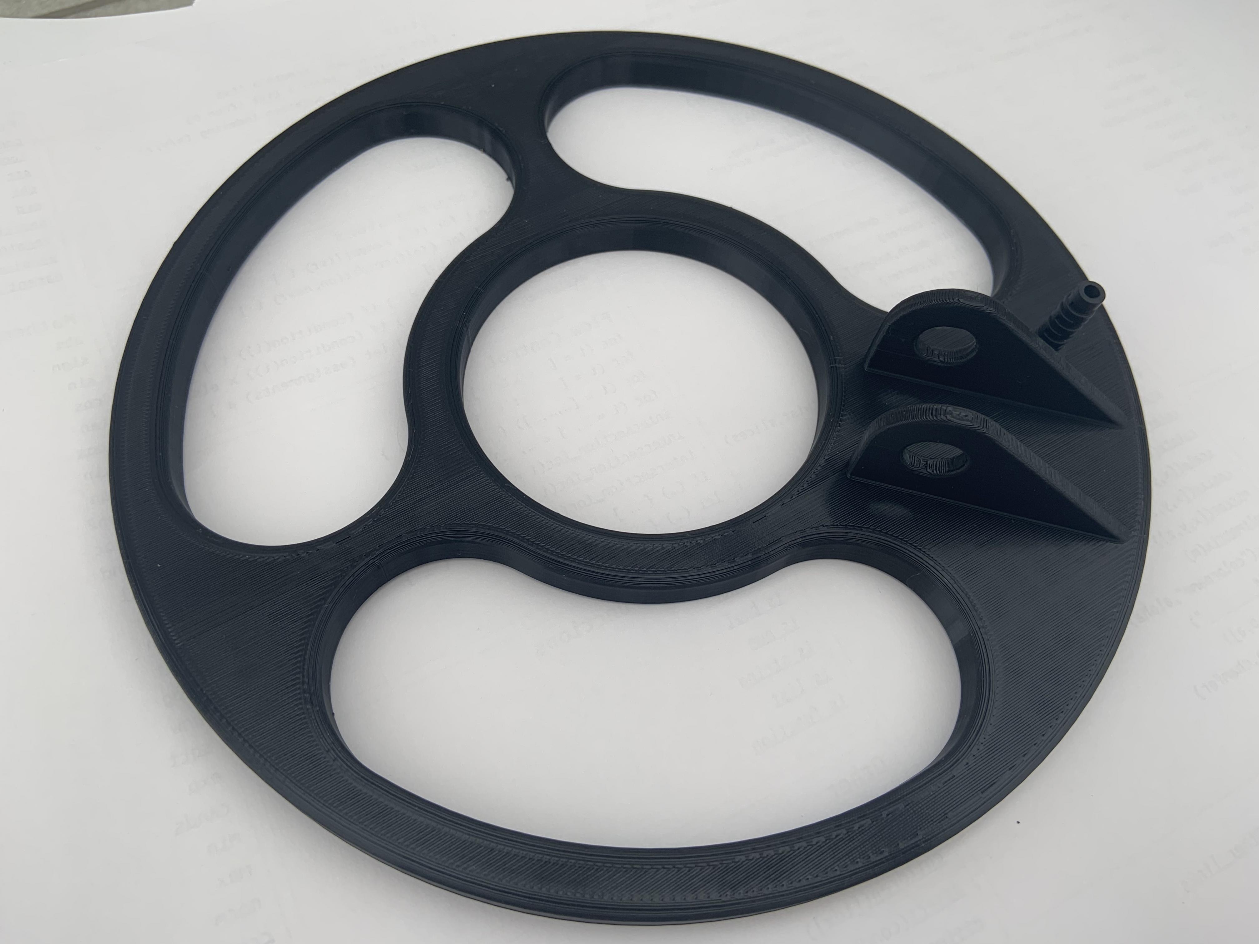

    Originally posted by Op04 View Post
    Ear for coil
    Do you have a 3D printer?
      Originally posted by MartinB View Post
      A bit bulky and too much metal.
      The metals shall be removed, exchange with nylon bolt n nuts. Alternative for ears, can applied before pouring resin.
      No, I don’t have. I put here coz it related.

                      Concentric Coil Experiment from ITMD
                      Page 134 of ITMD gives a really nice example of an 8" concentric coil design so I thought I'd have a bash at doing a 3D print of a suitable former.
                      If anyone is interested I can post the .stl file or the Freecad design file
