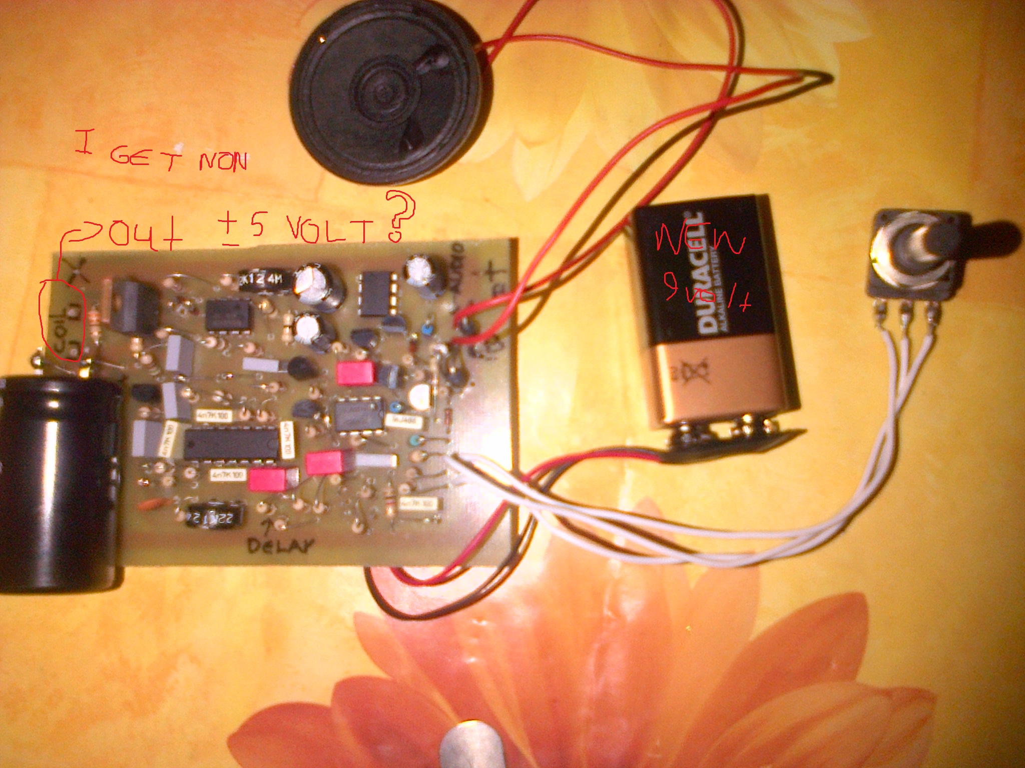

ID:	336761 i get a speaker on ne 9 volt battery i get off the Q5 and no voltage output where there is out for coil either in 7660 nothing only mvolts what i get where i should take +5 -5 volt wilson? tomorow wilson i will get the battery you have 12 volt 1.3 amps.any advise men please .thanks

                [ATTACH]25107[/ATTACH] i get a speaker on ne 9 volt battery i get off the Q5 and no voltage output where there is out for coil either in 7660 nothing only mvolts what i get where i should take +5 -5 volt wilson? tomorow wilson i will get the battery you have 12 volt 1.3 amps.any advise men please .thanks
                Hi
                If you got a full 9V going into the 7760 and only millivolts coming out you have a short so don't put that 12V 1.3AMP battery on otherwise you will do allot of damage, stick with the 9V at least till you get it going correctly.
                1st pull all chips out apart from the 7760 and tell us what readings you have on the 7760 because by doing that you have isolated allot of the build and less chance of further damage.
                Its more than probable that the 7760 is knacked now anyway , what you need to do is find out why?

                    • I replace today the battery with 12volt 1,3 ah and the 7660 get heat I get pin1 5,65 volt pin2 3,5 volt pin3 14mvolt pin4 -o.94 volt pin5 -3.14volt pin6 7.8 volt pin7 9.53 volt pin8 12.05 volt
                      • Wilson the battery stays 12volt
                        • Hello Antonio, this is the 7660 warming a possible short circuit in the tracks, pads or CIS, you should build the barracuda with sockets in the CIS, this would facilitate the tests.
                          Disconnect and check for possible short circuit on the side of the welds, photo "macro" both sides of the plate with the best possible quality and mostrenos the forum.
                          Are you using the IC ICL7660 SCPAZ, already discussed this subject in the forum, it supports 13volts check.
                          • the standard 7660 cant handle 12v it should be no higher than 11.2 or your just creating heat.

                              I use the 7660a-cpaz what about it;iget heat i double check the tracks no circuit
                              • Antonio, try replacing the CI 40106 and if possible install a socket, if the voltage of +5 volts and-5volts not normalize remove the IC NE5534 and check the voltages without it, repeat the procedure also for the IC LF412.
                                NOTE: Each IC socket install removed to facilitate testing and replacements.
                                If these steps do not resolve it is possible that the ICL7660 IC is damaged.
