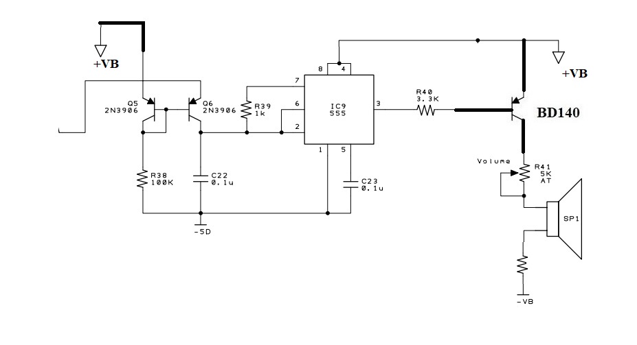

      As you remember, i'm trying to change audio part of HH1 (VCO) for using 8-Ohm speaker. After searching, i copied Technik of the Polones detector (see attached).
      But i have a problem, my audio is muted. What is interesting is that i touch my audio part, its audio is heard.

        If touching the circuit makes a change then something is not right.
        I never had luck getting Carl's 555 VCO working properly. That is one reason I did the PIC12F1501 VCO on my HH2. The switch, two transistor, 555 & amp were replace with an 8-pin PIC processor and code.
          1. If you vary R31 the offset voltage at TP19 should vary. If it does not, something is wrong around IC8b.
          2. The base of Q6 should be -0.8V and the emitter should be 0V. If they are not, make sure N7 is high.
          3. IC9-pin3 should have a rectangular waveform on it. If it does not, something is wrong around IC9.
          4. For more volume you probably want the speaker on the collector side of BD140, with the emitter grounded.

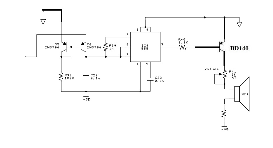

            Please see attached, is your mean this?

              Yes.

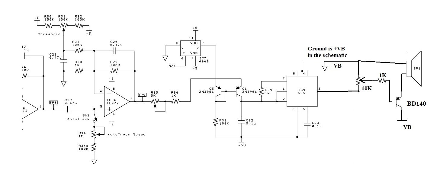

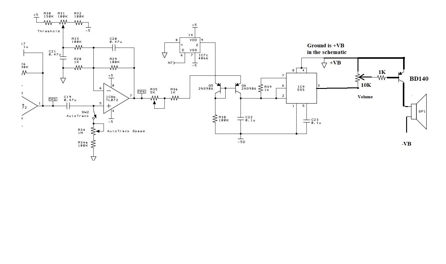

                            I did a lot of trying, but i couldn't solve my audio problem. According to your advice, i added fixed resistors + Vol pot in series speaker but my BD140 is still hot!!!
                            I tested it with 4R speaker, it made no difference. I measured DC voltage of TP9 via threshold pot, that is -0.6 to 1.2V!

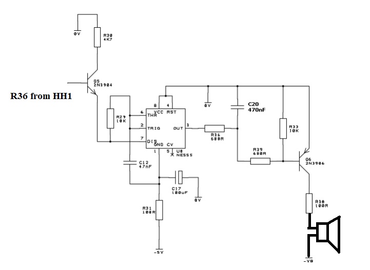

                            For more testing, i built Mr. Walter audio+BD140 (attached), it works but sensitivity of my audio is low (i think i should increase Gain of IC8b from 100 to 200).

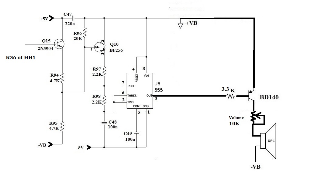

                            Now, i'm going to build MiniPulse audio, i hope it works (attached).
