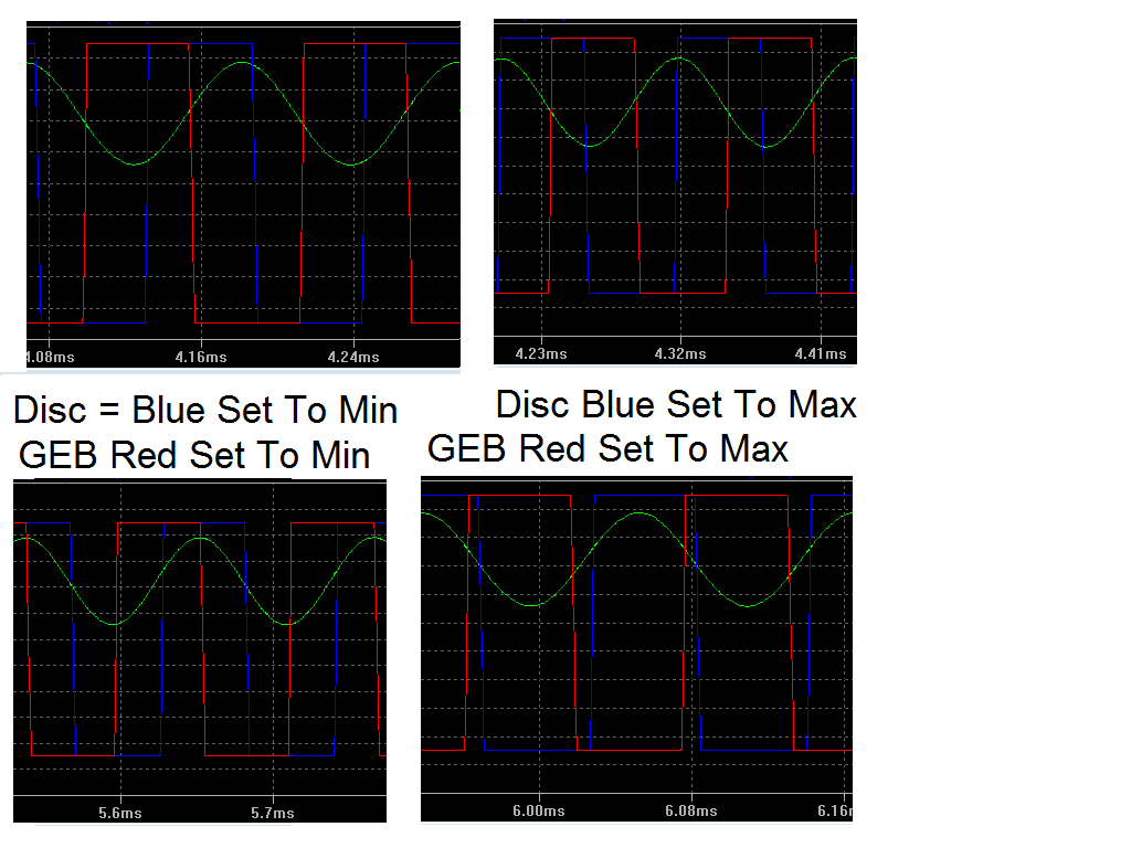

                            Well I still have a LF353 there but might remove it and put the diff input with the TL072.
                            I'll fix the schematic on the next go around.
                            I have the sim of the phase network and a picture of min and max GEB and Disc.
                            It looks great! 270 degrees of control. I probed my Tracker IV and found they are using 270 degrees too...
                            • #59
                              Actually it is just over 90° for GEB, and just under 180° for Disc, but that covers all the bases.
                              The third control would be just for a ferrite and it's span would be under 20°, yet it would accommodate for a wider choice of coils, and it would require a separate channel. Without it you still have a functional GEB, and on salty beaches iron gets detected as with a coil in counterphase. Sounds a bit odd, bot works nevertheless. The third channel is not essential for detection on beaches - you get used to the odd sound of iron.

                                Ahh I see, I meant 270 degrees of span. I thought to ignore salt we would need to
                                notch 20 degrees out of the top and bottom of the sine?
