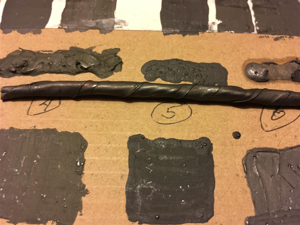

                          The piece of foil I used was about 5x10cm, oki I'll try as you said, but I want to ask how exactly you shielded your coil?, did you mix the graphite powder with epoxy and put it directly on the coil?, or you wrapped an electrical tape on the coil and then you wrapped a naked wire around the tape after that you installed the mixed powder,right?
                          • I mix graphite power with polyurethane (a finish for wood) in a ratio of 1 part graphite to 2 parts polyurethane by volume.
                            I mix a small batch and paint on a piece of cardboard to test conductivity. When dry getting resistance of 200-700 Ohms on DVM leads about 1 cm apart. I tested many paints and glues to mix with the graphite and found polyurethane worked the most consistent
                            On the TGSL coils I first wrap with electrical tape. then wrap a spiral of thin bare wire at about 2cm spacing. Used wire wrap wire with the insulation removed. This is tinned 34 ga. Be sure to leave enough extra to connect to the cable ground.
                            Then paint on the graphite/polyurethane mixture. Last is another layer of electrical tape.
                            This is close to what the Russian guy's TGSL video shows.
                            Test patches and sample wire.
                                [ATTACH]49667[/ATTACH]
                                Is the polyurethane oil based ?
