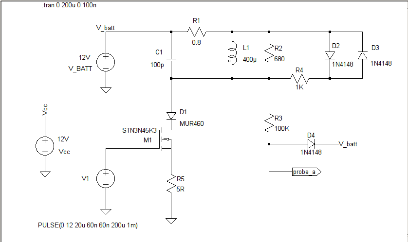

              You will notice a radical deviation from the target of 50% duty cycle, which was the aim of my design.
              Now I propose a BRAINSTORMING to add discrimination to the design.

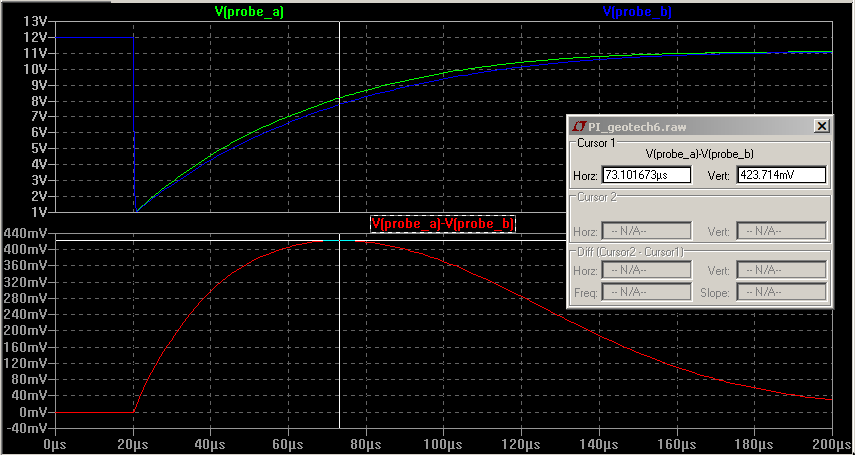

              Let's what happens to the voltage at the coil when the target is magnetic and chages the inductance of L1 by 10% from 400uH to 440uH:
              We see that if we sample the ramp-up voltage at about 70us the difference between ferrous/non-ferrous is 400mV. A change of 1% in the inductance would give about 40mV.
              We can sample this voltage and pass it through a differential integrator with two time constants (slow and a fast) to detect this change in L1, indicative of a magnetic target.

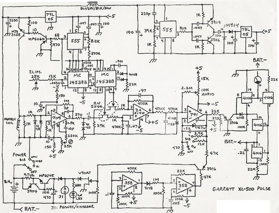

                              garrett XL500,
                              don't think ive ever seen the schematic for that,
                              if you have it available could you post so I can look ???
                              • Originally posted by DOOLEY View Post
                                garrett XL500,
                                See attachment.
