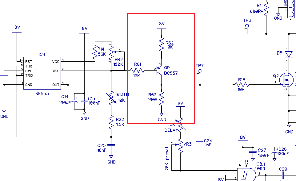

                  • Additional parts might be needed for the oscillator part, what do you think?

                          Hello eclipse
                          I doubt that the "extra" work circuit that produces phase reversal.
                          Could work if the signal is taken from the emitter of the BC557, because in this case no investment ...
                          Jose
                            [ATTACH]34594[/ATTACH]
                            A few questions Eclipse. What are you trying to accomplish with this mod? if you use the NE555 ( bipolar version) it should be able to adequately drive the MOSFET directly. In this mod you are driving from the discharge pin rather than from the output pin is that you intention? That could have unintended consequences if the variable capacitance of the MOSFET modulates the pulse generator.

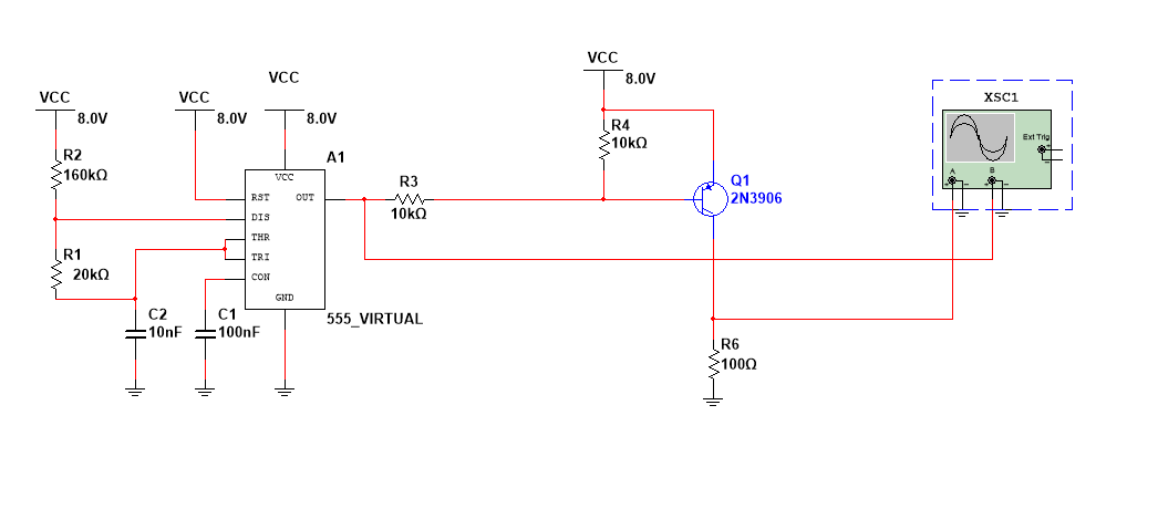

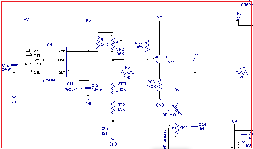

                            • Don't mind this attachment where discharge is connected and not the output (I did that in a hurry and didn't double check to see it).
                              Next post I've corrected it - (View correct post)

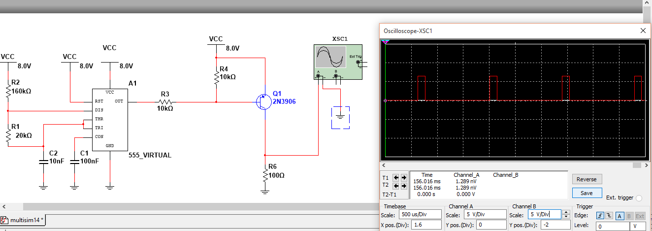

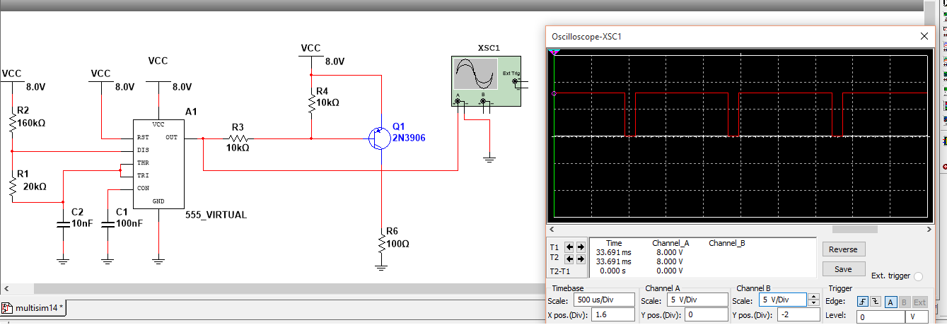

                              I did a simulation of the output of 555 and the simulation showed that that the signal output is inverted
                              (instead of the FET being turned ON for 70-100uS it will be OFF) which if it's true will smoke out the Mosfet immediately.
                              The simulator is Multisim Blue 14.

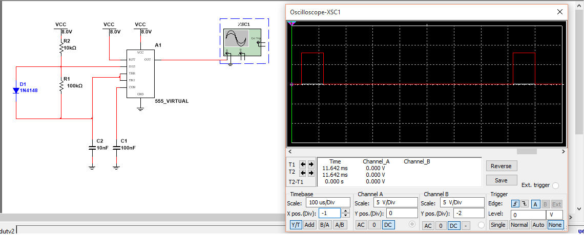

                              • To reduce duty cycle and with less modifications on the board perhaps installing a diode and playing with the adjustment trimmers could be sufficient.
