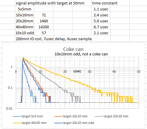

    • Interesting thread. Reply#9, (sample rate, 200pps) (gain, 10,000) Reply#576 has gain at 2000. Not a big deal but how do you calculate gain? The amplifier has a 5pf cap and a 1 meg resistor in the feedback(32kHz cut off) 10 volts p-p at 32kHz has a slew rate of about 1 MHz. Does it need 50v/usec slew rate? The low sample rate and low amplifier cut off frequency goes against what a lot of the other threads suggest. The detector seems to be working fine, so I'm interested in understanding why. I've charted a lot of different targets in the past. I'm wondering if we can select a few that would be available to all to use as test targets. I charted some cut from an aluminum coke can plus another cut from a different can. The odd can didn't chart quite the same, so I'm not sure what to suggest for targets. Some in the low time constant range would be good. I like the 10x10, 20x20, and 40x40mm aluminum can plus maybe a coin or two. Time constant data from a smaller diameter coil.

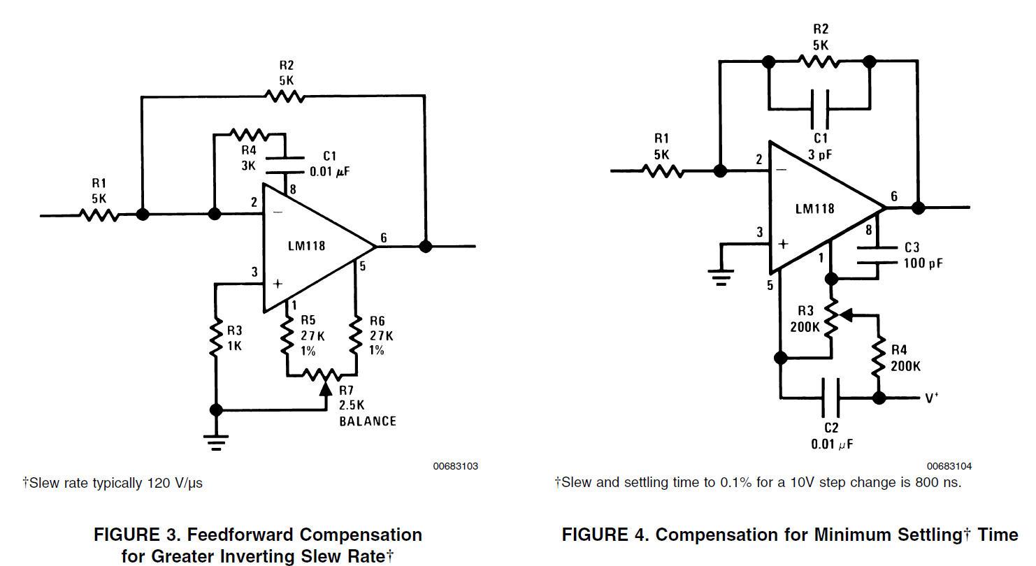

              • lm318?
                +an222, bcm847 instead of lm394
                see also an006831
                • Originally posted by ppodg View Post
                  lm318?
                  see also an006831
                  Yes - the LM318 has a GBP of 15MHz and a slew rate of 50V/us.
                  In fact there is an LM318N on the Farnell website [146-8915] with a slew rate of 70V/us.
                  I put an LM318 model into the simulation, and it looks like an excellent replacement for the LF357.

                            sorry - i've missed it... but look at figs 3&4@an006831
