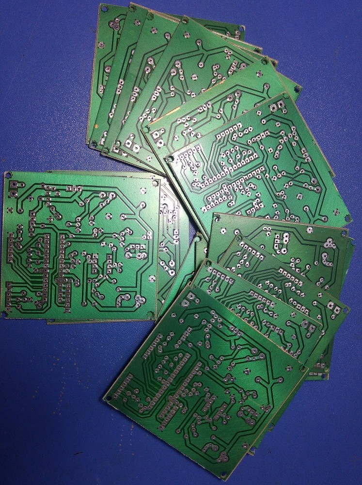

            • Felezjoo Pi Pcb

                • I do not know but İvconik pcb 2k2 for r5 and original document 2k2 .
                  if it is detecting 1 euro at 40 cm with a 30 cm coil like mine not problem
