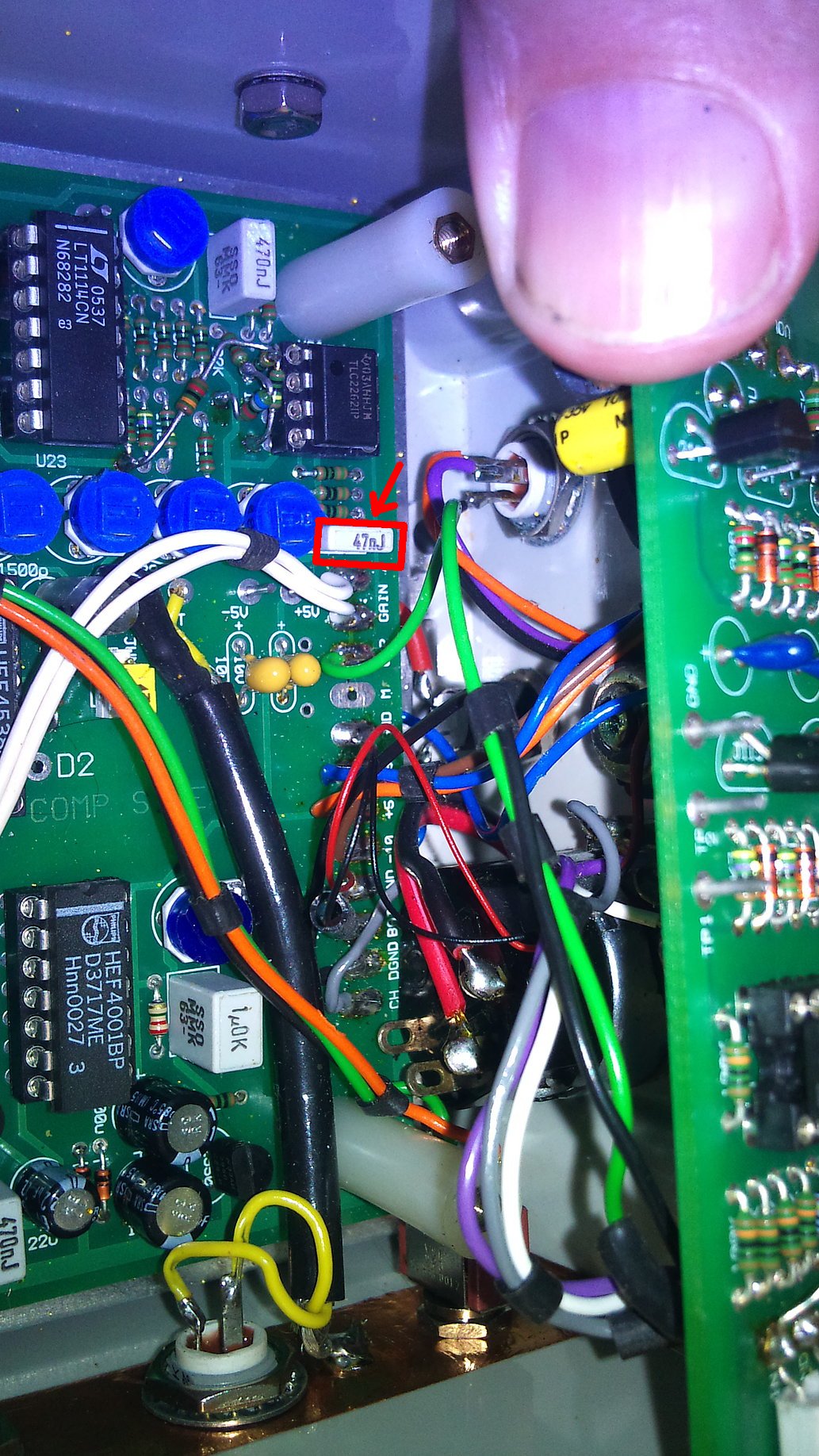

              U2A - the resistor between leg 1 and 3 must be 47K. The op amp UA2 is TLC2262. The capacitor between leg 1 and 3 (100nF) is 47nF
              Integrator inputs are wrong.

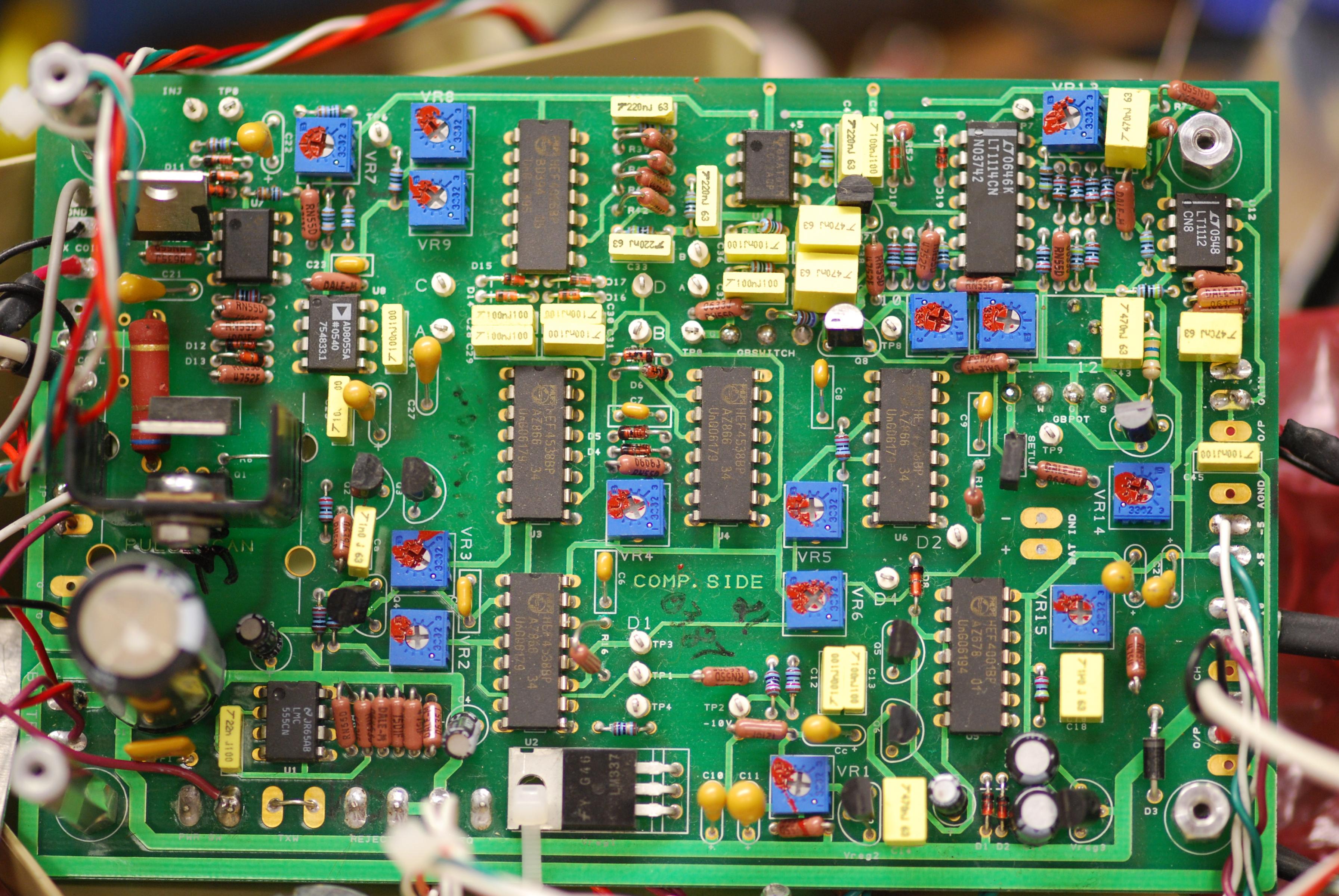

                How do you know do you have the same circuit board in front of you?

                  • Look here, at least thats on original GS5.

                        • Eclipse is correct about the integrator inputs reversed. The integrator is a TL062, the next 4 amps same page are a quad lt1114. The audio gain stage is a LT1112. A quad TL064 is used for the absolute amplifier with one of the amps unused. I drew this for reference not to clone. If people find something they question circle it on the schematic and post. I will try to verify.
