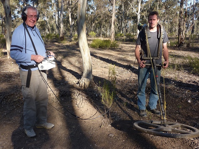

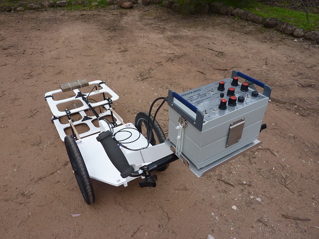

                          The true GS6 was developed 5 years ago. Two versions made, although the lighter one was never completed. A bit different to the GS5 as it used the lapsed Paltaglou patent. Worked just fine and excellent GB but ran out of time to continue. The differential coil set-up was to cancel emi, but I found that it was not really necessary. Still have both and still no time due to a long legal battle on another matter. We won the case so it is now costs and damages to sort out which will take another year.
                          I'm trying to recover GS5 data, much of which was on a computer HD that failed, so watch this space. One bit of info to get the ball rolling - the minimum sample delay was 10uS; all sample pulses are 15uS and the delay from the end of the 1st sample to the start of the GB sample was 5uS.
                          Eric.

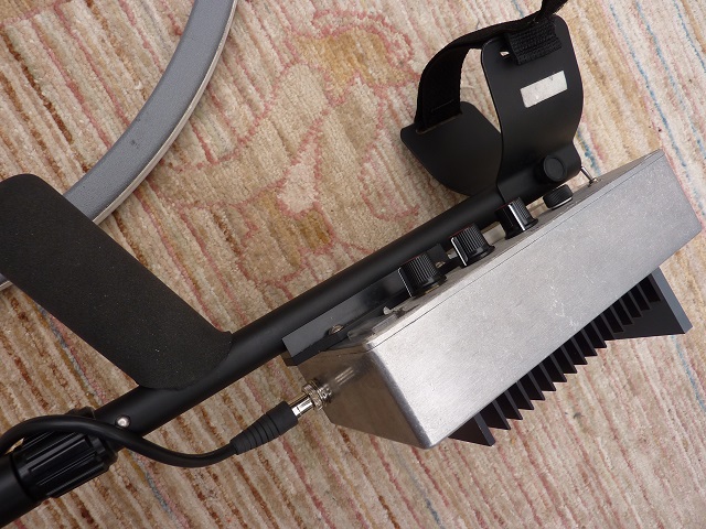

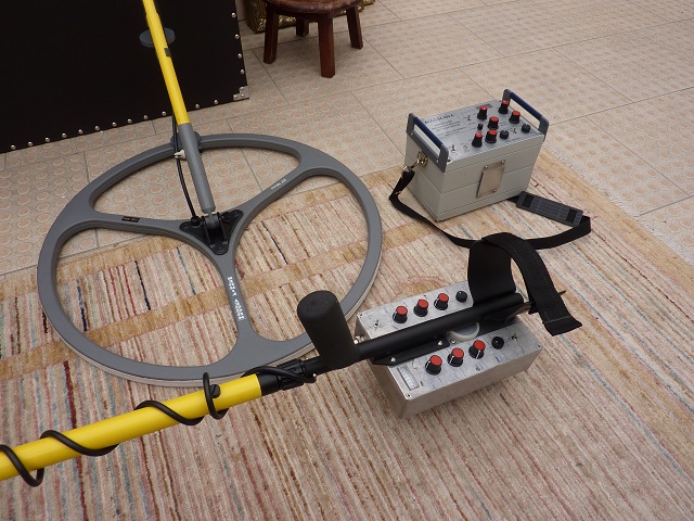

                            Hi Eric....Is that a gs6 in the last photo with the tdi pro top section ??? that looks amazing detector !!! does it have the same power as the bigger boxed gs 6 ???

                                Hi Dave,
                                Yes, it would have if I completed it. The big box GS6 has an inlet air filter and an extractor fan to keep the internal heatsink on the TX down to a reasonable temperature; and of course the rest of the electronics. The one in the foreground has a large heatsink under the box.
                                Look out for a PM.
                                Eric.
