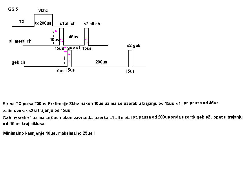

            • Hi Orbit
              i think the TX is between 100 - 120 uS
              • No error with tx 100us but not bad a little more energy tx 200us .
                • Hi Orbit...how much total circuit current you drawing from the batteries at 200 uS TX ??? surely at 200 uS you will loose some depth on small gold.
                  • A TX of 200 us, is not possible at the frequency of 3200, 3300 Hz, because the sample pulses of channel 2 are superimposed with the next TX pulse.
                    Also the power consumption would be very high.
                    Jose

                            • Hi All,
                              My original GS5 had a current limiter originally using a couple of transistors and later the 337T negative regulator wired as a constant current device. This was largely so that you could use other manufacturers mono coils that had a much lower resistance than the ones I made. This limiter kept the mean current at 600mA whatever the weather.
                              Eric.
