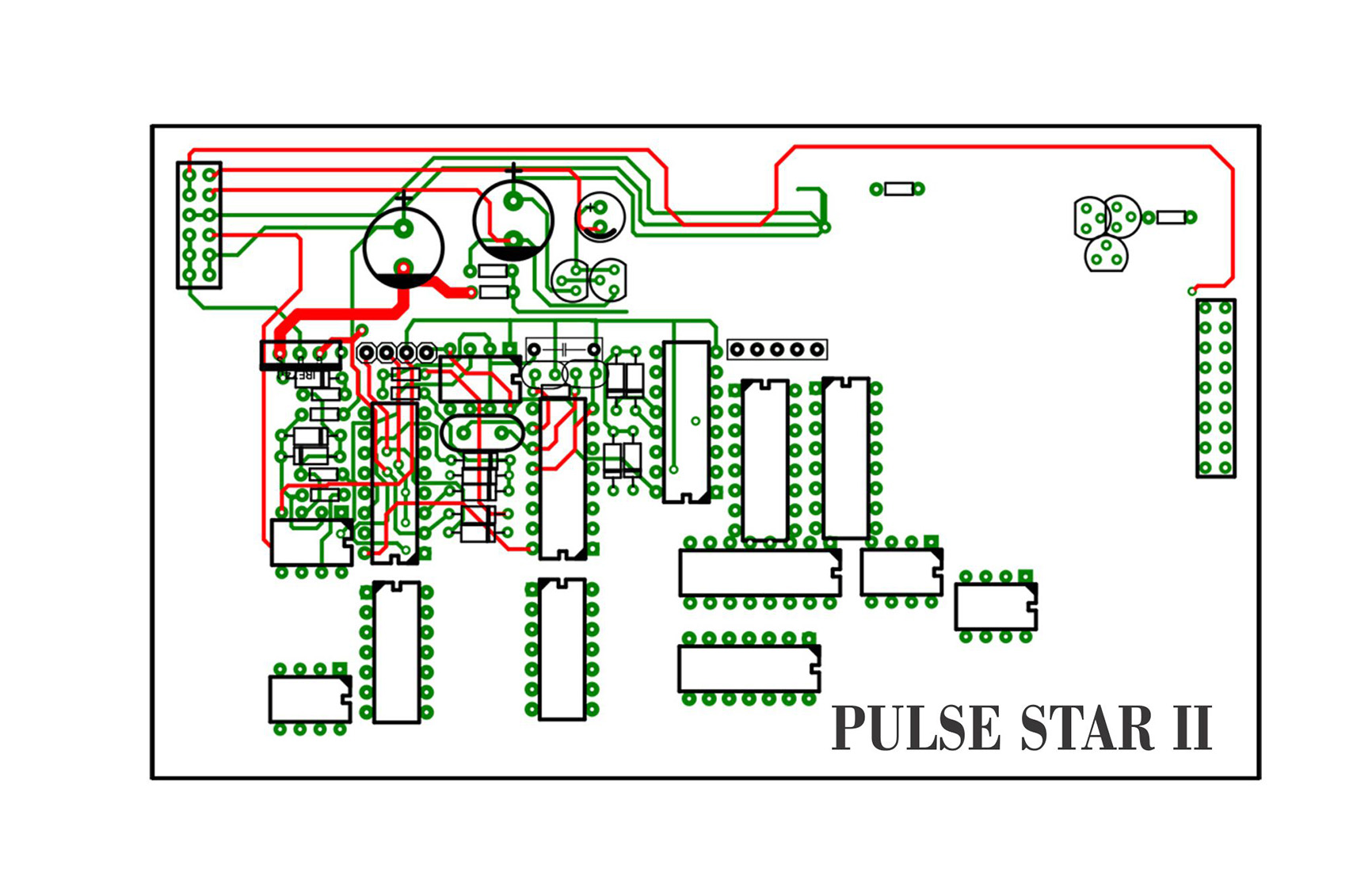

                              Good Morning. Checking the forum. by the way, it is a site to nourish yourself with knowledge of people with experience in electronics.
                              I also know about the subject. I always like the challenge of good projects which I admire. But it is not for negotiation. nor profit from these projects. I do it to have an experience and you know how it works that many times it was difficult for me to do, but not impossible. This time I will do this detector. PULSE STAR II (original) seemed like a good stable detector to me. anqu? is old and its creator made another digital version. but the PULSE STAR II. There is little information on the net. Search everywhere, finding very scarce data and photos. I require all the data to continue continuing to see if you help me. With data such as diagrams photographs. Etc etc.
Name:	PULSE STAR II.jpg
                              • #90
                                Hi, some parts in the image do not specify their code. Can you specify their code?
