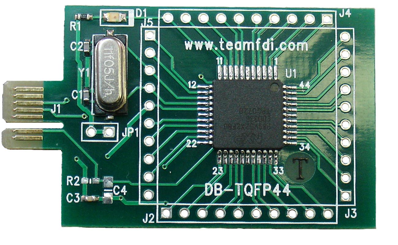

                Originally posted by Daxxin View Post
                Hi
                with or without usb port i guess no need usb for this case ..right?
                have seen TQFP 44A to quad dip adapter on ebay around 3 euro maybe useful to program swapping from main board
                Probably you mean this:
                This is one way how to programming and upgrading XMega (via USB) and then incorporate XMega on "DIP" board to KROT2 PCB.
                But you need to redesign KROT2 PCB to suit your "DIP" adapter on,
                or resolder XMega for soldering in alredy designed KROT2 PCBs (later is not upgradable solution without programmer).
                Otherwise you need USB to connect your AVR programmer to PC and then programming XMega32 directly on KROT2 PCB.

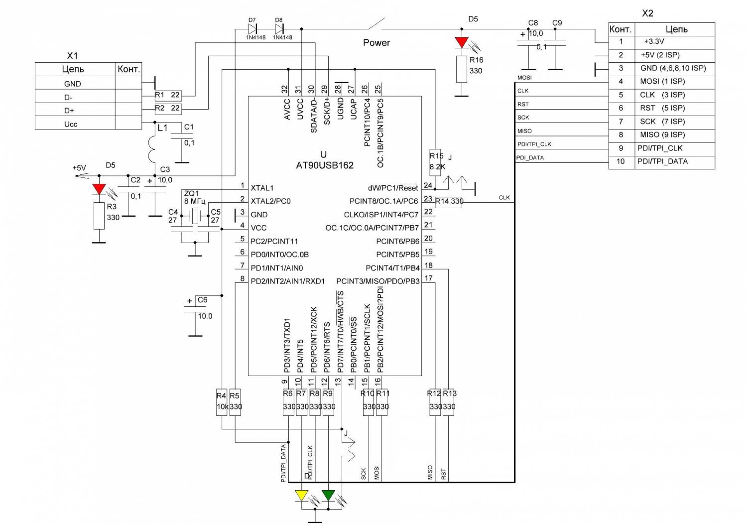

                  The archive to correct the printed circuit board from the TCB and a list of components. Here's a link to the USB programmer "AVRISP mkII" http://radiodom.ucoz.ru/index/usb_pr...klon_quot/0-16 They will find the circuit board and software.Click image for larger version

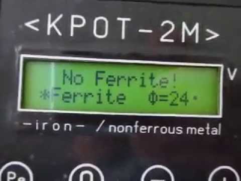

                    Video on KROT-2 tune-up settings:
                    Note: The "auto-balance" without deeply understanding of its functionality is not to touch. Put A = 0.
