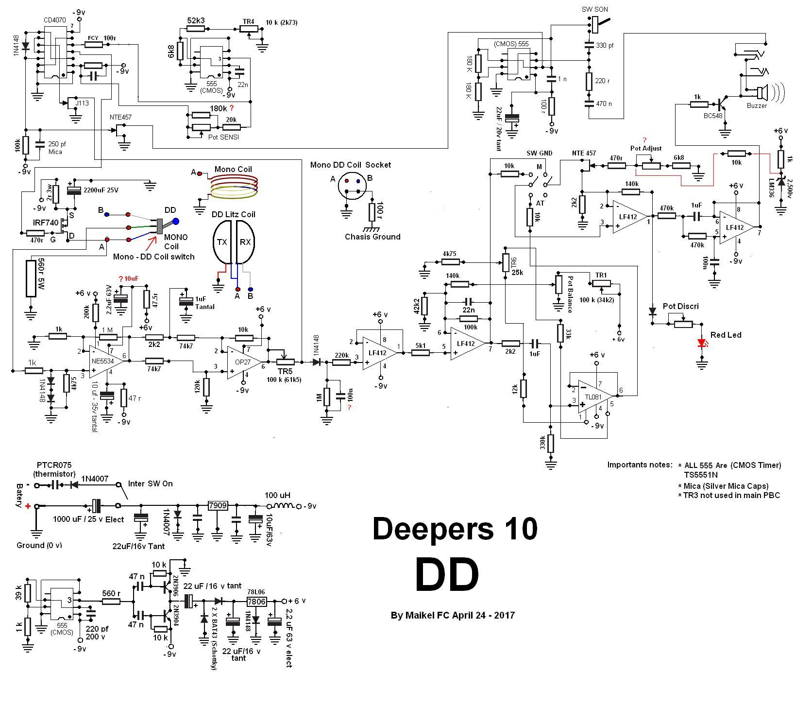

    Much better my friend if you have PCB file..

      I think I got this one form KT315, i don't know if it is correct..

                This is a new revision of Deep10 DD some resistor and cap values corrected and new. I am working assembling a Deepers 10 board from the begining, when is done and working I will post all details here.
                All I need now are the potentiometers values to have total full schematics of this PI. For now I will test with Deep X5 Pot values.
Name:	Deepers 10 FULL.JPG
