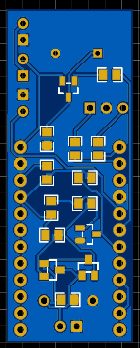

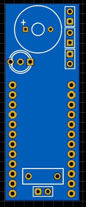

          • My pcb design for Arduino pro mini board, If you are Interested I will public It.

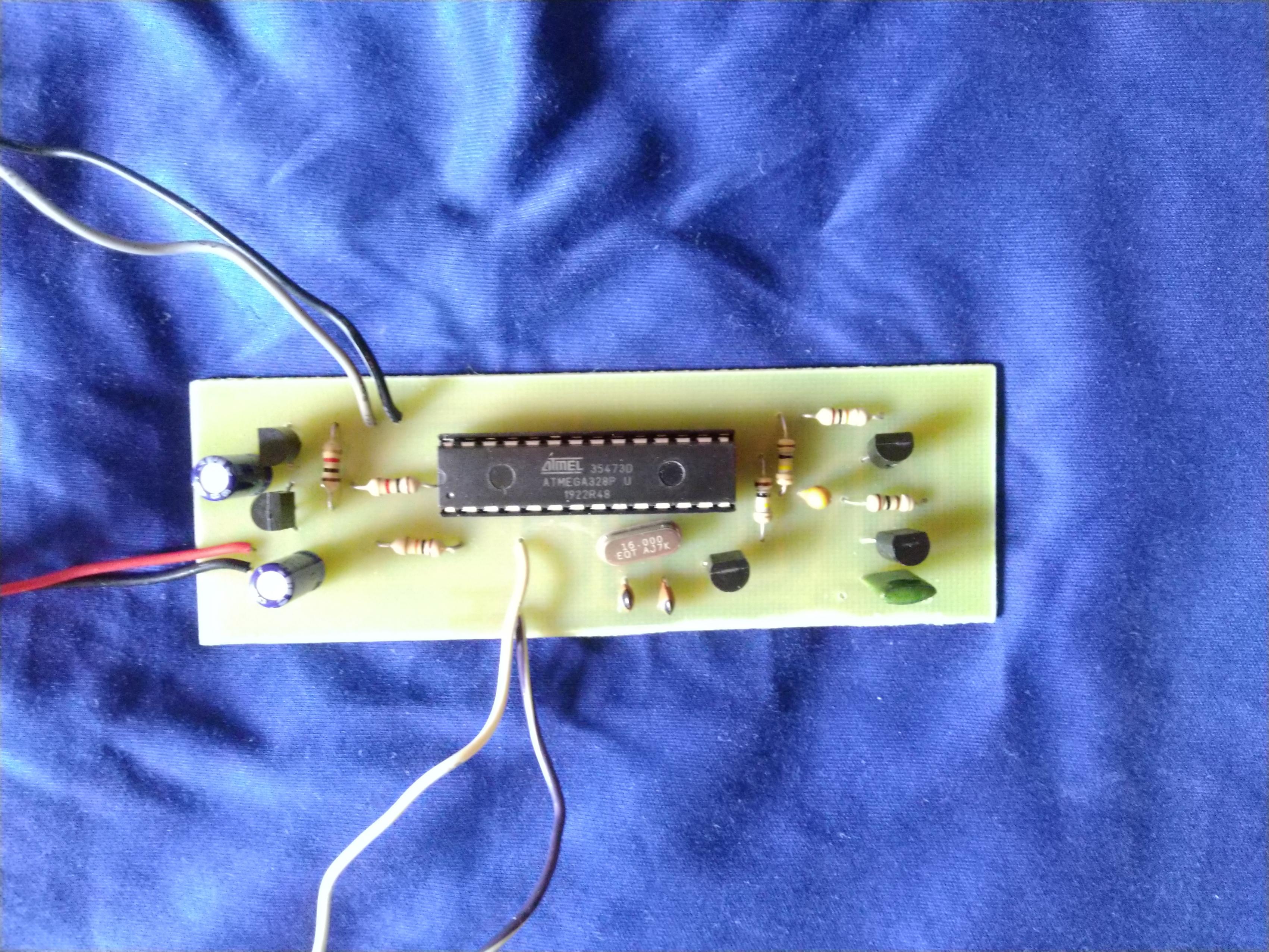

            • Finished and working! Thanks void118
              Today I try firmware 1.51 and build definitive coil
              note the crystal sideways, like the hole I made

                  • the circuit works but there is a problem, the buzzer heats up a lot and, approaching it to the ear, it hums slightly, so I checked the amperage of the circuit, result 700ma.
                    disconnecting the buzzer the circuit consumes 28ma.

                      Hi, check your PCB, my circut consumes 15mA In silent, and 29 mA when detecting target.
                      It looks like short circuit In the board.

                          Thus, the problem Is In your sound circuit, try to connect simple 16 Ohm speaker without 1k In parallel.
                          • Look, In silent mode , when device don't see target, sound transistor Is strongly closed, and It opens with PWM pulses when target comes up, If your buzzer Is not working correctrly, we can see short circuit effect. Show your buxxer please.
                            • Check your pizeo buzzer with multimeter please, It must behave like capacitor but not like resistor.
                              • with detached buzzer 28ma without detection
                                30.5ma with detection
                                with connected buzzer 700ma without detection
                                800ma with detection
                                the buzzer on the capacitor marks me 47uf and 45 ohm on resistance
                                however the buzzer is passive, powering it directly does not emit any sound
