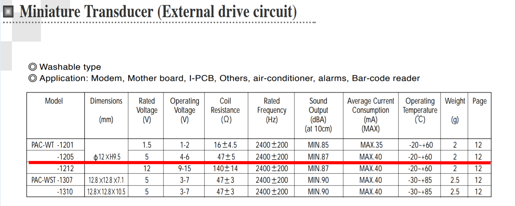

      • the buzzer is pac-1205

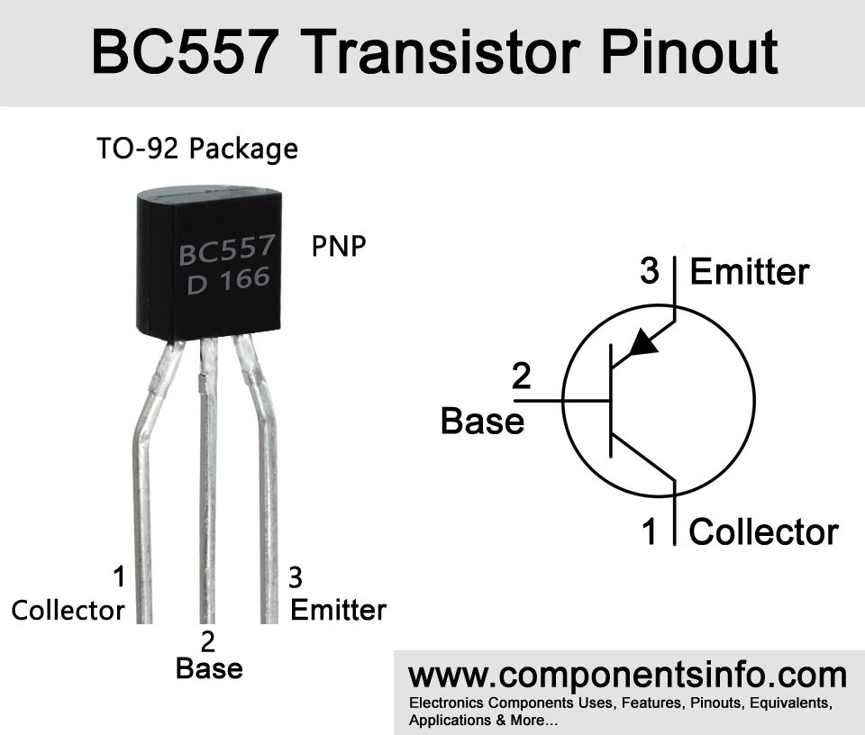

            PAC-1205 It't not piezo buzzer, It Is electromagnetic transducer with 6V max. supply, It Is first, and second when you detouch base transistor from sound I see normal consumption.
            Conclusion - you have misstake with your sound transistor connection or It's not working properly. Check your transistor please, see In attachment.
            Connect emmiter to 5V Instead battery, remove 1K parallel resistor from your transducer.
            I hope you are using BC557 In the sound circuit?

                i use bc557 and i tried another one with the same result, now i try to connect emitter to + 5v, i will let you know if i solve, pac 1205 i was convinced it worked at 1 also at 12v, i had read it somewhere

                  Ok, just check your BC557 with multimeter, but such consuption Is abnormal, look, I found datasheet for your tranducer:
                  http://www.fastelettronica.com/PAC_BUZZER.pdf
                  • 12V Is too much for It (twice) and It has big coil resistance, try connect In series to him 1k resistor please.
                    But first check your BC557 with multimeter please.
                    • BC557 max. collector currend Is 200mA, of course It will heating up!
                      It will work nice In generator but with such tranducer we should limit collector current to 30-40mA by placing current limit resistor In series.
                      • I solved it, thanks for the help, all because I had read an incorrect buzzer data sheet.
