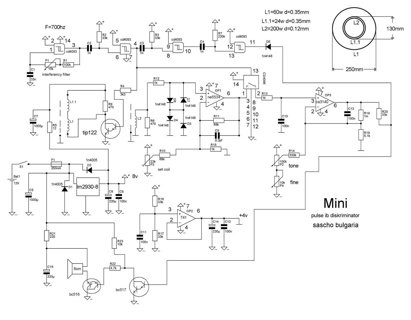

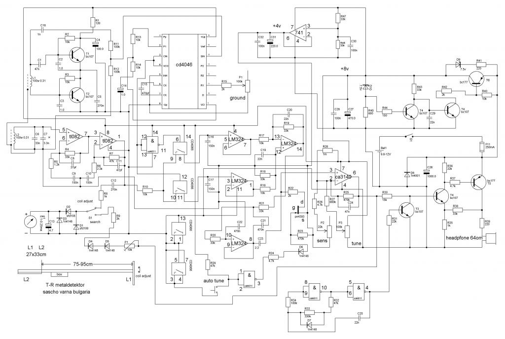

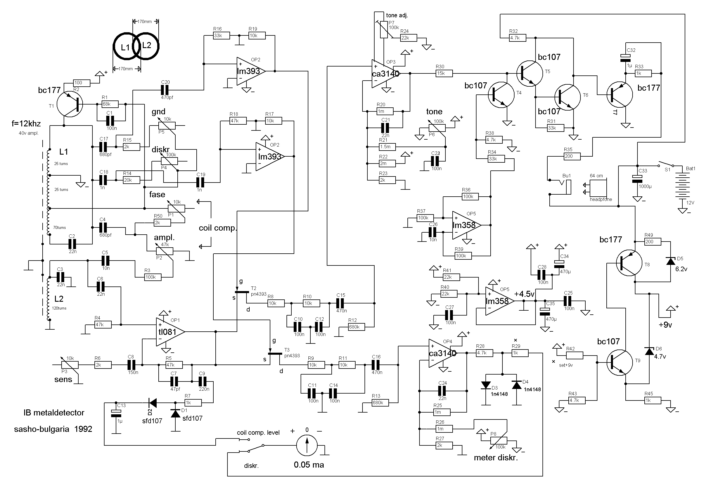

      Here are 3 Schematics , all different from Saho-Varna Bulgaria. The image-host of his schematics on Geotech is not working !!The Little red X is where a previous image was posted and or somebody Deleted the Valuable Schematics.!!!!

          Thank-You Sascho. Looks Great !!!!!!

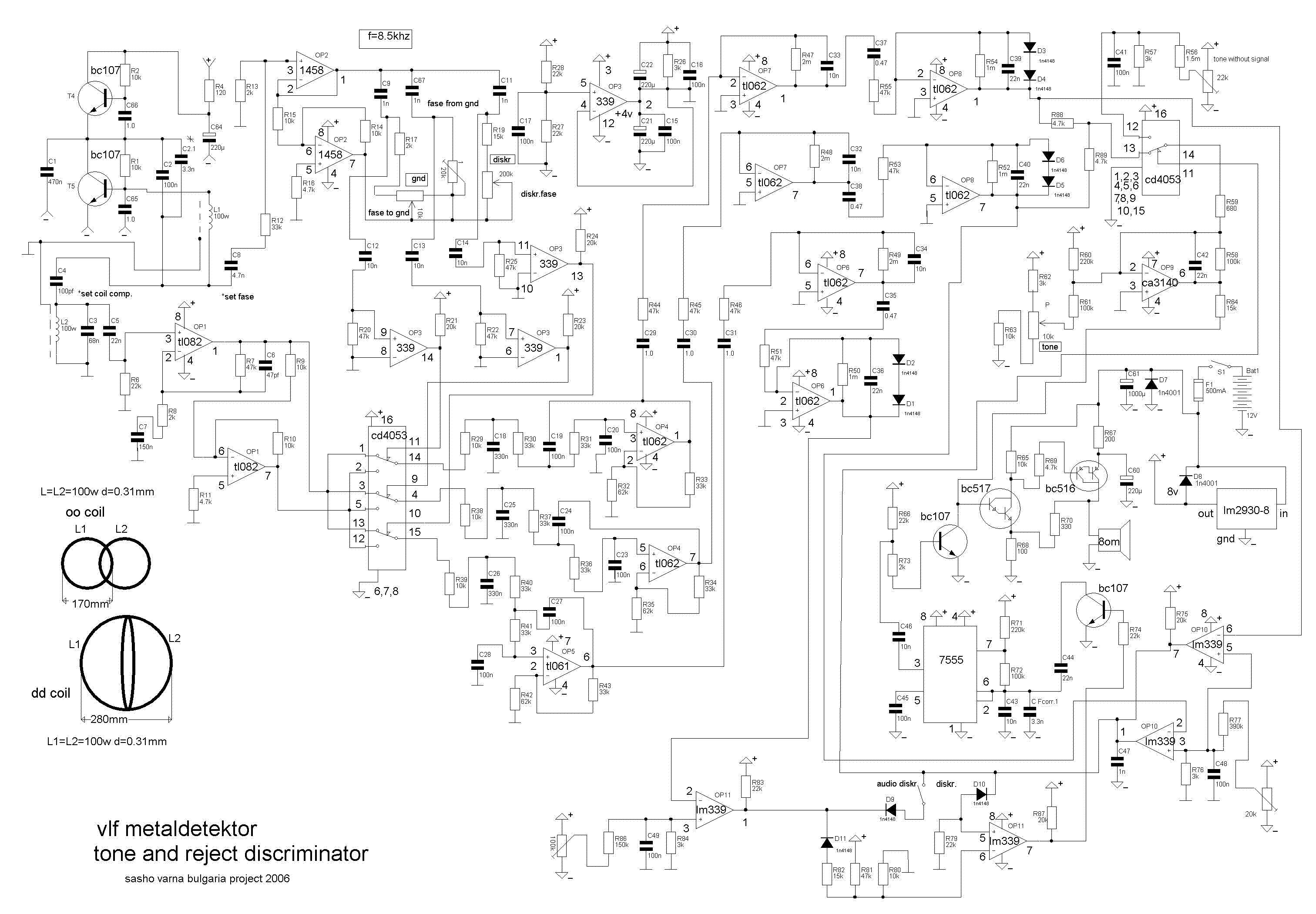

              My very old schematic.Only good quality schematic:

                Hi i want to built this detector i am watching the diagram and i have some questions..
                1. on the top there are a ic 741. Is this the nname of the integrated circuit?
                2. on the p1 what does mean the symbol ?
                3. the d9 is a diode?
                4. dou you have pictures of you metal detector??
                Sorry for my bad english, and thanks... this site is great.... i was looking for something similar a long time ago.....
