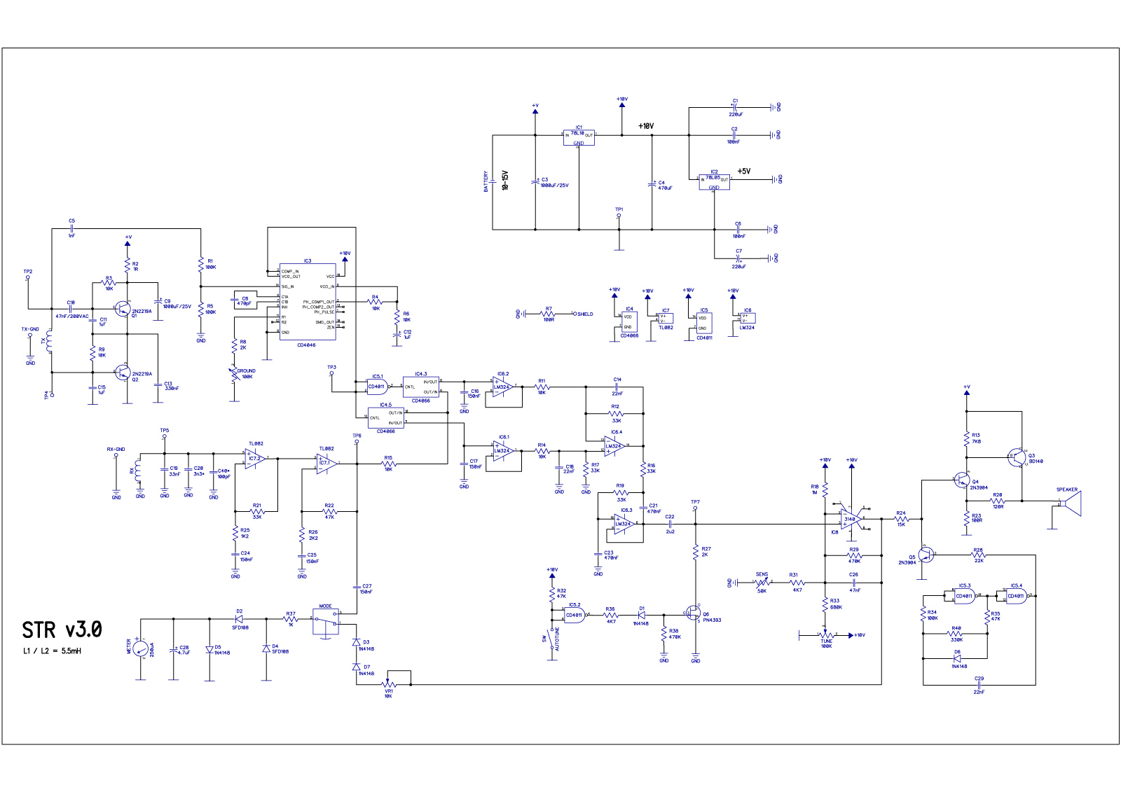

      Sasho's TR schematic drawn by me, with some modifications

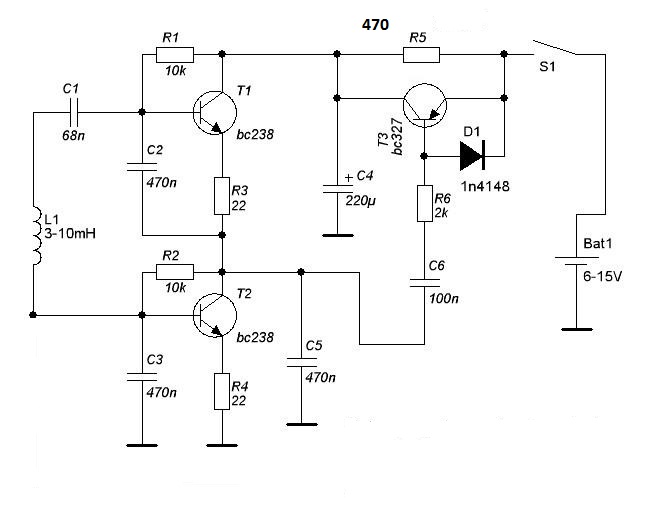

                  I did test some part of the schematic, which worked fine. I noticed that if you don't connect the TX coil and you turn it on - the 2 TX transistors overheat (kind of a design drawback), so you need to make sure you have TX coil connected at all times.

                    Good option oscillator. Not heated without coil.Click image for larger version

                          Here is the schematic in it's latest version. Includes the proposal made by Sasho for the TX oscillator - it will not overheat the transistors if the TX coil is not connected.
                          v2.1.pdf

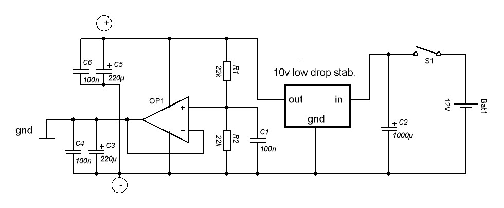

                            Power supply with no problem.PClick image for larger version

                              Yes that will work nice (instead of the TLE there in my revision).
                              However I think that it can be improved (see capacitor connection C6/C5 change).
                              • #60
                                Connecting the capacitors depends on the protection of the amplifier output.AC ground is minus with C1.
